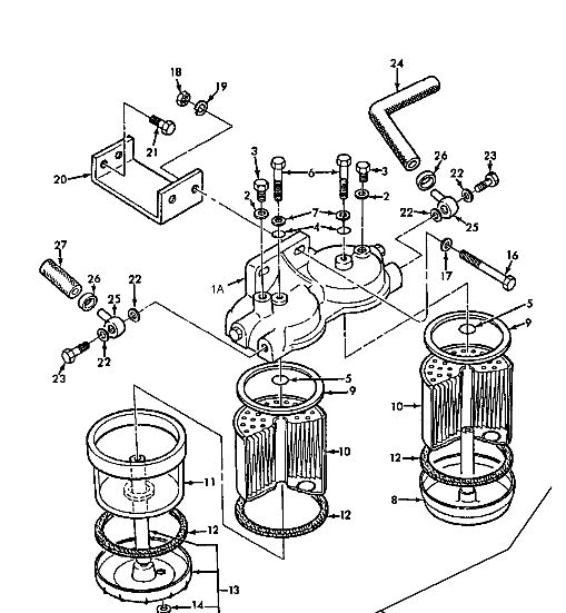

Does your tractor have this dual filter setup? If so loosen the bleed screws(parts key #3) until any air has escaped.

If you do bleed the fuel system be careful not to lose any copper washers that are under some bolts. I had a 1900, which is likely the same and I almost lost one. Before you get too complicated, make sure the fuel shutoff is open if you have one. Mine was at the bottom of the tank underneath. Also, make sure fuel is flowing from the tank.
Best info on bleeding the fuel system is in the owner's manual. I can't remember.

You need a book for your particular tractor but I will give you the basics.
1. fuel cock on, 2. there should be a vent on the filter to purge the air, 3. there will be a vent on the injector pump to purge the air, 4. once you have fuel to the injector pump with no air bubbles, loosen the lines at the injector and spin the engine until fuel leaks, 5. tighten the lines at the injector and start the engine.
