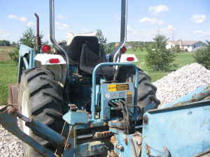

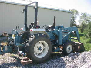

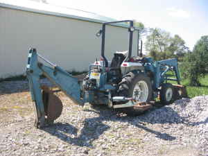

I have a few pictures of the tractor. I'm unsure as to the model of the backhoe attachment, I've yet to get the owner to schedule a time for me to meet him to look the tractor over.

I tried to look at the pictures closely. I took them and blew them up. The one thing I noticed is that neither the backhoe or loader appear to be marked with brand and model number. I'm not sure what they are. The machine may have been repainted as the paint apears to be faded considerably more than my 2120 which has spent 20 years outsides.

The loader looks to be an older ford loader.. though I can't place the model #.

The backhoe looks like a Bradco 9HD or smaller. I have a Bradco 11HD, which looks very close to what that one looks like besides size.
