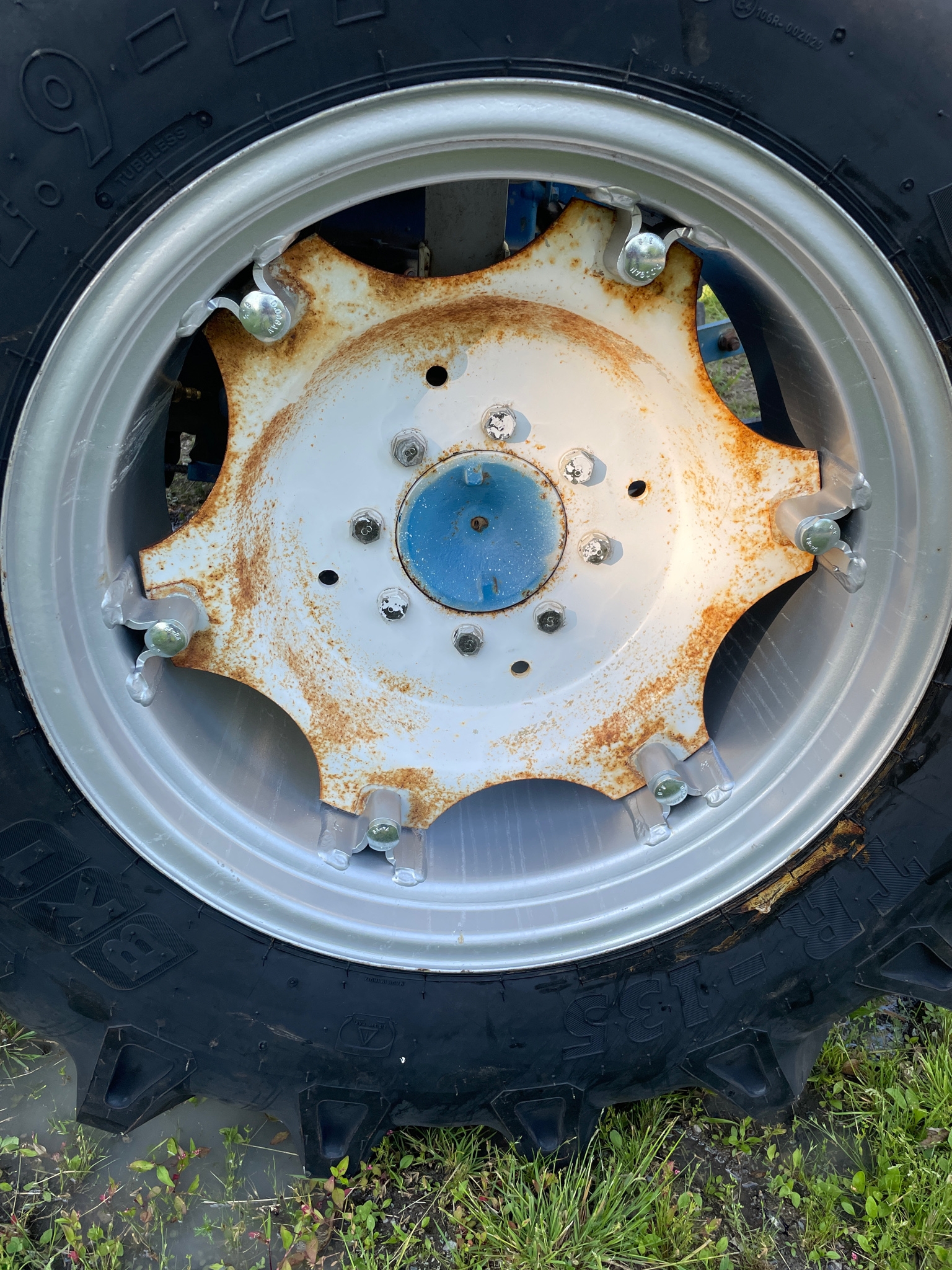

I need new rear rims on my 1993 Ford 1920, I know you cannot find the original size rims. So the only ones you can find are 12”-24” six loops. I see some bolt center to center dimensions 20” and 20.25”. When I measure mine it is 20”’s center to center. Will rims like this work. Thanks.

It is 4 wd with R-1 tires. The original rims are I believe 13” by 24”. There are a few members here who have purchased replacements. I was hoping one would chime in, where they purchased theirs.
   / Ford 1920 rear rims.
Here is what I bought. They fit perfectly. Had to buy new bolts and nuts.
I have to repaint the inner rim and adjust how wide I want them. I did not fill them yet. I have a couple of things to do before they get filled up.

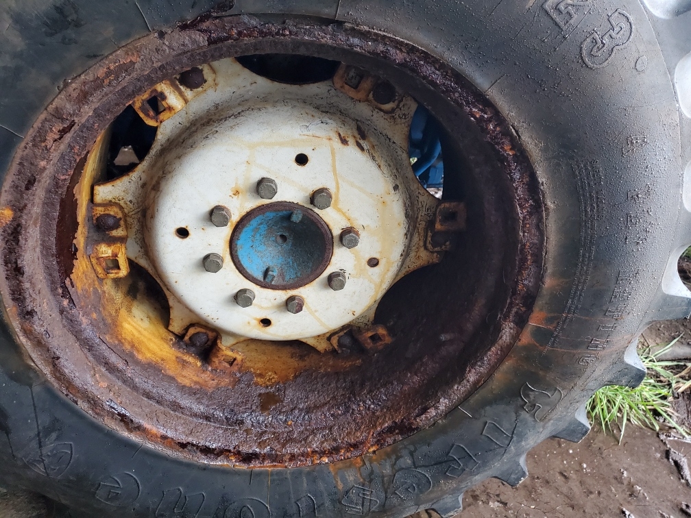

I'm going through the same thing you did in Sept 2022, I'm not sure if this thread is too old, I don't post much. I have a 1998 NH 1920 with rusted rear rims and the same inner disk (flipped the other direction with s-type lugs). Great picture you posted and I'm wondering how much clearance you have from the tire to the tractor frame.

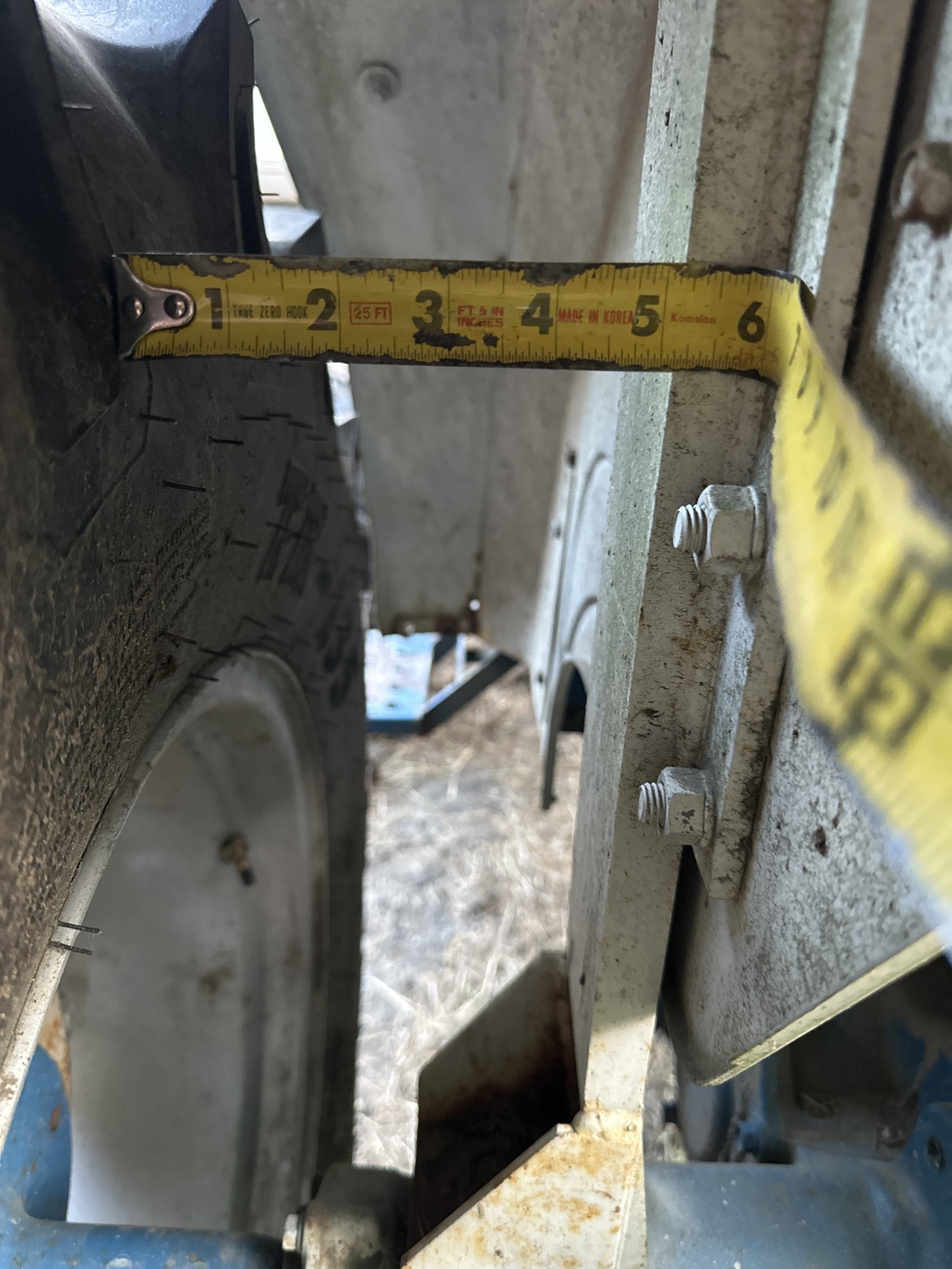

The way it is mounted in my pics. The tire is about 5 inches from hitting anything.
. If I flipped the inner rim. I measure that a little less than 2.5 inches or so. So at its narrowest setting it the tire would be about 1/2 inch or so
from the closest part of the tractor.
This is a better measurement. It’s is a little over 5 inches away.
