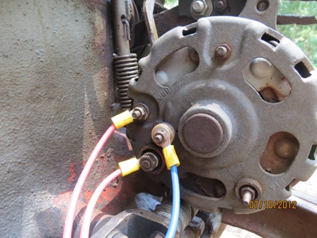

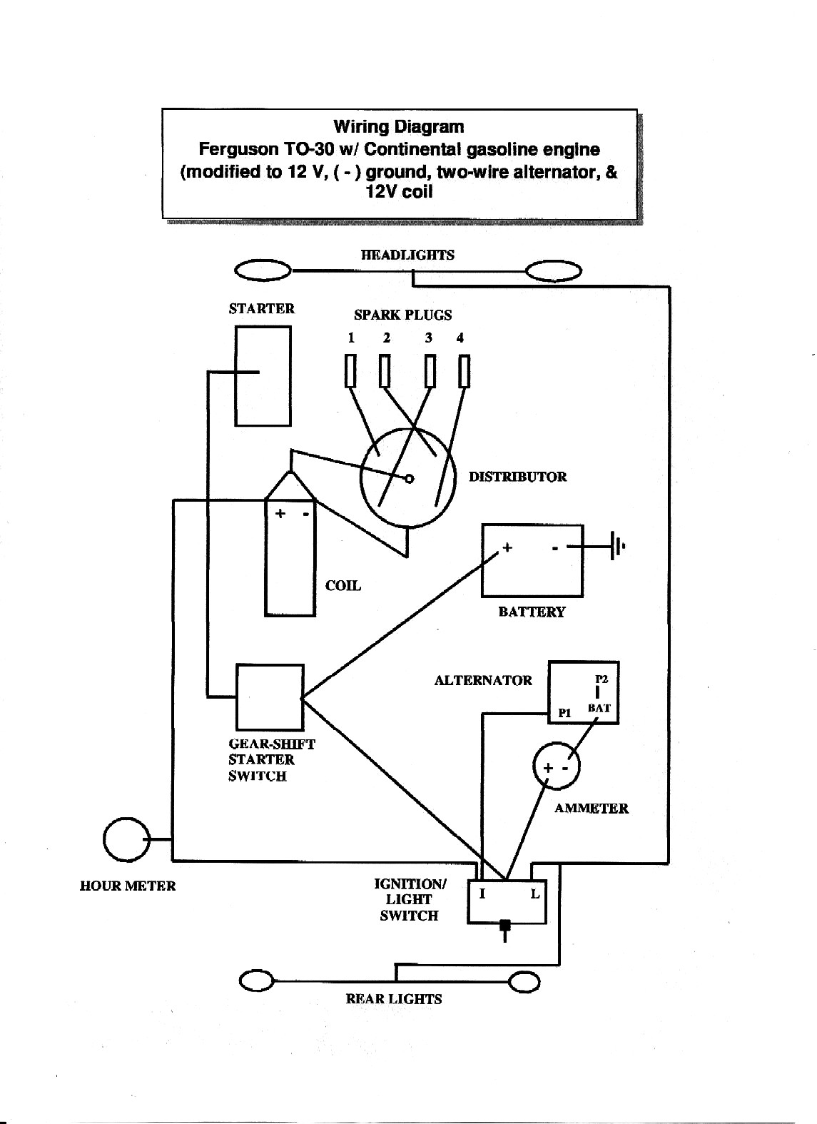

I'm making a wiring harness for an already 12v converted Ferguson TO30 Z129 using a ford 1g alternator. I've read a lot about the delco 10si alternators on here and have seen the wiring diagrams using them. Pretty simple, my concern is the delco and the ford 1g both have a BAT post, however the delco has the P1 and P2 posts...while the Ford 1g has a FLD and GRD posts.
I've been informed I'm to wire my alternator as follows...BAT wired to positive battery terminal on positive battery post...FLD wired through my Voltage regulator(Echlin VR32..has two posts FLD & IGN)and out to my "B" key ignition switch and my GRD grounded at my voltage regulator.
I'm under the opinion the data I'm getting doesn't take the existence of my dash ammeter into consideration, and therefore I can wire my Alternator BAT post to my negative ammeter(discharge) run my positive ammeter(charge) to the "B" post on my key ignition and run a wire from there("B") to the gear shift starter switch. Meaning my FLD alternator post would now run to my "I" key ignition switch. TO30 2 wire Alternator 12v coil.jpgTO30 Alternator.jpg Does this sound accurate?

I'm under the opinion the data I'm getting doesn't take the existence of my dash ammeter into consideration, and therefore I can wire my Alternator BAT post to my negative ammeter(discharge) run my positive ammeter(charge) to the "B" post on my key ignition and run a wire from there("B") to the gear shift starter switch. Meaning my FLD alternator post would now run to my "I" key ignition switch. View attachment 273553View attachment 273554 Does this sound accurate?
if you want a net charge / discharge reading center 0 ammeter, wire as follows.
bat wire from alt to one side of ammeter.
other side of ammeter to battery hot ( solenoid.. whatever.. )
wire all loads like key switch, lamps, etc, off the same side of the ammeter as the alternator.
this will give you true net charge / discharge.
if the needle swings the wrong way.. swap the wires side to side.
