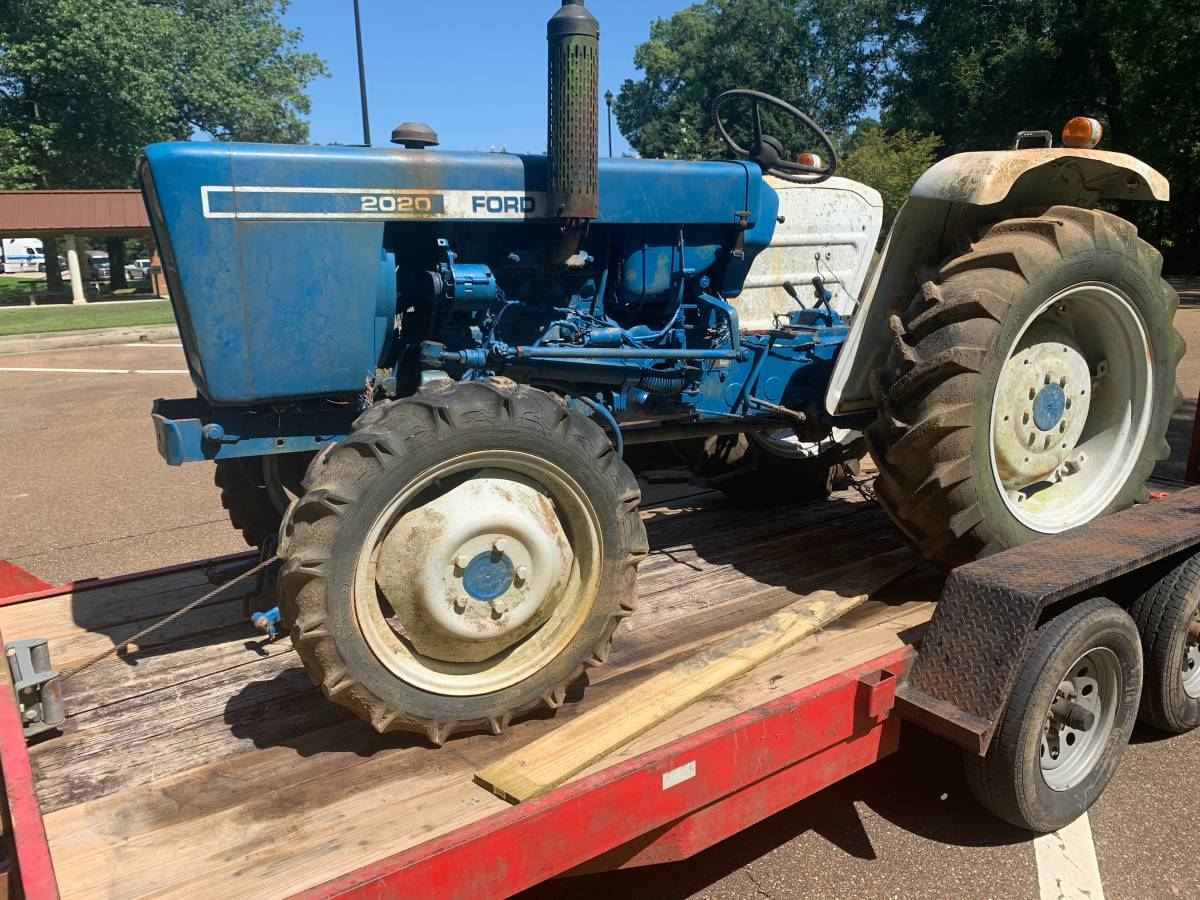

This tractor showed up on local Craig's list for $1,500.
"Tractor for parts Diesel engine tractor could be fixed engine is still free give me a call."

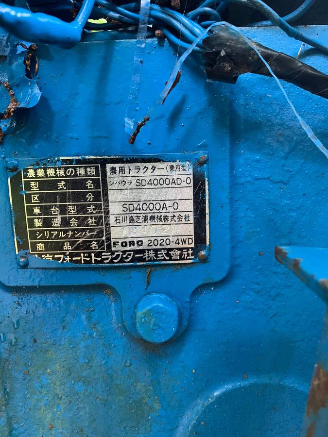

A little web searching shows the engine as a Shibaura LEP854A, which appears to be unavailable. Money pit?

Oddly, I have the manualS in PDF for the LEP854A engines. :) See attached.
The Ford 2110 has the same exact engine as the SD4000AD. So that's a huge plus.
And the engine has a TURBO.
All States has engine blocks.
https://www.tractorpartsasap.com/engines-for-sale/shibaura-engines.html
If you really want a tractor tha would have parts and even newer generations that typically can be drop ins, try a Yanmar.

Do you have a link to English???
Oh my, the link is now dead. The PDF would of opened up and displayed the file in English.
The manual was posted in the FORD section on tractorfourm.com in the past few months too. This way, you don't need the link. Just loging over there and find the Ford section and the threads of those models matching.
