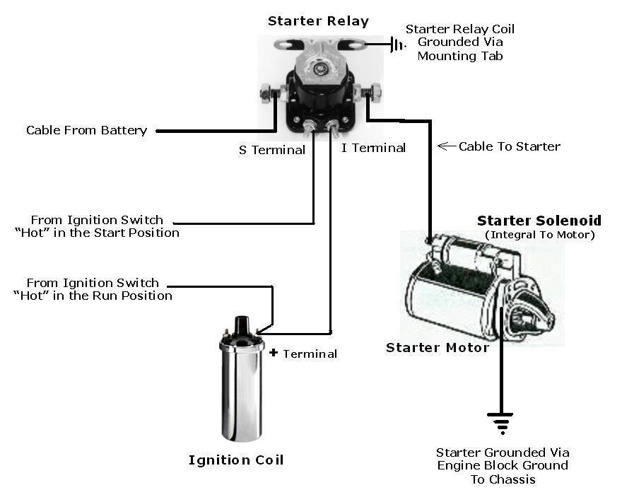

Starter solenoid appears to be good because it would start without issue if i cross the points together on the solenoid, just wont try to start if i use the key.
Tomorrow i plan to fixed the wire the rats have been chewing on, and try putting a jumpter in the wires going to the neutral safty lockout, to eliminate that.

So bypassing the neutral worked, this will get me by for a bit, but now i still need to figure out whats going on with the lights.
Can't be in 2 places at once, need 12v buzzer or light, the Switch terminal will have 12v when key is in start position. If not back track to switch or replace wire. Ignition coils do not run on 12v. The Ignition terminal sends battery voltage to coil for hotter spark during cranking
