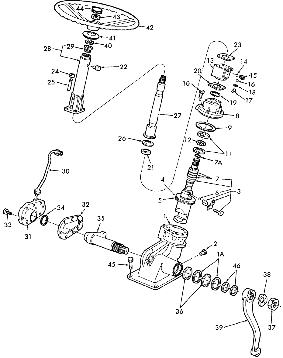

I need to have a steering box rebuilt for a Ford 2810, wheres a good place to have this done and any ballpark figure of how much this will cost.
   / Ford 2810 steering box rebuild #2
by and far.. ford steering boxes aren't too awefull hard to rebuild... especially the mechanical section.. just finished a box on an old 2000 last weekend. looks a lil different.. but the concept and parts are -basically- the same .
cnh carries parts.
here's a listing and diagram.
1 E0NN3N503CE STEERING BOX Gear Assy., W/Cab, Includes: Ref. 1 thru 31, NH-E Only., Years: 12/01/1985-02/28/1990
1 E0NN3N503FE STEERING COLUMN Gear Assy., L/Cab, Includes: Ref. 1 thru 31, Years: 12/01/1985-02/28/1990
1 1 E0NN3548BB SUMP Housing Assy., Includes: Bushings, Years: 12/01/1985-02/28/1990
2 NSS NOT SERVICED SEPARATELY Bushings, Included in Housing Assy., not shown, Years: 12/01/1985-02/28/1990
1A 2 C9NN3R657A SLEEVE Sleeve, Steering Gear Shaft Extension, Years: 12/01/1985-02/28/1990
2 1 E5NN3R661AA GUIDE Guide, Years: 12/01/1985-02/28/1990
3 1 E0NN3A710AC NUT Nut & Shaft Assy., Includes: Ref. 4 thru 7A, Years: 12/01/1985-02/28/1990
4 1 E5NN3R817AA O-RING Seal, Years: 12/01/1985-02/28/1990
5 1 E5NN3B541AA RING Ring, Sealing, Years: 12/01/1985-02/28/1990
6 28 C9NN3647A BALL BEARING Ball, 5/16" Dia., Years: 12/01/1985-02/28/1990
7 3 E0NN3A590AA SEAL Seal, Power Steering Valve, 45mm (1.77") OD, Years: 12/01/1985-02/28/1990
7A 1 D6NN3N812A O-RING O-Ring, Years: 12/01/1985-02/28/1990
8 1 D8NN3C737BA ADAPTER Adapter, Years: 12/01/1985-02/28/1990
9 1 C9NN3747A SEAL Seal, Adapter, Included in Kit P/N EGPN3N503AA(83957121)., Years: 12/01/1985-02/28/1990
10 7 E0NN3R673AA BOLT Bolt, Years: 12/01/1985-02/28/1990
11 2 C9NN3E612A BEARING Bearing, Years: 12/01/1985-02/28/1990
12 15 C9NN3647A BALL BEARING Ball, 5/16" Dia., Years: 12/01/1985-02/28/1990
13 1 E0NN3C516AC HOUSING Housing Assy., Years: 12/01/1985-02/28/1990
14 1 9617873 O-RING O-Ring, 6-1, 90 Duro, .468" ID x .078" Thk, Years: 12/01/1985-02/28/1990
15 1 76350 HYD CONNECTOR CONNECTOR, HYD., 9/16"-18, 37� x 9/16"-18, O-Ring, Years: 12/01/1985-02/28/1990
16 1 145222 BALL BALL, 3/8", Years: 12/01/1985-02/28/1990
17 1 C9NN3C546A PLUG Plug, Years: 12/01/1985-02/28/1990
18 1 C9NN3R668A SEAL Seal, Years: 12/01/1985-02/28/1990
19 1 C9NN3E614A SEAL Seal, Included in Kit P/N EGPN3N503AA(83957121)., Years: 12/01/1985-02/28/1990
20 AR C9NN3595B SHIM Shim, .005, Years: 12/01/1985-02/28/1990
20 AR C9NN3595C SHIM Shim, .010, Years: 12/01/1985-02/28/1990
20 AR C9NN3595A SHIM .002 thick , Years: 12/01/1985-02/28/1990
21 1 E1NN3N632AA SEAL Seal, Included in Kit P/N EGPN3N503AA(83957121)., Years: 12/01/1985-02/28/1990
22 1 E0NN3N956AA DOWEL Dowel, Years: 12/01/1985-02/28/1990
23 AR C9NN3R665A SHIM Shim, .005, Years: 12/01/1985-02/28/1990
24 4 86509310 NUT Nut, G5, 3/8"-24, Years: 12/01/1985-02/28/1990
25 4 E5NN3R663AA STUD Stud, 3/8"-24 x 4.0, Years: 12/01/1985-02/28/1990
26 1 D8NN3N917AA WASHER Washer, Years: 12/01/1985-02/28/1990
27 1 D8NN3A526AC SHAFT Shaft Assy., L/Cab, Years: 12/01/1985-02/28/1990
27 1 83955779 SHAFT Shaft Assy., W/Cab, NH-E Only., Years: 12/01/1985-02/28/1990
28 1 E0NN3C529EB STEERING COLUMN Column Assy., W/Cab, Includes: Ref. 29, NH-E Only., Years: 12/01/1985-02/28/1990
28 1 E0NN3C529FB STEERING COLUMN Column Assy., L/Cab, Includes: Ref. 29, Years: 12/01/1985-02/28/1990
29 1 D5NN3517A RING Bushing Assy., Years: 12/01/1985-02/28/1990
30 2 E5NN3A536AA TUBE Tube, Start Year: 12/01/1985
31 1 E5NN3N583AB COVER Cover Assy., Start Year: 12/01/1985
32 1 C9NN3N598A GASKET Gasket, Start Year: 12/01/1985
33 8 42997S100 SCREW Screw, Cap, HH, G5, Self-Locking, 3/8"-16 x 7/8", Start Year: 12/01/1985
34 AR C9NN3C629D SHIM Shim, .050, Start Year: 12/01/1985
34 AR C9NN3C629C SHIM Shim, .060, Start Year: 12/01/1985
34 AR C9NN3C629B SHIM Shim, .080, Start Year: 12/01/1985
35 1 E5NN3575AA SHAFT Shaft, Start Year: 12/01/1985
36 2 C9NN3C615A SEAL Seal, Start Year: 12/01/1985
37 1 C7NN3N069A NUT Nut, Start Year: 12/01/1985
38 1 C7NN3N070A ANCHOR Anchor, Start Year: 12/01/1985
39 1 E1NN3590CA ARM Arm, L/Cab, 4610, Start Year: 12/01/1985
40 1 D8NN3N898AA SEAL Seal, Start Year: 12/01/1985
41 1 D2NN3A566B GROMMET Grommet, Start Year: 12/01/1985
42 1 D6NN3600B STEERING WHEEL Wheel Assy., 18", Start Year: 12/01/1985
42 1 D7NN3600A STEERING WHEEL Wheel Assy., 15", Start Year: 12/01/1985
43 1 D5NN3N602A NUT Nut, Start Year: 12/01/1985
44 1 82002600 CAP Cap, Start Year: 12/01/1985
45 4 87670 BOLT Bolt, 1/2"-13 x 1-3/8", Start Year: 12/01/1985
46 2 81803034 SEAL Seal, Start Year: 12/01/1985
