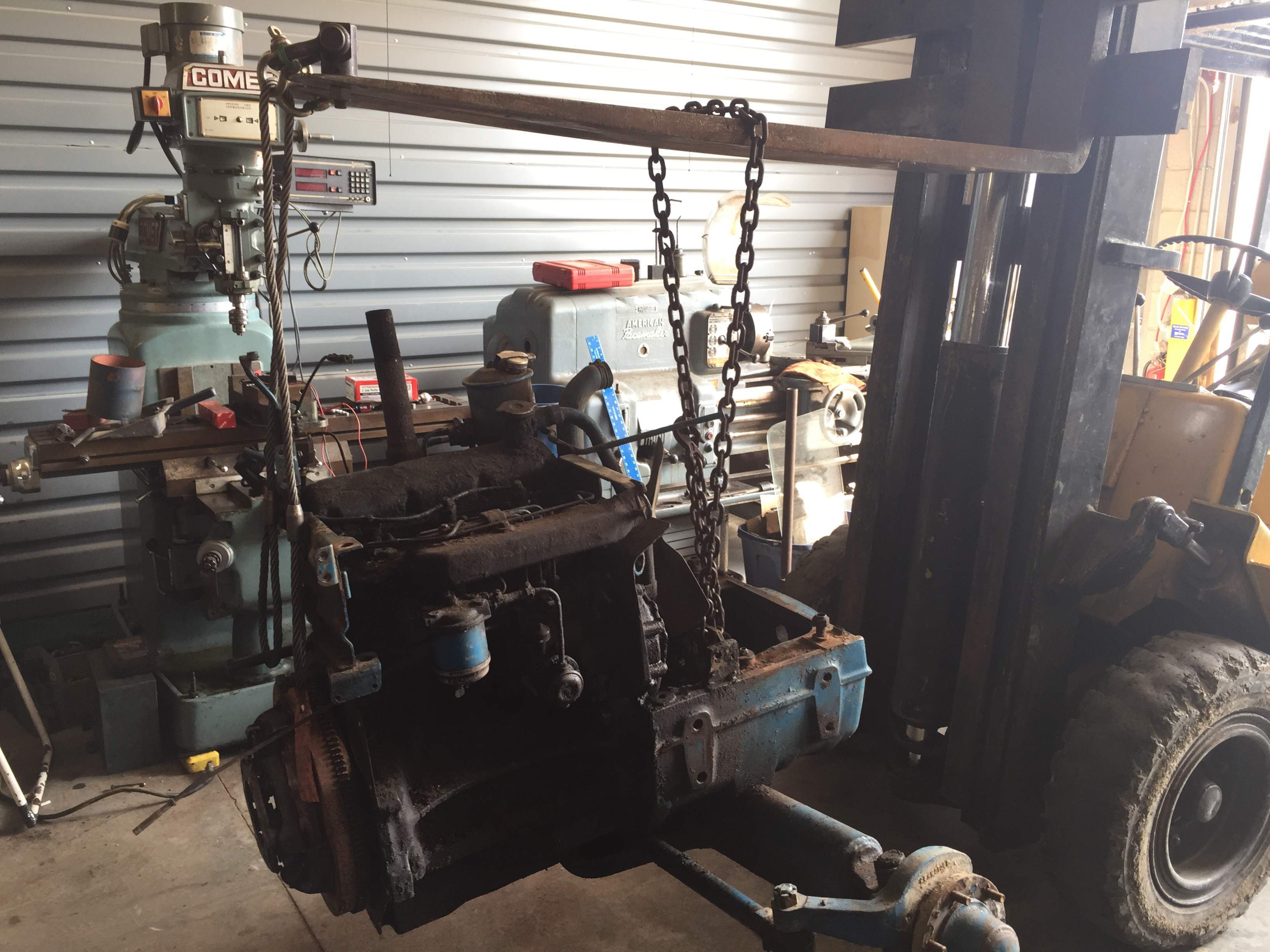

Hi all, the (gas) engine in my 4400 is smoked. I can spin the flywheel with no problem by hand. I was going to rebuild it but now I have a line on a low hr 3500 Diesel engine. Both are 3 cylinder with the same front end. Other than the loss of some HP, does anyone see a problem with the swap? It seems straight forward but it doesn't hurt to ask. Does anyone recommend some additional service to the engine before the install? For the most part, this machine will be only used for loader and back blade work.

All the 3 cyls swap. I would probably keep the flywheel paired to the tranny
   / Ford 3500 Diesel engine in a 4400? #4
But swap out the gas ring gear on the retained flywheel for a diesel ring gear. Add a fuel return fitting to your fuel tank filler neck. Iuld some intake plumbing and modify the battery tray to accept a battery from a Ford 7.3 Power stroke.
   / Ford 3500 Diesel engine in a 4400? #5
But swap out the gas ring gear on the retained flywheel for a diesel ring gear. Add a fuel return fitting to your fuel tank filler neck. Build some intake plumbing and modify the battery tray to accept a battery from a Ford 7.3 Power stroke.
Zombie: that's a good idea but I'm not sure I'll be doing the rod bearings. I'm pretty sure I'll be getting the front end too so I'm just going to swap everything.
Rick: I would've forgot the return fuel line and didn't know I had to modify the intake plumbing and battery tray. I was looking at the ring gear too and for $40, it's being replaced.
Sound guy: I'll keep the flywheel from the 4400, its about 125lbs and 3x bigger than the one on the 3500. I'm hoping the clutch from this 3500 will fit my 3000. He broke the input shaft on the trans, that's the reason hes parting it out.
Thanks guy, You've helped me a lot. I'll come back with pictures and update this thread in a week or so.
   / Ford 3500 Diesel engine in a 4400? #7
yep, i totaly missed he was swapping a diesel from a gasser.
   / Ford 3500 Diesel engine in a 4400? #8
the intake plumbing will just be routing air from the breather.
battery tray is a size issue. many of the diesels used a tray made for a 4dlt.

I went to Toledo for the new engine and front axle yesterday. I ended up getting the nose cone, air box and a bunch of other parts. Everything seems straight forward and I'm expecting the install to go smooth. I'm hoping to fire it up sometime in the next couple weeks.
