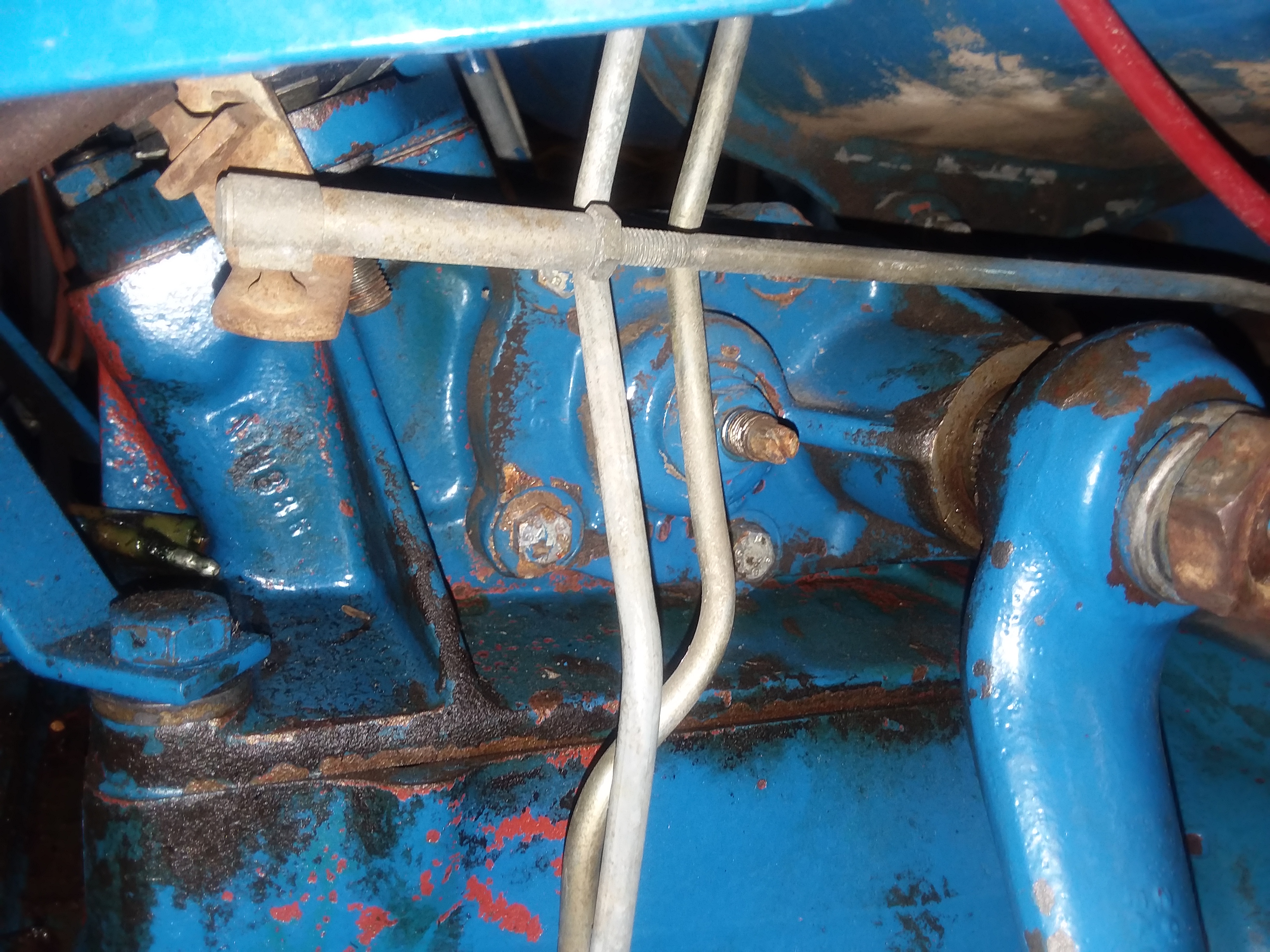

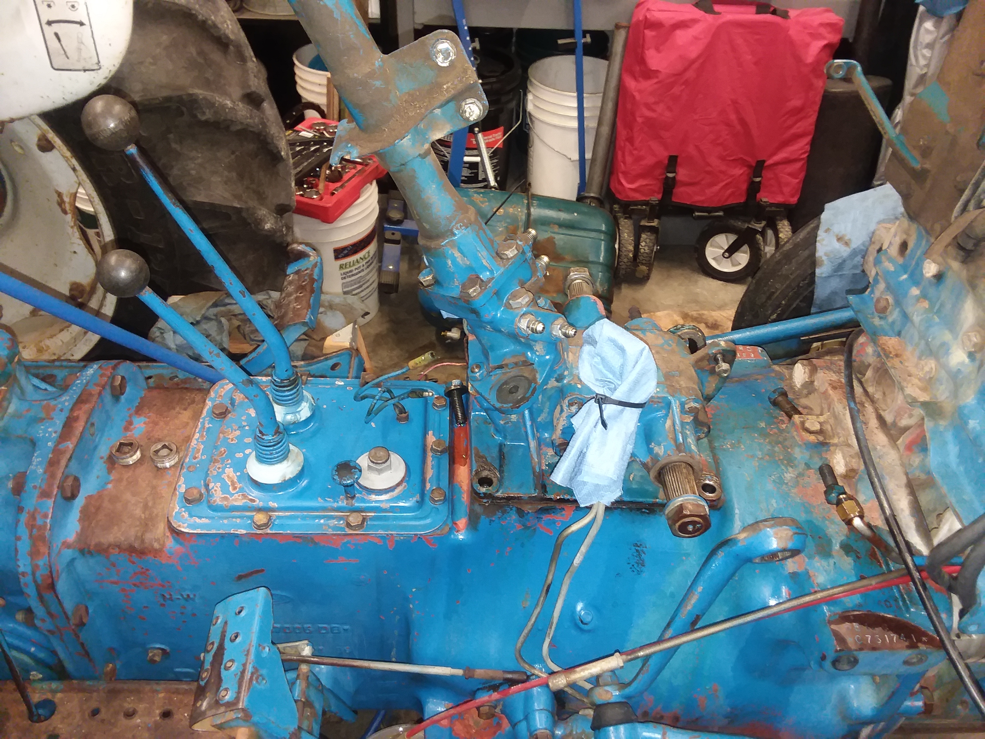

1986 Ford 3910

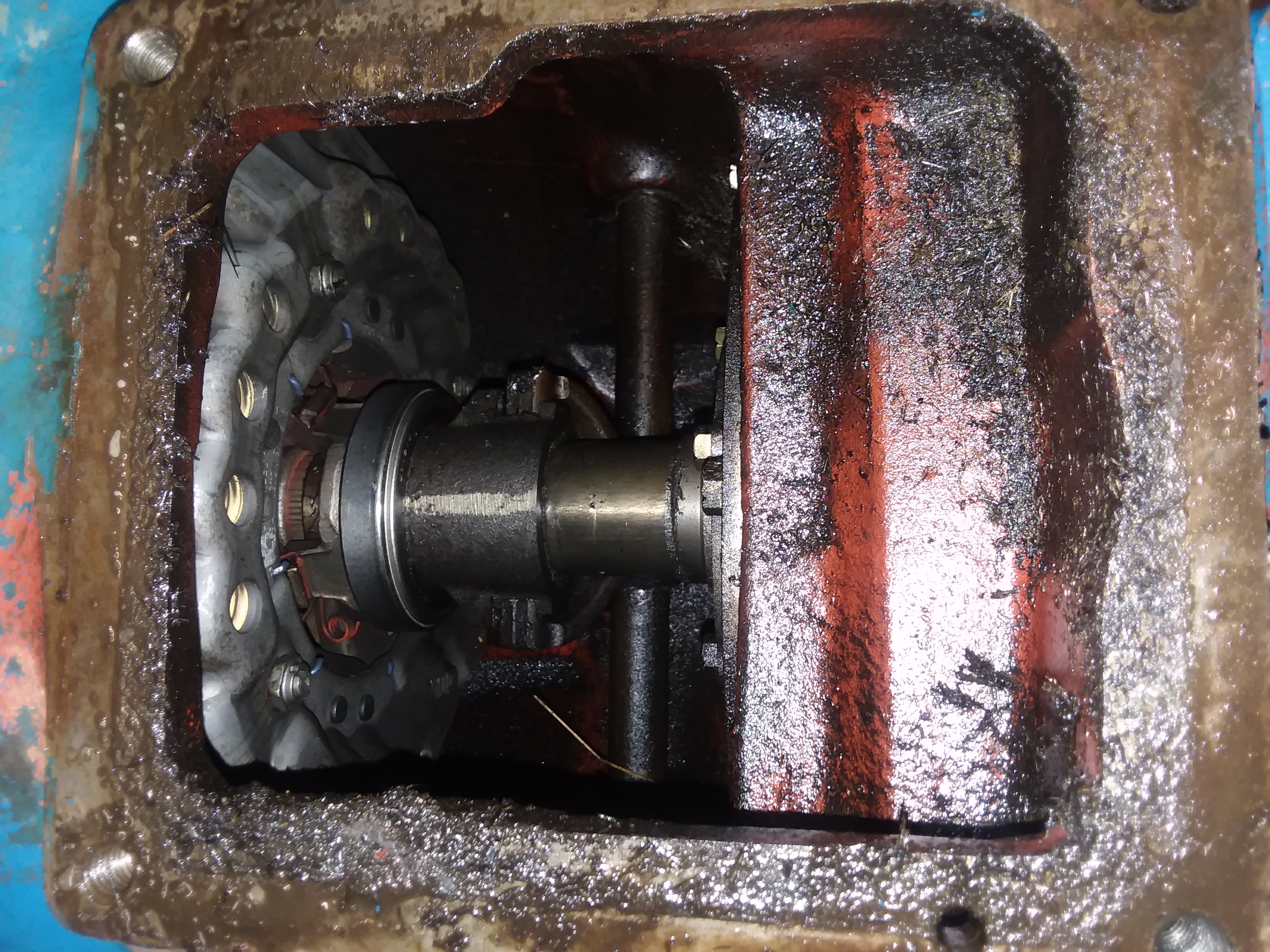

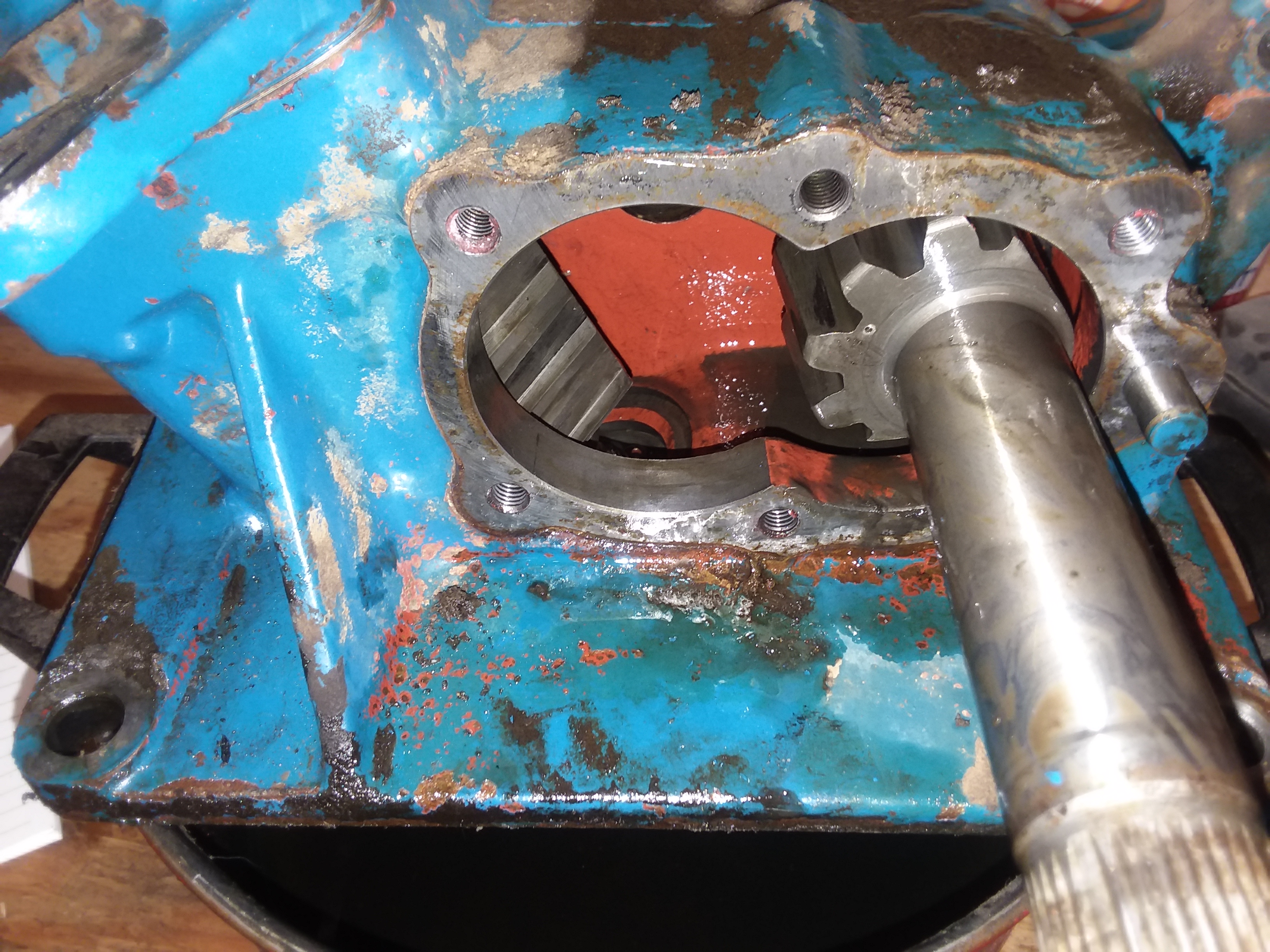

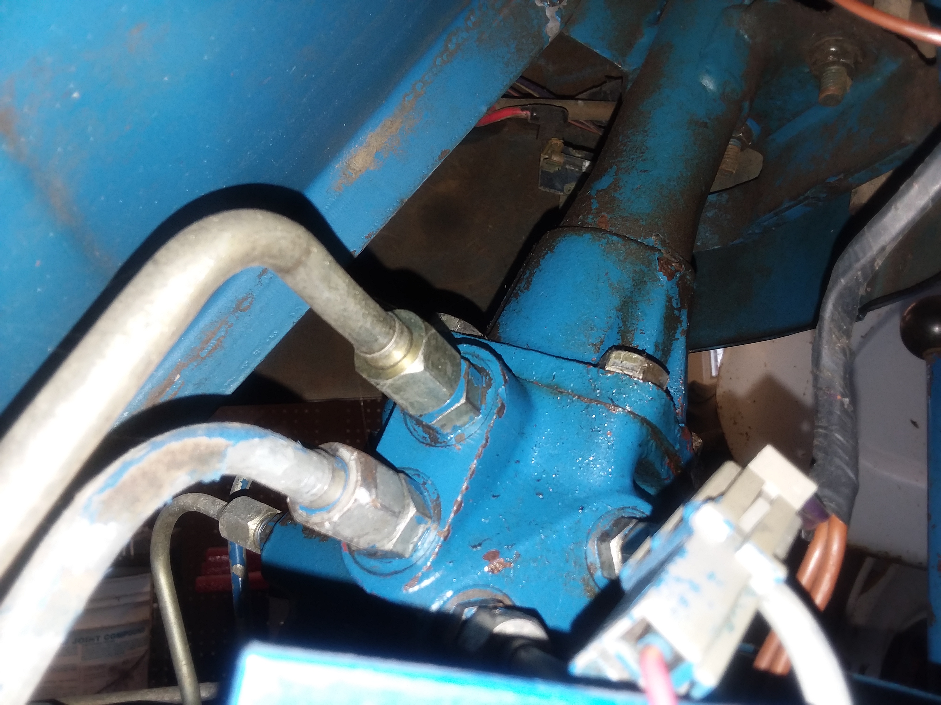

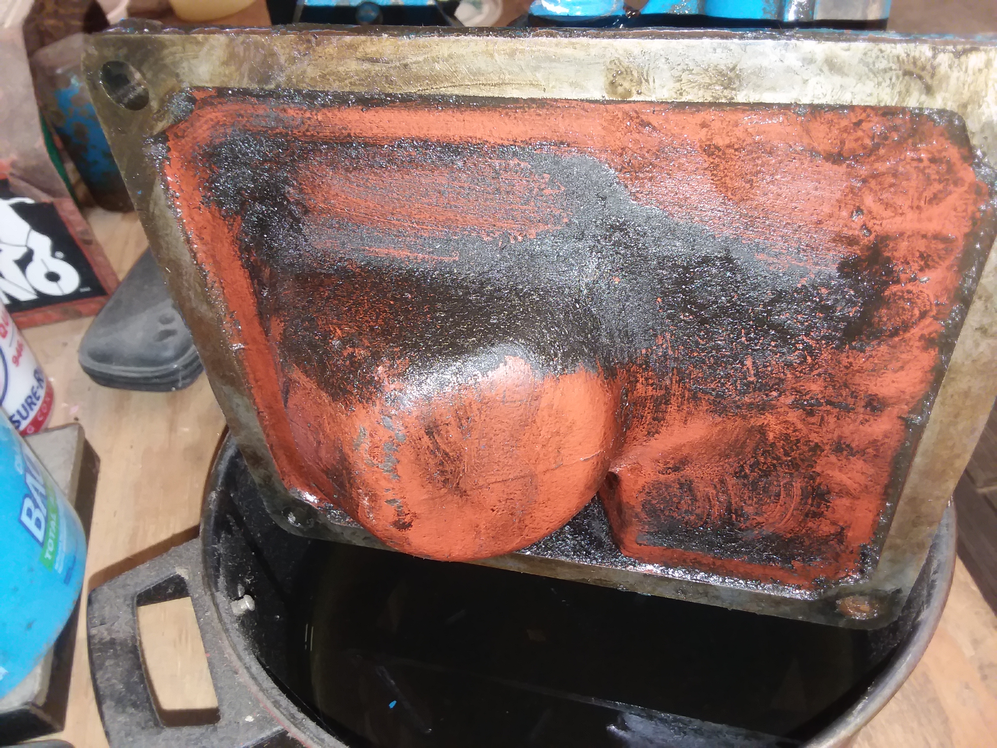

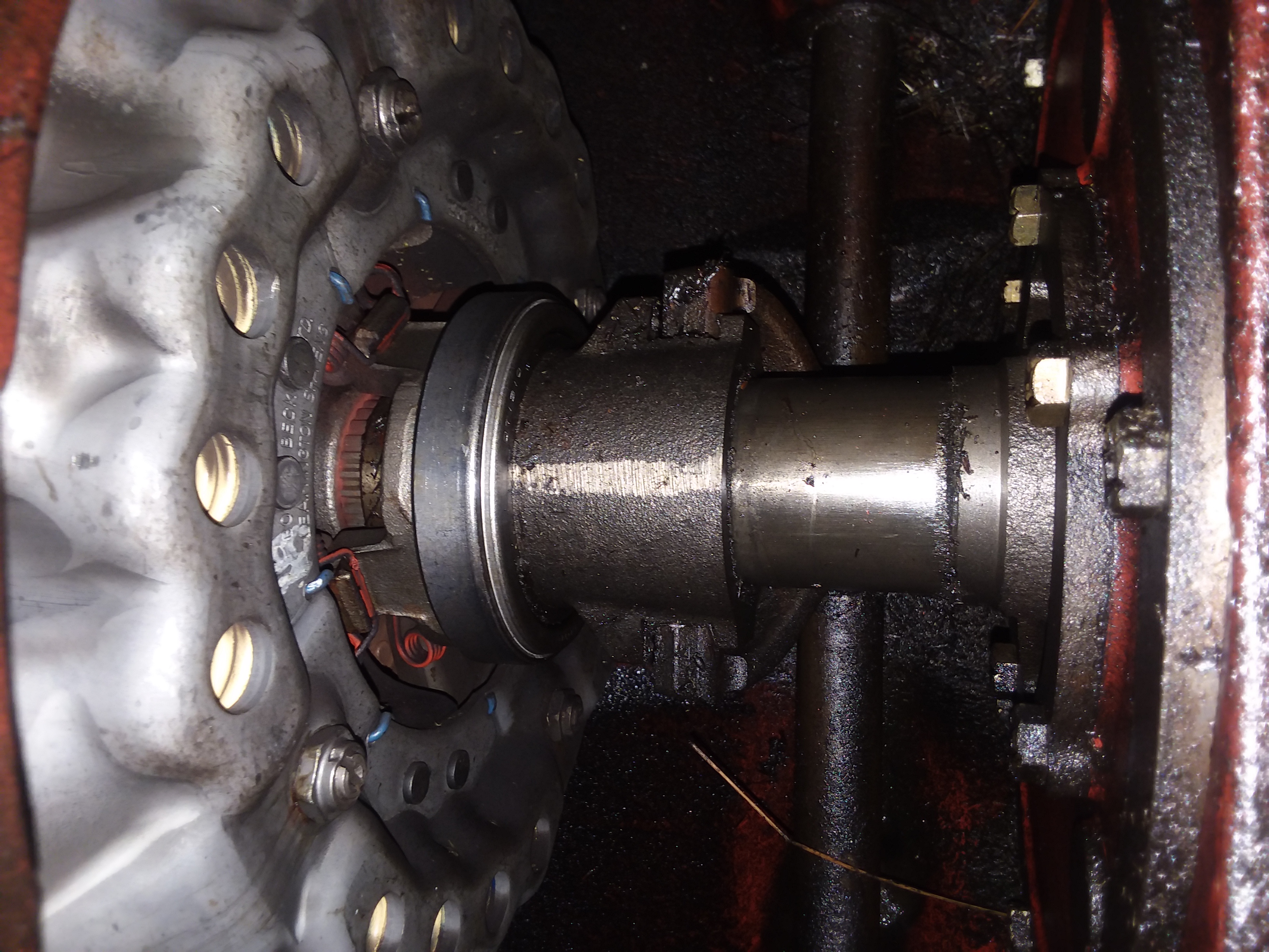

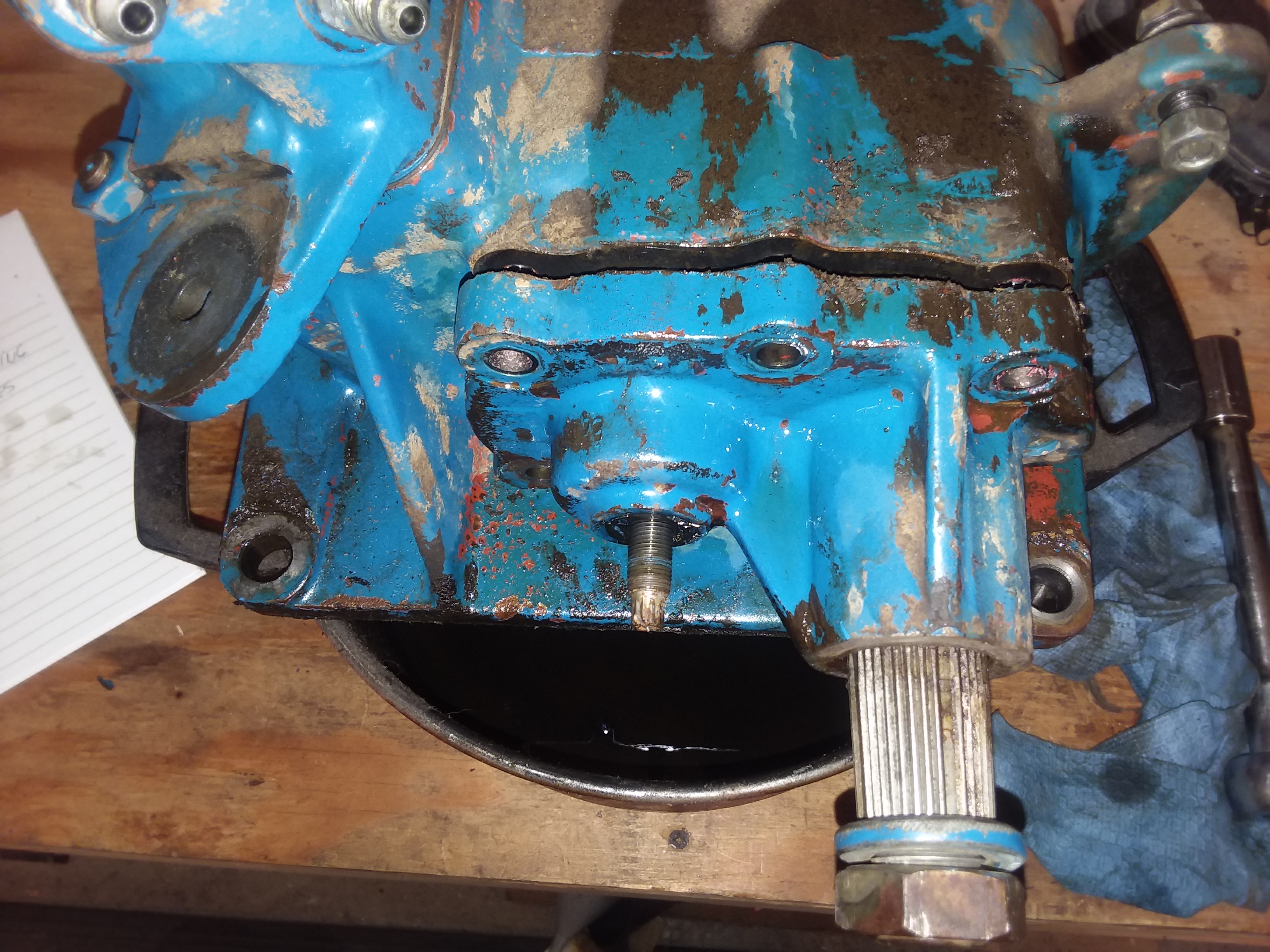

I purchased a 1986 Ford 3910 diesel about a year ago to replace my 1971 Massey Ferguson 135 gasser. Overall, I'm very happy with the tractor but I've got some pesky leaks I'm going to start fixing. The first one I plan on tackling is the power steering column leak. It seems I need to replace the seals in the column. Also, the o-ring seals on the pitman arms are leaking as well. I removed the steering box from the tractor, after removing the dash cover and fuel tank. As you will see from some of the pics, how does all this trash get in the clutch housing. Also, once I'm done fixing all the seals, is the fluid in the steering box separate from the fluid in the power steering system? I've read a lot of post about using corn head grease in the steering box to prevent leakage/seepage. I got the cover off the box and called it a night so it could drain. Plan on hitting it hard again when I get off today.

I have the same issue of power steering fluid leaking from the top of the steering column on my 1995 Ford/New Holland 1720. I pulled apart the steering shaft and assembly and it looks like the spacer(s), rubber ring/seal, and bearing all have some wear and I will replace those.
However, is it correct that the steering column is SUPPOSED to have power steering fluid in it during normal operation? Or, do I only have fluid in the column because a seal is failing below the shaft (i.e., in the steering control valve) and allowing the flow into the shaft?
