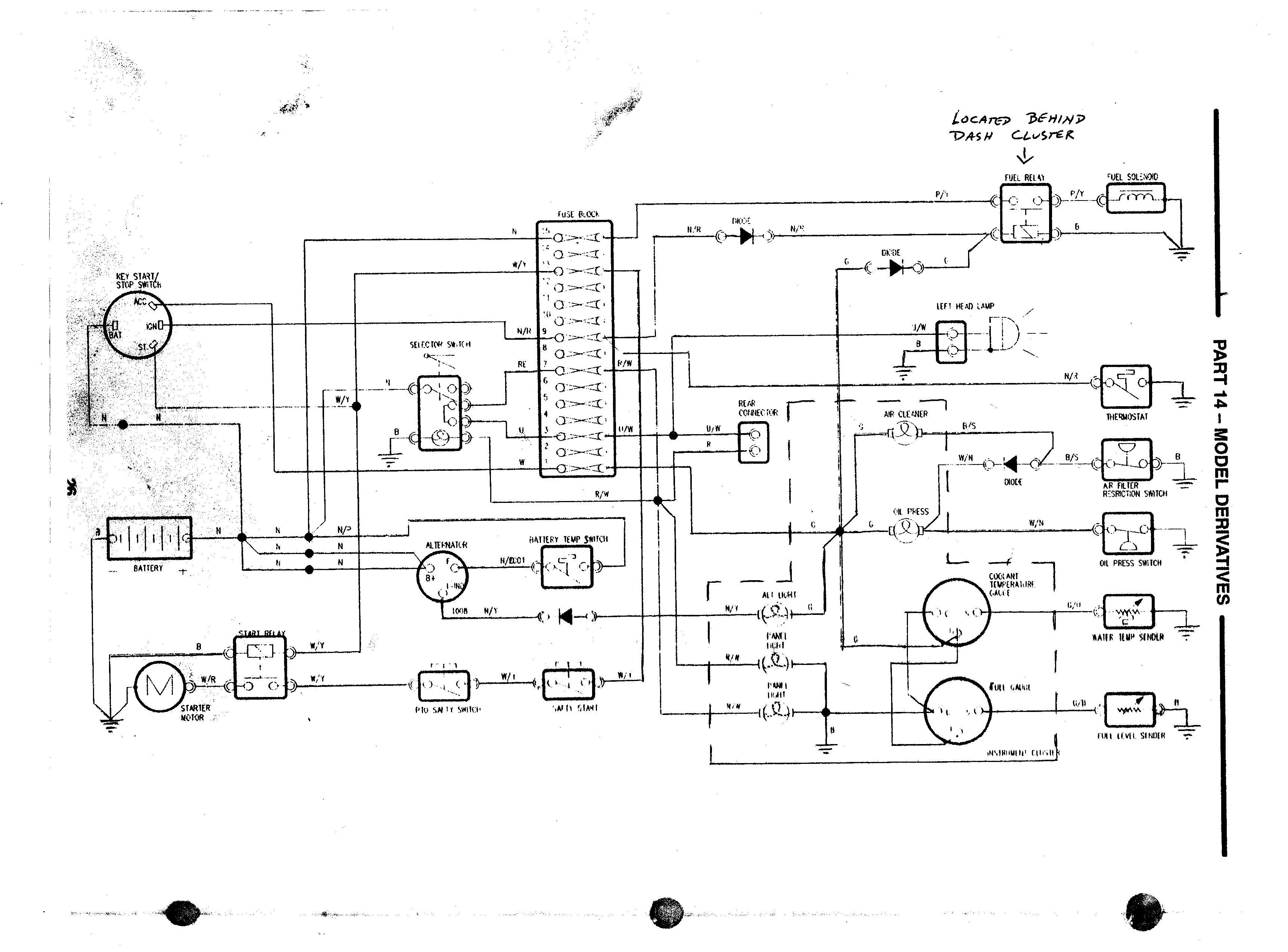

Does anyone have a Ford 3910 wiring diagram? Recently picked up a state owned unit and they replaced the headlights with blinking caution lights. Want to convert it back to headlights that wont blink. Nice safety feature, I guess, but where I use it there is no one there to see the blinking lights except me. Also, if anyone could recommend a good maintenance manual, that would be appreciated too.

In your case those lights probably have a flash unit built into them or a flasher unit in the circuitry. I haven't found a good wiring diagram yet but the whole thing is pretty simple to follow. When I added lights to mine I just ran wire and placed lights where I wanted them and didn't use any factory wiring on the tractor.

This is a crappy one. Hopefully you can read enough to help.

Sorry, I don't know for sure. Can't remember where I got it. My 3910 is an 84 diesel.
Let me scrounge thru my electronic manuals and see what I find.
   / Ford 3910 Wiring Diagram #10
If your 3910 manual is actually the later and far larger and now more common combined 10 and 30 series manual the posted schematic may be from Part 14 which details the changes to late 30 series tractors which would include the only 3 cylinder blue Fords equipped with an electric fuel shutoff. The 3910 diagrams should be in the electrical section.
