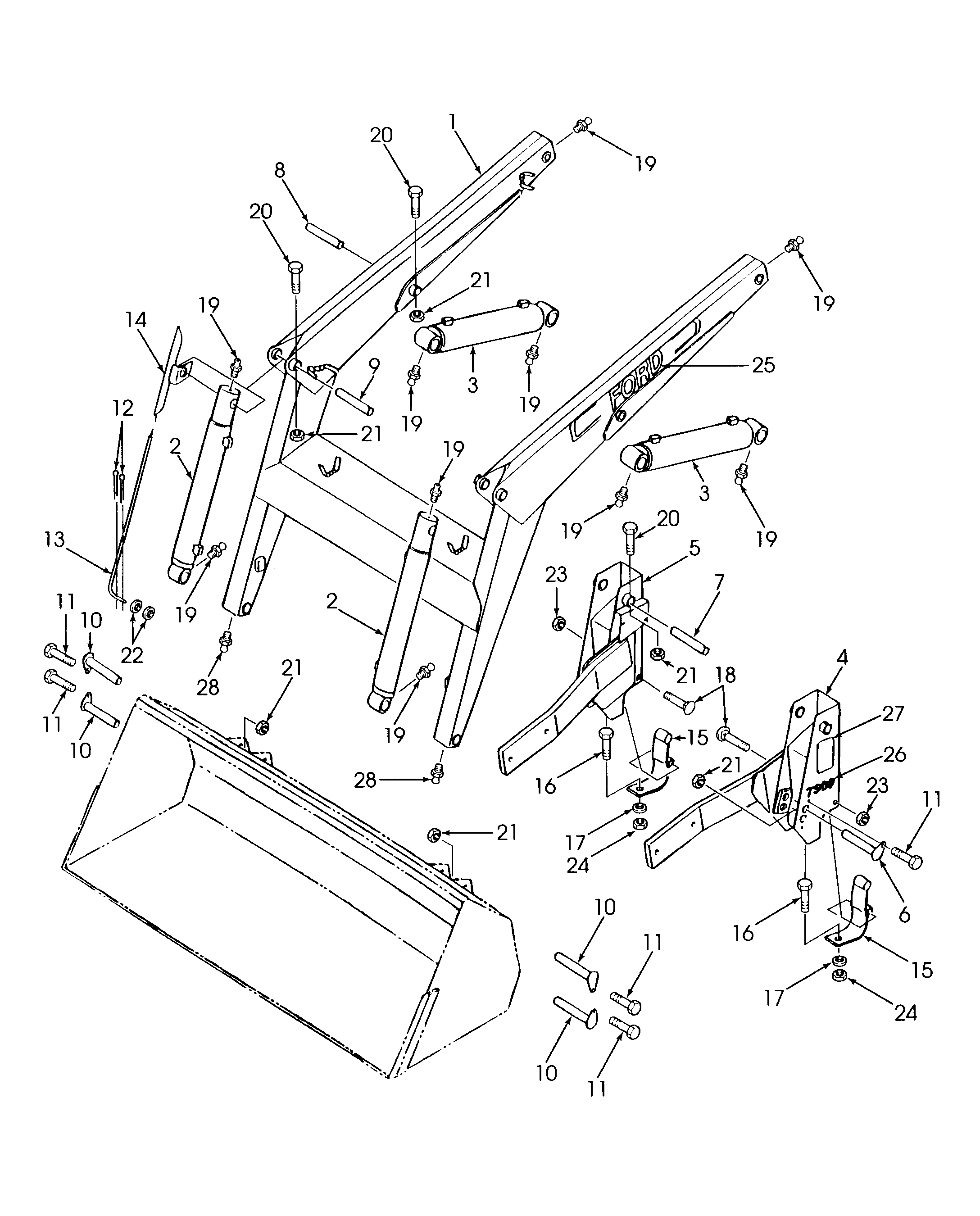

The right side cylinder on my Ford (New Holland) 3930 front end loader (Model 7309) has started leaking.
Should I look for a re-build kit or just buy a new cylinder.
Any video's on how to repair that?

Well, there are kits from New Holland, but they are $175+. You would need to know the cylinder number stamped on the barrel if you want to order from Messicks or any New Holland dealer.
Other options are, take to a local shop and have resealed or take apart and match the seals.

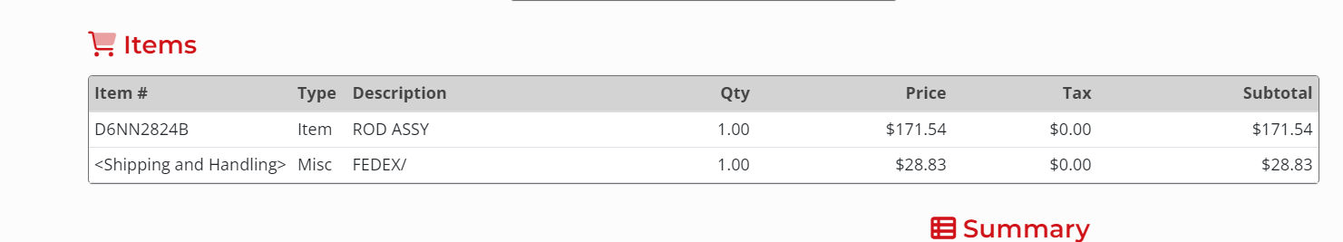

Thank you Tractor Tech. That kit is now $258.00 at Messicks.
However, I was impressed at how quickly the got me a replacement brake release, even though I can't figure out why that should cost more than about $80.00.

IF the rod isnt scored, and the thing isnt bypassing.....just replace the gland seals. Done it many times.
Its easier on most cylinders with a threaded rod end....but most loaders have a welded cross tube so you gotta knock the piston off to pull the rod out of the gland.
But either way, local hydraulic shop....I have never paid more than about $20 for a gland seal. And if the rod isnt scored or has chipped chrome.....no need to replace the expensive rod
However, I was impressed at how quickly the got me a replacement brake release, even though I can't figure out why that should cost more than about $80.00.View attachment 814564
Well, Messicks doesn't set the price and that brake handle/rod and tractor are "Legacy" items. Plenty of old and used parts out there. That is just not a popular part so no aftermarket options.

I always do both cylinders at the same time. Early on I would always just do the one leaking, after about the 6th time of the companion cylinder leaking within a month or two of the first repair, I learned that the fluid just blows out the weaker of the 2. Both cylinders need to be of equal seal strength.

There are 4 cylinders total. Two rotate the bucket and two lift the arms.
Having replaced the rotate the bucket cylinder, the lift the arms cylinder is now leaking.
