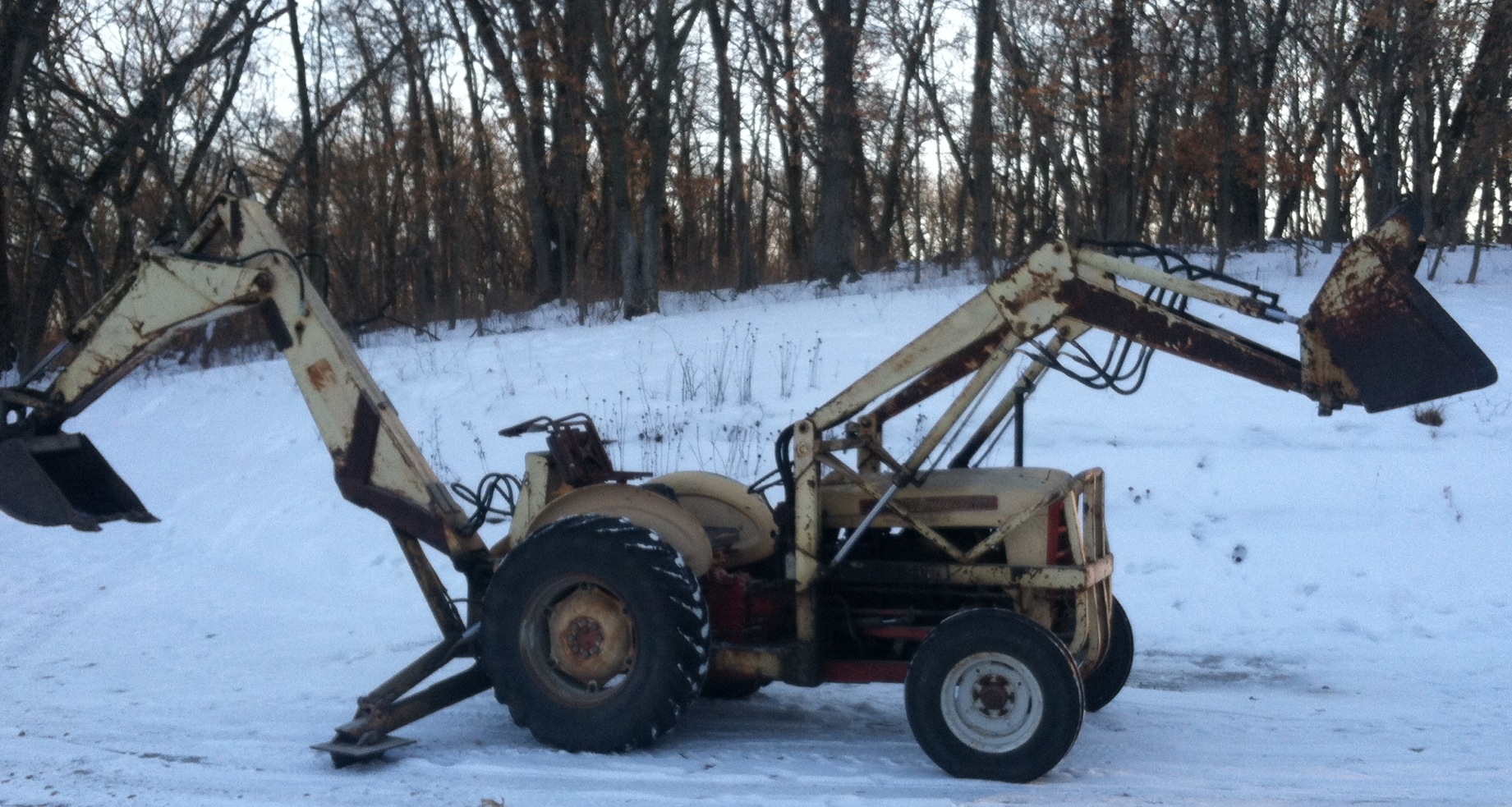

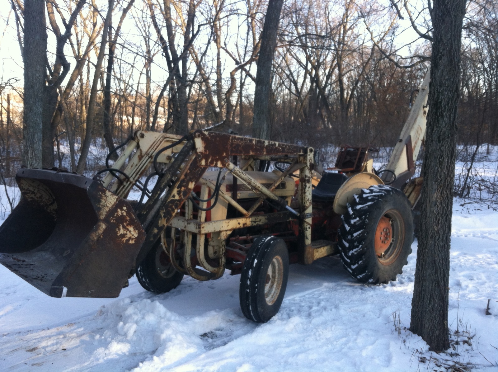

Here are the only two pics that I have thus far. I'll try to find the numbers on the tractor and write them all down. Will those numbers tell me which backhoe and loader I have or do I need to find separate numbers on each of those? As for the tranny I read a page about how a company was hexing the input shaft and using a Allen brand impact socket to repair the input shaft if it strips. I think the tractor is on it's origional paint job. It was owned by a older guy and his 50y/o son in law for the last 25ish years. Besides the rear tires needing replaced it has lots of leaky cylinders I'll need to repack and the gas shut off valve drips no matter what position it's in. Oh, yea it's definitely a gas motor. I asked if he did the 12v conversion and he said no. I was wondering what you actually need to do the 12v conversion??? I took the 65amp alternator off my 88 F250 in favor of a newer 3G 110amp and it looks the same as the replacement alternators that they are selling with the 12v conversion kits. I'm wondering if I can use my truck alternator and make my own 12v conversion kit?

I replied to your PM but was completely wrong about your tractor.
You have an early 4 cylinder about 1961 Light Industrial 4000. NOT a later 3 cylinder like I assumed.
If you go to the place I suggested they will really like your tractor there.
Great, I like it when there's a group that like the same thing and have maybe been doing some modifications... The plan is for another accessory hydro to the front loader so I can run a log grapple once I convert it to the quick attach skid loader style. Also want to covert to 12v b/c I hear they will start easier and I can run some lights which I will probably need at some point in time...
