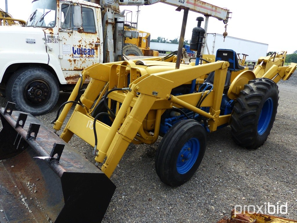

Ford 4000
Got # off engine block: D1NL 8051A
   / Ford 4000 Industrial Tractor identification? #3
looks like a 2030 or 4030 since it doesn't have the hard nose front like the 1801's did, look at the flat boss just above and to the rear of the starter mount, should be two sets of numbers there
   / Ford 4000 Industrial Tractor identification? #4
i can't see the front axle completely.. but do see rad rods, heavy hubs and the hook metal is from a 4xxx not a 2xxx
could have the lighter duty fixed axle.
Thanks everyone, here are more pictures...F4000-C.jpgF4000-B.jpgF4000-D.jpgF4000-J.jpg
I need to find a timing chain cover seal for the diesel engine. The pump for the backhoe/loader runs of the engine crank shaft.
tractor serial number location is on the flat area above and
behind the starter
Looks like the engine is a replacement from Ford (1971 or later)....? Still looking for information.
   / Ford 4000 Industrial Tractor identification? #8
HBR, Soundguy is right on approximate model of tractor. Can't be newer than 1964. Loader is probably a 705, backhoe need more pictures of to identify.
Parts available oem from a New Holland dealer. Many aftermarket available.
#9
Thanks everyone, number on tractor is 41300D (1964) and number on engine is D1NL 8015A (post 1971, a replacement).
   / Ford 4000 Industrial Tractor identification? #10
Ford 750-series backhoe attachment.
They made a 750, which was 10' dig depth and had 3.5" cylinders for boom and dipper
The 753 was a 13' dig depth and had 4" cylinders for boom and dipper
The 755 was the biggest in the series with 15' depth and 4.5" boom and dipper cylinders.
The loader looks like a 730 loader. The hydraulic oil is housed in the frame. The fill will be on the top of the left (IIRC) vertical upright.
As to the tractor......The numbers you give still arent the onces on the flat by the starter. The numbers we need are stamped, not cast. Here is what you need to look for FORD CODES and SERIAL NUMBERS
