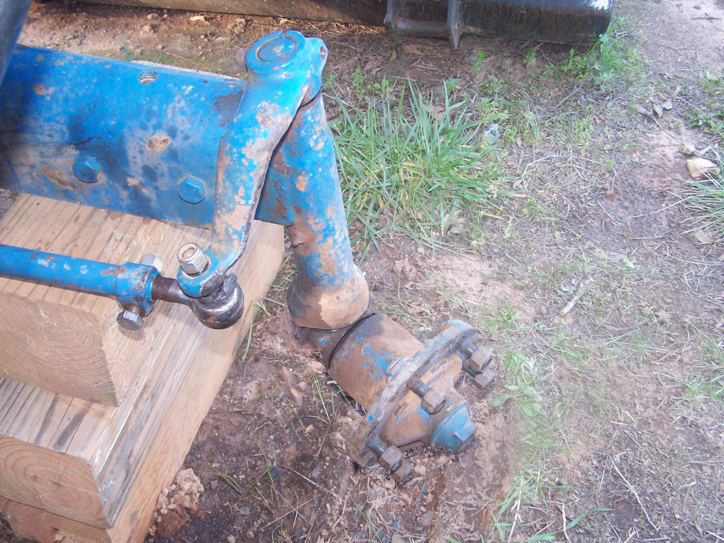

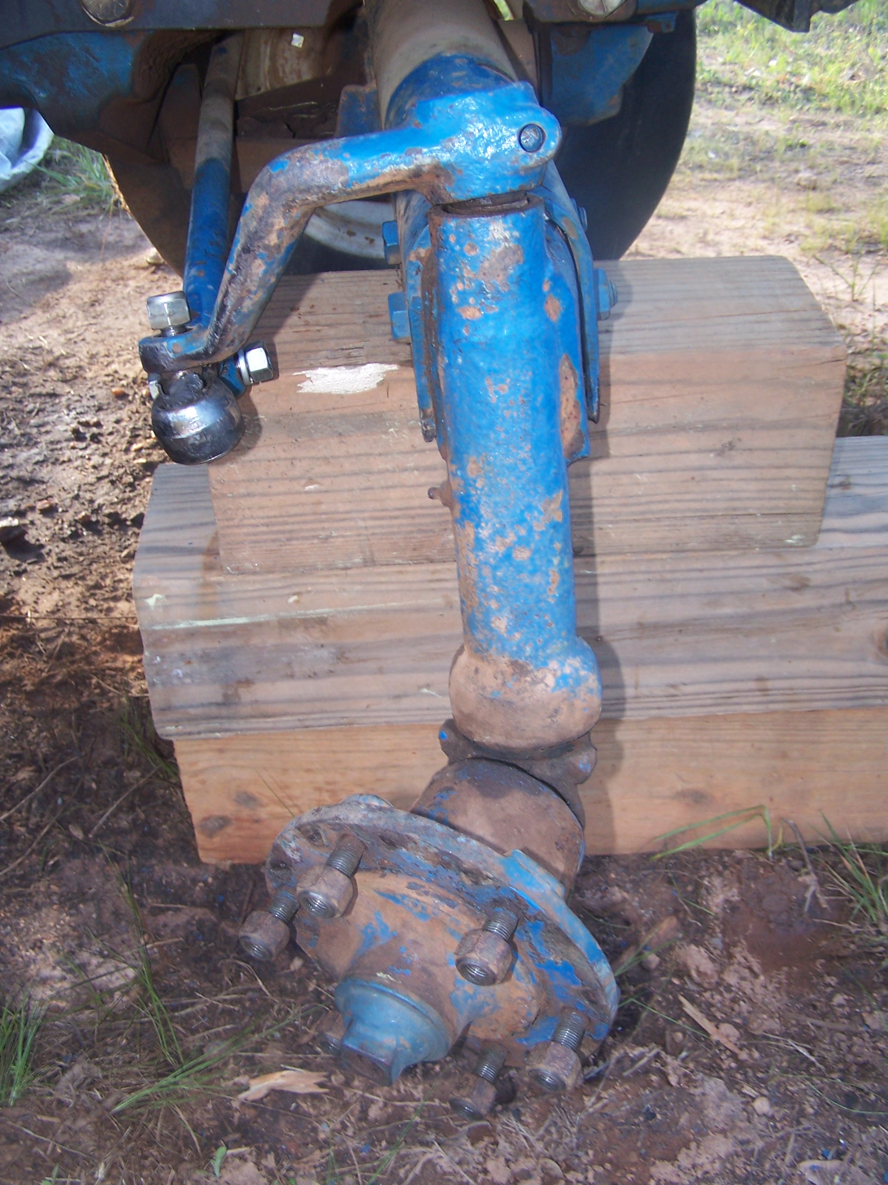

My right front hub on my Ford 4000 has either twisted or bent. Now, the tire rubs against the steering arm. I took off the tire and the hub is is twisted back toward the steering arm. I am pretty sure the bushings and bearing are toast because there is a lot of play in the spindle. I attached pictures. For reference, the left tire is pointing straight ahead.
I tried to take the steering arm off, but it won't budge. The manual says to use tool 1002, 951, and 625. Not sure what those are, is there something else I can use? Also, do I need to remove the hub assembly to take the spindle out?
