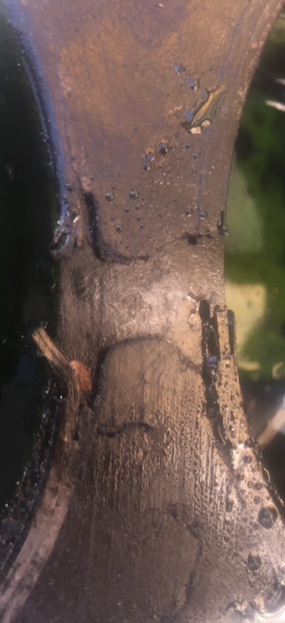

Hi everyone,
I have an issue with my 4400 three cylinder diesel. It has original 2600 hrs and always started fine down to about 30* with no glow plugs or block heater but the last week or so it’s been hard starting but ran ok.
Two days ago while I was running it, it started blowing plumes of black smoke at higher RPM’s. While cranking it over, it’s making some sounds like it was starving for air.
I pulled out the air cleaner and it’s pushing some air out the cleaner compartment. I opened the hood and there was diesel fluid around the #1 injector. I installed a new injector.....same problem. Next, I pulled off the valve cover and everything is working like it should. All valves open/close and no bent push rods. My buddies tell me it jumped timing but I think it’s almost impossible without breaking something inside the engine because everything is geared together.
I was doing some reading and found that the head gasket might’ve failed between two cylinders. Is there anything else I should look at before I pull off the head?
Thanks,
Andy
   / Ford 4400 Diesel engine problem
Gut your old injector and do a compression test.
Thanks Rick. Made it happen yesterday and was happy to see the head gasket failed between 2 & 3. It’s hard to believe after 50 years the cylinders look great with the cross hatching still in them.

Those 201's are a tough engine. I think it's recommended to retorque the head bolts occasionally on those which is probably what happened...
