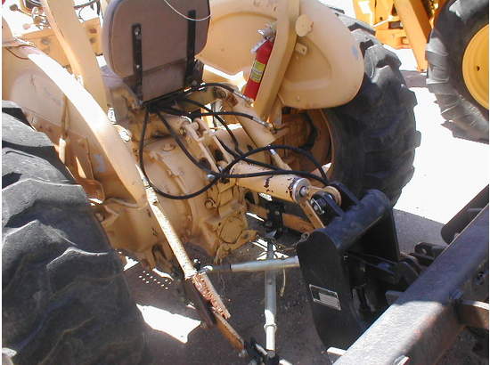

The one I am looking at is 4wd and has a fully enclosed cab. I am glad to hear it is about 10K as I will be able to haul it on my trailer as needed. The seller indicated it did "not have a live PTO". I am awaiting clarification, but does this mean it does not have a PTO at all, or are there different styles.
Not sure how many different pto's were offered..but I got a picture of one with no pto here.

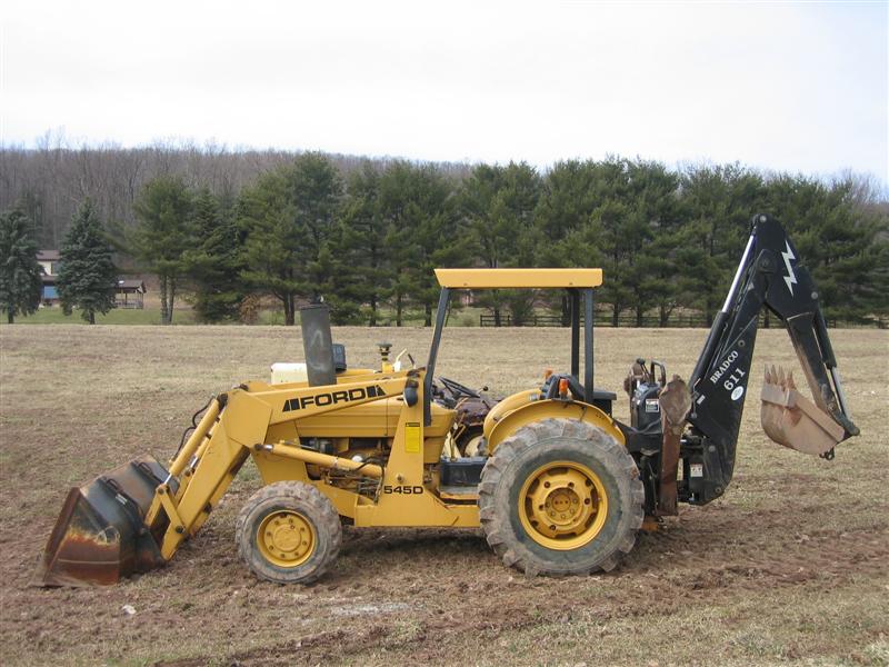

Those machines are beasts with no present machine on the market even close to its equal.
I agree! This is mine. Just remember that they are "beast" to trailer around too.
