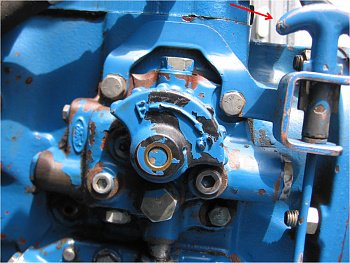

I'm not sure if anything in the aux valve distribution block could cause this and i tried to measure pump pressure at the port on the actual pump casing to see if there is any pulsing down there. but i don't have an adaptor of the correct thread to go in there, it looks like the same coarse thread as a mini mess connector on some test points but the test point i had wouldn't start easily so i didnt want to continue and damage the thread.I was trying to eliminate whether the problem was up in the aux take off housing or down at the pump end. I'm not all that clear about this system even after reading the workshop manual it doesn't seem to have a hyd schematic.
I have since taken the pump out an inspected there was a little light scoring on the internal pump face but not much and not measurable in depth of wear for instance. The pump relief valve was actuated a few times and flushed out, that seemed fine.

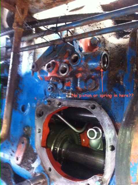

I then went to take the spools out of the flow control (speed adjuster) and the spool labeled as cooling valve in the manual had no piston or spring inside its chamber when i stripped it! this seems strange unless its omitted on some models as the owner says the hydraulics have worked before and no one has been in around the flow controller.
I did notice when selecting the hydraulics to loader or 3 pt link there is a rushing sound in the hoses and top cover area and i wondered if theres an o ring between top cover and main case that may have let go. flow control.JPG

After rebuilding and re filling the symptoms were the same, i took the large plug on the fwd side of the flow control valve out and there is nothing in there , the manual shows a plunger and spring - something to do with a cooling valve ...do you know if this is ommitted from some models.

Ive checked the spool in the flow control and it seems free enough , also i noticed the cooling spool was missing , i wasn't sure if this is omitted on some models.

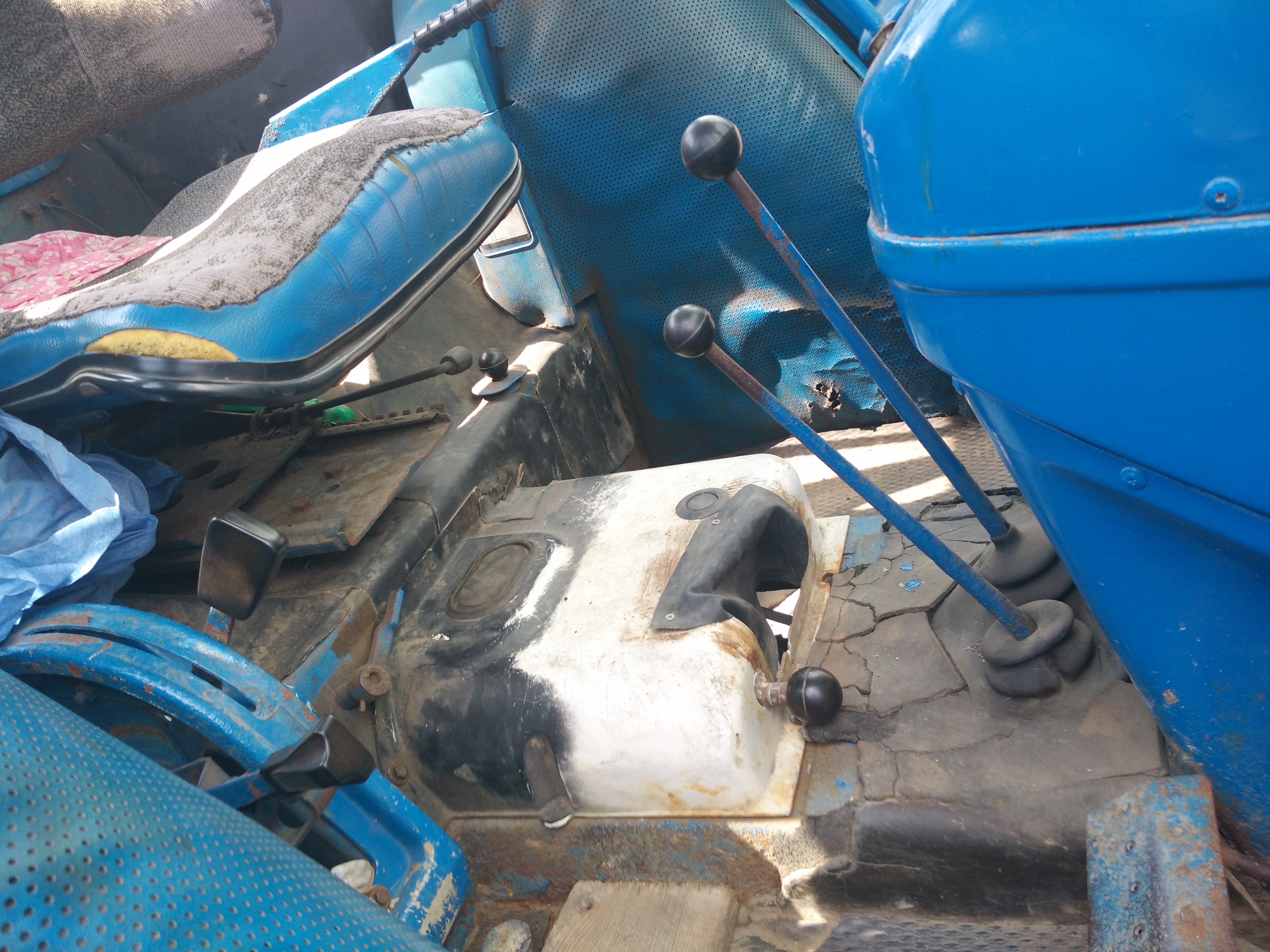

Hello. At the beginning I want to apologize for the spelling, but translators are translate google translate because I'm from another country.
I have not bought a FORD 4600 tractor for a long time and I have a problem with plumbing from the very beginning
The oil and filter in the hydraulics was changed half a year ago (he worked 200 mtg), and the fact that the previous owner assured that recently when he used the lift (ie about 2 months ago) everything was ok.
I noticed that under load when the lift lifts up everything is ok (floats smoothly, does not tug) but when it reaches the required height, it gradually descends and raises again. As a result, raising and lowering the tractor trembles so that it can not withstand it. What could be the reason? I will add that the tractor is equipped with a front loader that goes flawlessly .... (for those who do not know I'll add that this tractor has a lever under the seat to change the hydraulics (works or jack or turn)). I also know that the tractor has the regulation of the pace of the hydraulic pump, but if I did not set it all the time the front loader works without changes (it's ok) and the lift bounces ...
The oil condition when I check on the dipstick is ok (the tractor has the one behind the rear left axle).

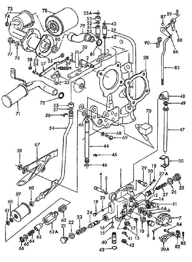

I read was similar when the oil filter was changeable (but then they wrote nothing about the front loader) and in my case it was changed six months ago. Others wrote that in the manifold the valve was stuck (I think it's No. 27A or 24 in the picture No. 3). Still others that the manifold under the seat has been damaged (hydraulic switch for lift or turn).
I am surprised that the front loader works properly, and the lift tugs ... If the filter (No. 71 in picture 3) was to blame, would it be possible for the front loader to work properly and the lift tugged?
What can cause the lift to tear?
1. The interior of the tractor (from white plastic comes the lever to change tur / jack)
2. I have such a hydraulic distributor (except that I have a working pace in the cabin) (photo borrowed from the Internet)
3. Diagram of hydraulics and distributor (photo borrowed from the Internet)
