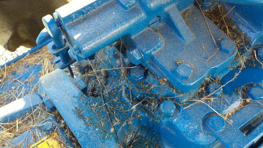

I recently purchased a 1990 Ford 4630 with 1000 hours. There appears to be fluid leaking from the hydraulic pump where it meets the case. There doesn't appear to be a gasket. Is one required? any recommendations on how resolve this issue?

the picture you show is not the pump it looks like the remotes the pump should have a gasket on it but the picture you showed will have orings under the remote valve where it bolts to the lift top cover
