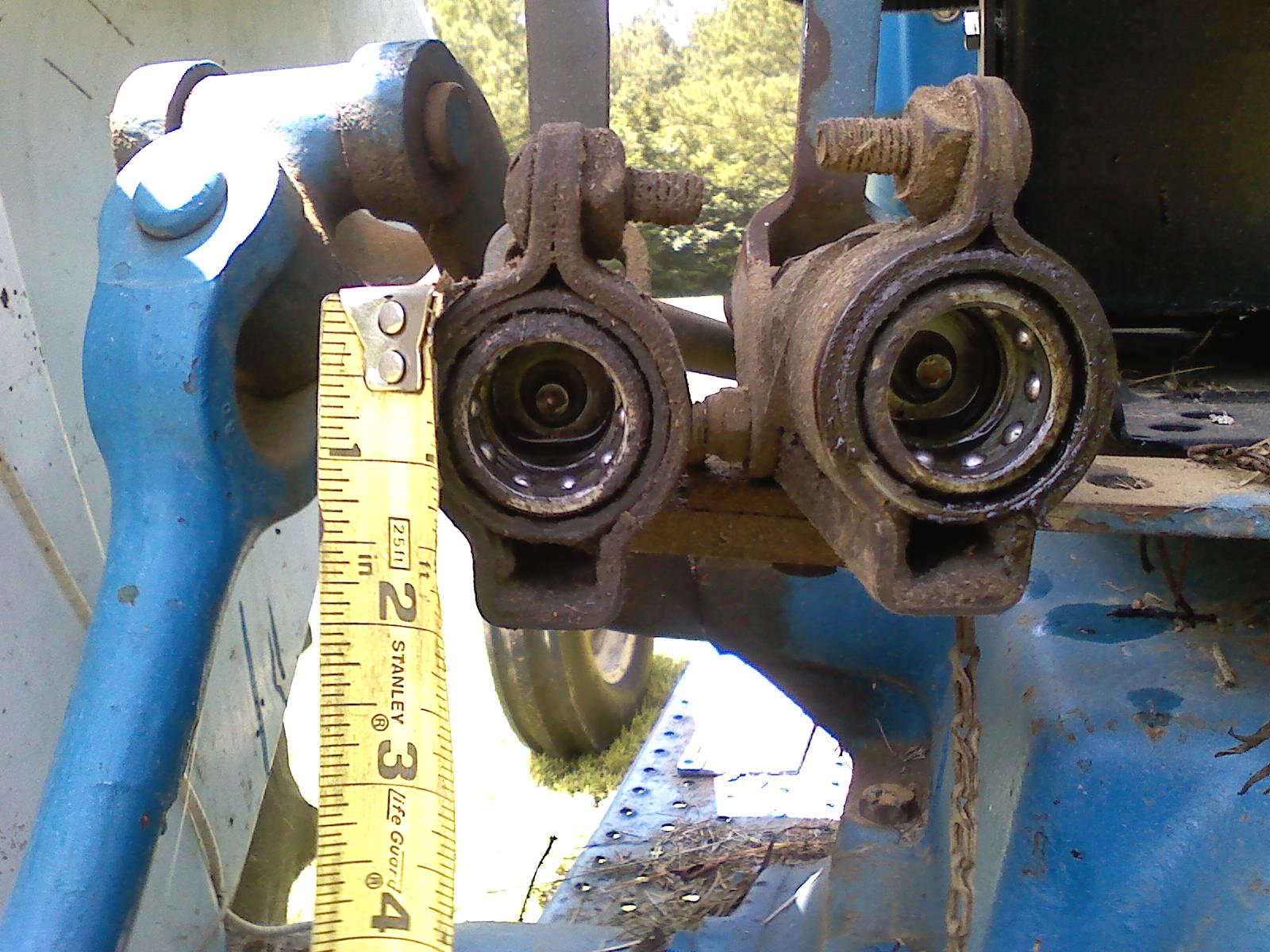

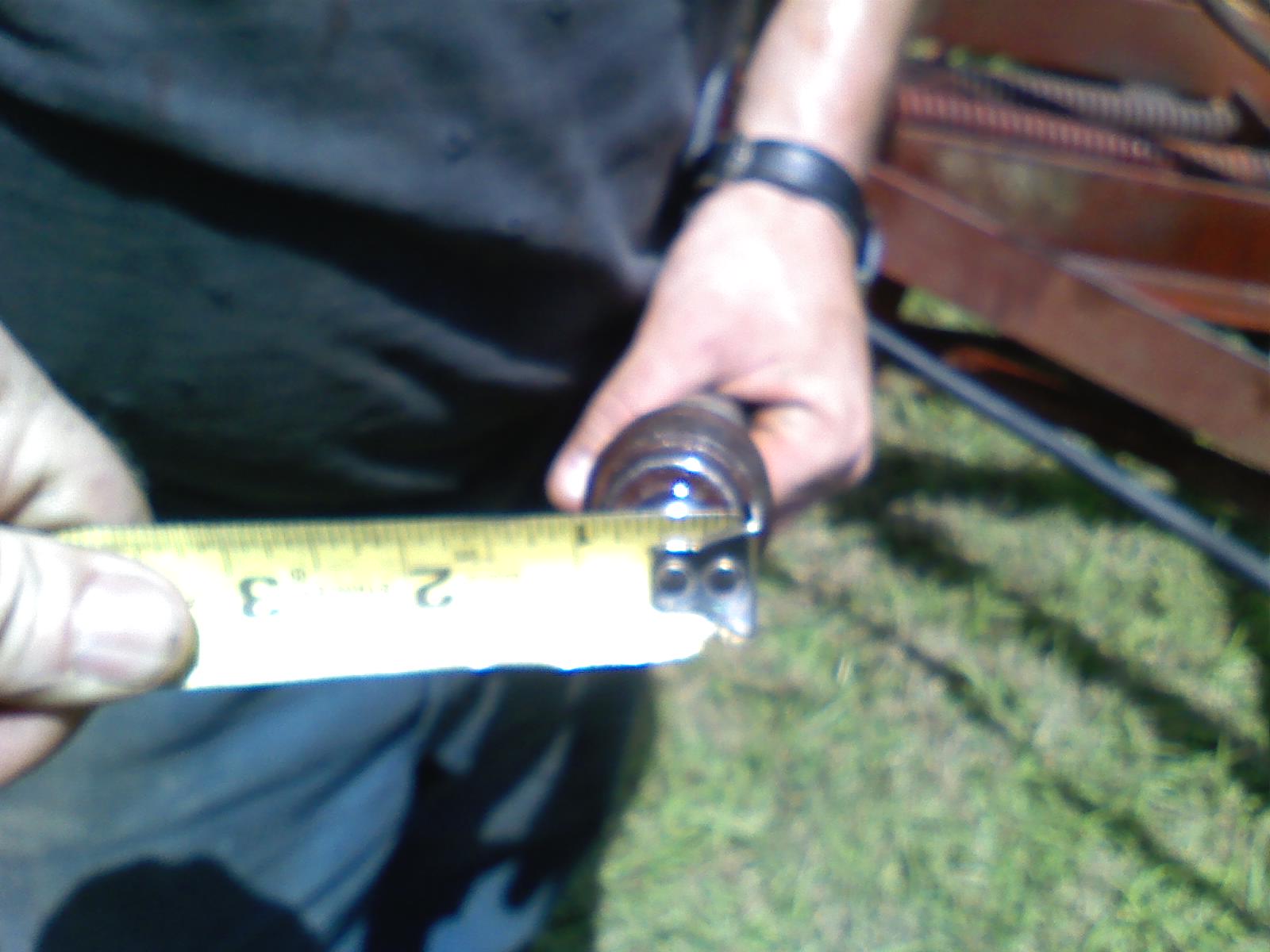

OK here is what I have. the male tips are to large for the tractor/female side. going to new hollund today but ill take any suggestions you might have.Thanks.

What I would do, is to take off the QD's on the tractor, and clean them up really good, and take them to a hydraulics place and see if they can match. The other way is to get some matching sets of whatever, or match up to what you already have on other implements. There are many look-a-likes. They can be anywhere of $20 for a set, or up to $60 for a set. You could also go to flat faced connectors if you wanted to connect under pressure.
   / Ford 5000 and IH 480 disk hyd qd #9
You need a pair of ISO (also called Pioneer style) male tips with 1/2" npt threads. Common as dirt, the most common and popular male tip used in the AG world. The tips on the disc fit 66 and 86 series IH tractors and nothing else I know of.
