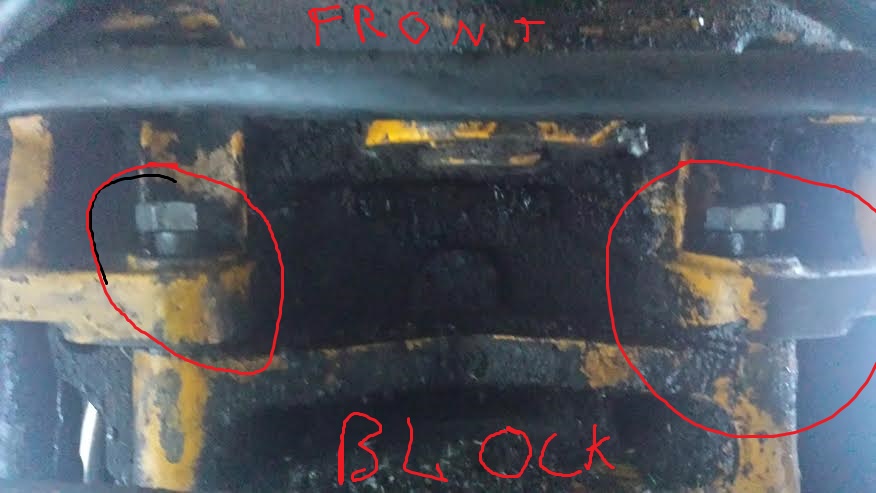

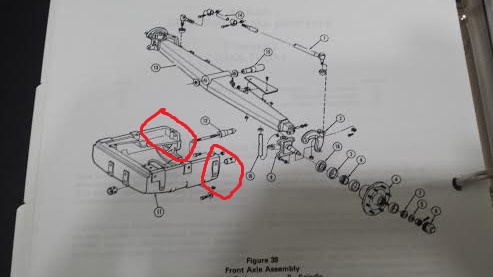

I have a vintage ford 555 that keeps wanting to come apart at the front axle to where it mates with the block
No matter how tight I get the bolts 1-1/8" Grade 8 it always comes loose I even tried red loctite last time * granted it was a hurried fix and probably didn't set up properly
The threads don't seem too bad
any ideas I am bout to just weld the front support to the block which I don't want to do but I am tired of the front flexing and potentially buggering up the threads
I am not sure how I could tap out a larger thread size due to the space constraints
Basically what will happen when those bolts work loose is the radiator support and hyd tank "nose" will move up and down with the terrain the interesting thing is there are 2 other bolts that are always tight no matter the relation of lower bolts being tight loose

Thermal cycling is the likely issue. The block expands and contracts each time you use it. Two suggestions. Clean the hole and bolt threads with solvent, then primer before locktite. Place a hardened SAE washer on the bolt. (not as wide as regular washers) The washer provides a bearing surface for the bolt head and allows greater tension to be developed from the torque. The bolt will then stretch and take up the cycling.
PS ... This assumes the grade 8 bolts are the original bolts specified. A lower grade bolt will stretch differently.

The repair manual states 200 ft/lb as spec for bolts
Also in a hidden section on the repair manual it states there should be shims between the block and front support there never were any
so I am going to try :
cleaning out the threads really well
finding or making shims
and lock washers with some red loctite
if that doesn't work then perhaps tack welding the bold heads not a good fix by any means but no way I could ever cut new threads in the engine block at a price that was worth it for a high hour machine

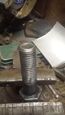

The wrench size is not the bolt size. Make sure what size it is before torqueing so it doesn't shear. Just a guess on my part, but unless that is a huge vise I would guess that is more like a 7/8 bolt with a 1 1/8 head. I'd hate to hear of you using a torque chart and breaking that bolt off in a really bad place.

1.125 across the flats is a .75 bolt let everybody know what size the bolt actually as
   / Ford 555 front axle wanting to seperate from the block #10
3/4 boltaked a lot more sense.
