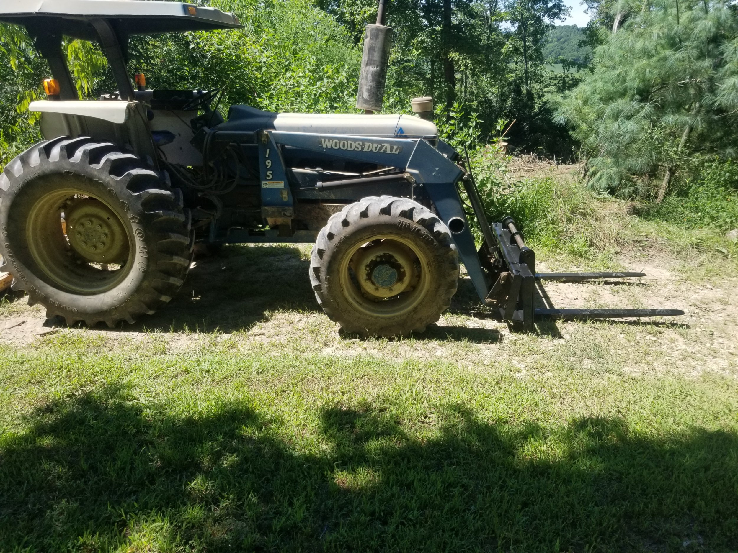

I have a Ford 5610 MFWD that currently has a Woods Dual 195 loader on it, its a pretty flimsy loader and I bent it while digging into some dirt piles (its still usable and I'll definatly keep it for my other 5610). There is a Ford 741o loader available nearby, it looks heavier but I know nothing about it. Would it fit and is it any heavier? Or should I just get a new Westendorf?

Usually the Ford loaders will fit 3 & 4 cyl tractors. Just the brackets are different. We have a 4630 and 3 5610, one is 4x4 like yours. One is I think a TN 80 A, loaders will swap out. Made a couple sets of brackets. I'm talking the later tractors with a hollow front axle. Not the beam axles. On the 4x4 5610 we cut the square tubing rear loader bracket to clear drive shaft. Welded 3/4" plate in the top of it.
