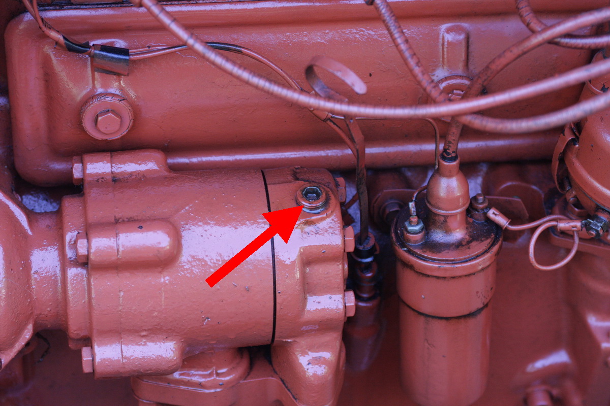

I just purchased a Ford 641 to use as a dedicated chipper tractor and I have an issue that I need to get fixed. The former owner said that if the 3 pt hitch would not lift, partially remove the threaded plug on the Hyd pump to remove the air. Sure enough it is an issue. If I purge the air, it will lift ok for about a day. My first question is, what the issue might be and what the fix might be. Is there an easier way to purge the air? I will not be using the tractor daily, so if there was an easier way or a cleaner way to purge it, I would be fine with that. All fluids have been replaced with UTF fluid. ( except the motor) This will most likely be the first of many questions so I will appreciate any help. One thing I need to add. The hyd level was spot on after I changed it and now it is showing very high on the dipstick. How much of an issue is the high level and what is the chance it came from the transmission or rear end? I have attached several photos.

position of the lift arms has -000000- to do witht he pump loosing prime. ;)
the pump looses prime for 2 main reasons.
1, bad orings on the plumbing
2, bad shaft seal in the pump
1 is cheap and easy to check. 2 is more involved to fix, and requires some special tools if you really want to rebuild the pump completely.
if 1 doesn't fix it, and it otherwise runs fine all day and only needs to be bleed every couple days. and you don't want a full rebuild onthe pump.. then buy a 5$ petcock and screy it in place of the plug, giver her a turn open while cranking when it bubbles, close it and go.
As for a trans overfilling.. that is a perforated high pressure line that runs thru the trans.
it is a bit fo a task getting proper stepped tubes made.. but it can be done. otherwise you sleeve the perfed tube with soemthing like 10mm tubing and lots of epoxy.
if it's a small pinhole... the sleeving may well be the fix for the next 2 decades..e tc.

if you look at the pump, there is a plumbing manifold that goes from there to the trans front face. that's where it joins the tubes that run thru the trans to the diffy... on either side of the plumbing manifold are the oring spots. at least one is a flat faced oring that i hav enot had good luck using round profile orings for.. instead.. get the cnh oring.

Well.. the piston, arms and unloader valve are all in the hyd TOP COVER.. the pump is bolted tot he side of the engine, and has a suction and high pressur eline to it. I'll stick to the opinion that lift position has no bearing on a pump loosing prime. Once the lift is lifted to a place where you want it, the unloader valve 'unloads' the system dumping it to sump just like it does with the lift arms down. thus.. the unloader valve should be in the unloading position at both times.. so that punches some holes in the theory right there.
If trans looses oil and hyds overfill, t is the suckion line that is perforated, sucking trans dry, overfilling hyds. VS trans overfilling, sucking hyds dry beaing a perforated high pressure line.
