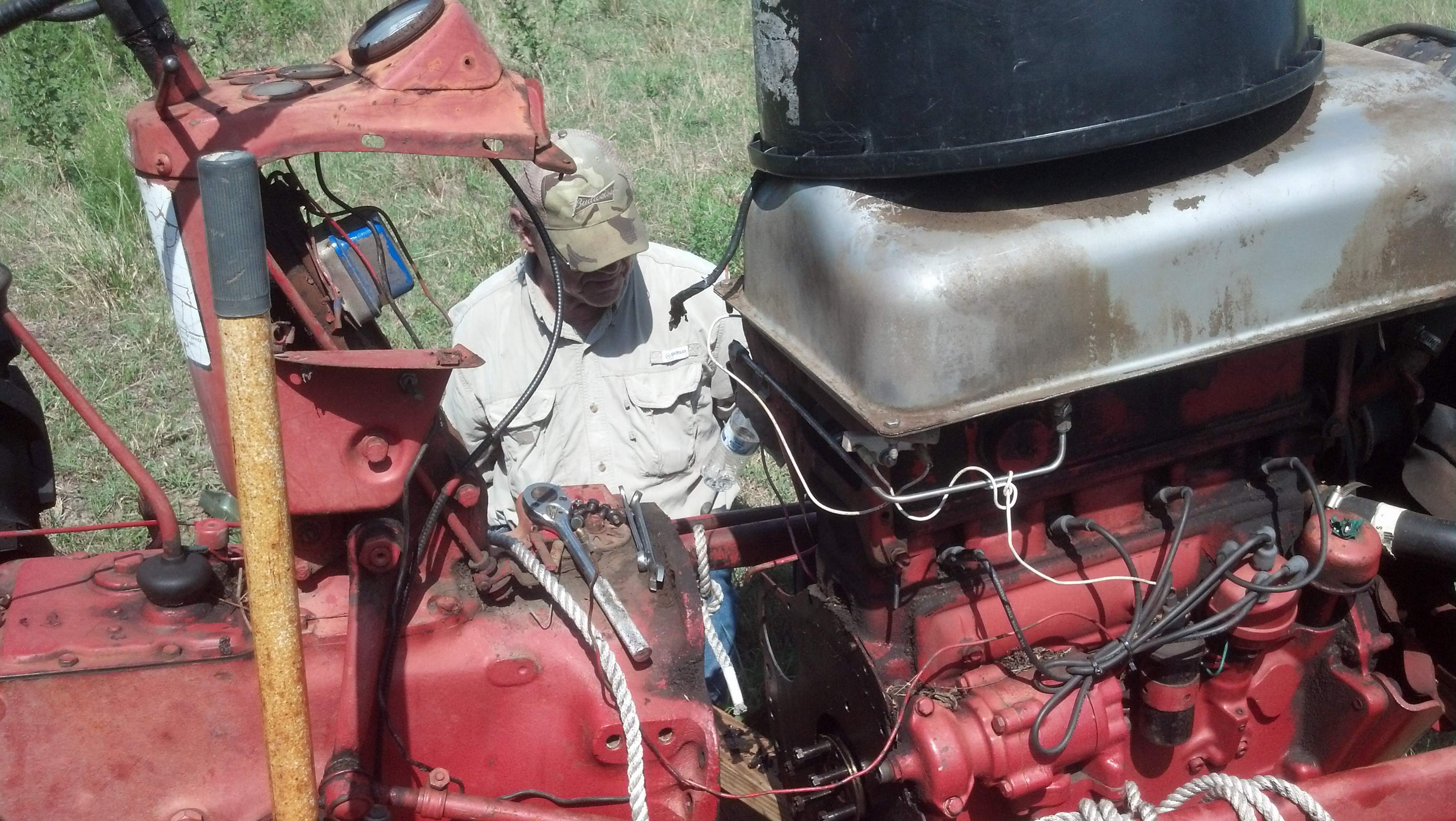

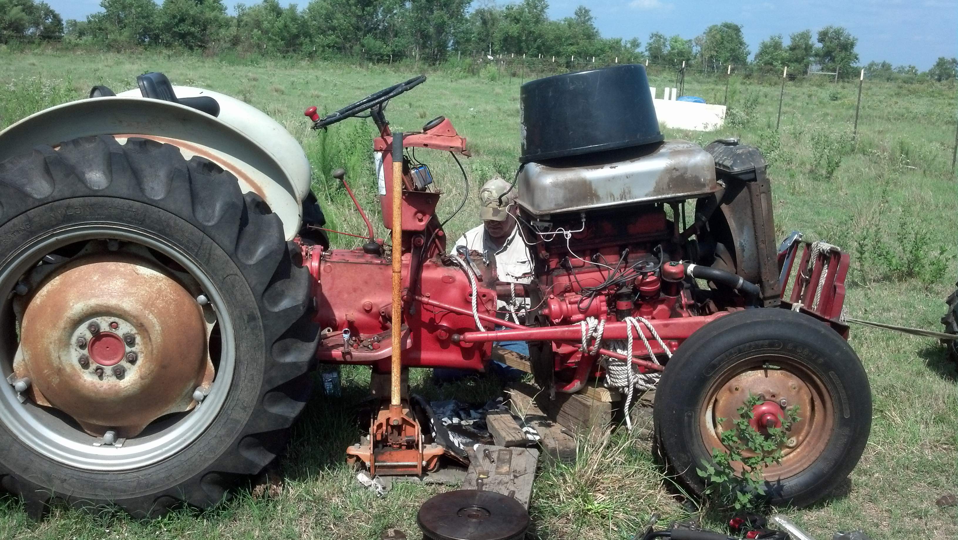

Carried this from the Ford 600 clutch replacement thread.
Split and removed the clutch and flywheel today. Ended up being a 10" clutch plate. The pressure plate is fine and the flywheel is fine as well. Why are there degree marks on the flywheel? Is the throwout bearing and the release bearing the same thing?
   / Ford 641 Clutch and Flywheel Replacement
#2
   / Ford 641 Clutch and Flywheel Replacement #3
Yikes! And I thought mine was tore apart. Good luck getting her back in shape. She will be alive and kicking soon.
   / Ford 641 Clutch and Flywheel Replacement #4
timing marks on flywheel.
