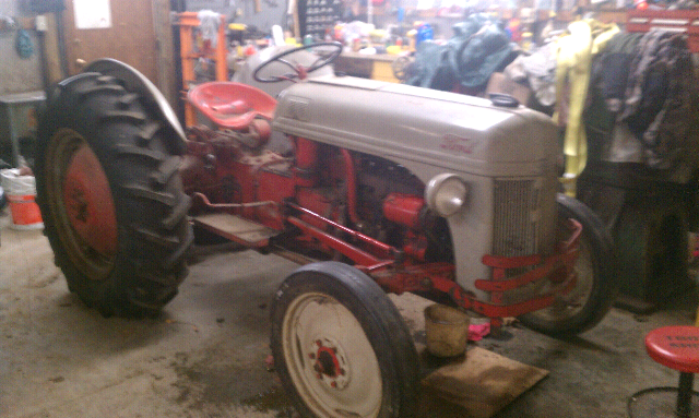

Thanks for the great advice guys. I just finished up the valve job a 8n that was my great grandpa's on my dads side. (641 great grandpa on mom's side) She is purring like a kitten now, my dad said he's never heard it run that good. I'm looking forward to working on the 641. Thanks again for the input.
Here is a pic of the 8n, just finished it this evening.
