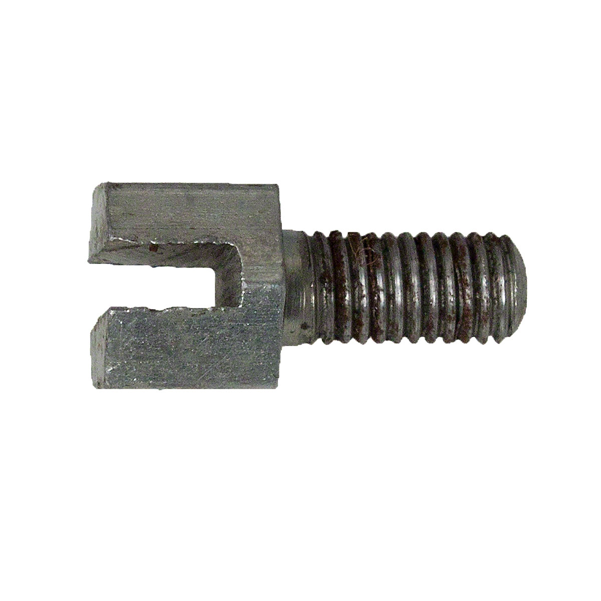

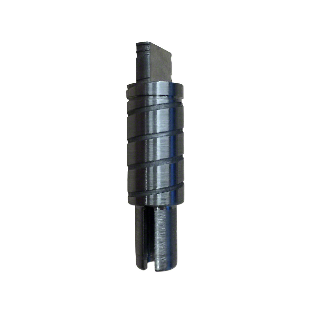

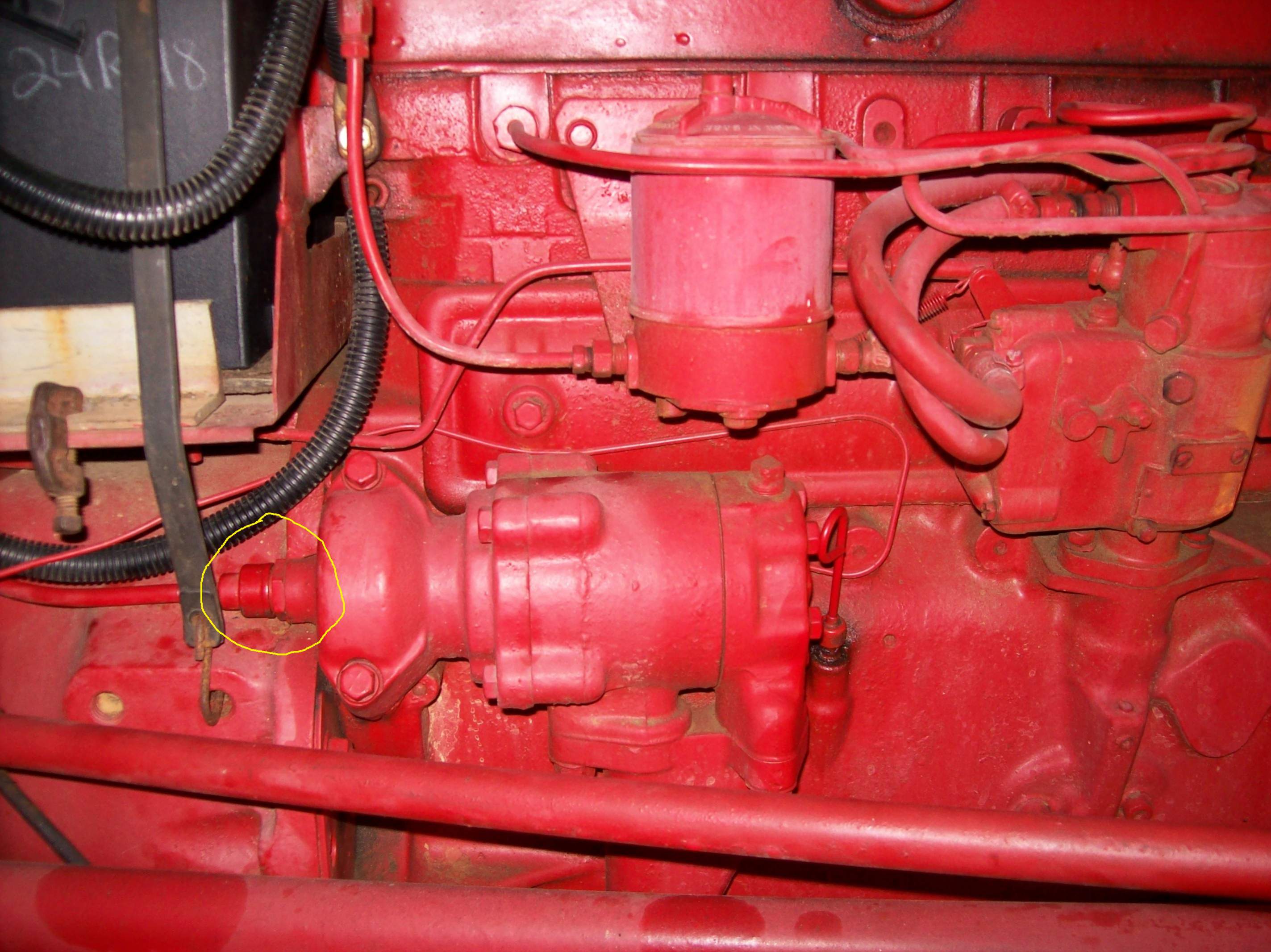

If it is anything like my '58 861D Ford, the cable connects to the rear of the hydraulic pump. The pump is driven by a gear on the rear of the cam shaft. My cable drive fork that turns my cable end at the pump was worn out and had to be replaced. proofmeter drive.jpg

The cable does not turn at the meter. Doesn't seem to be hooking up correctly at the drive end.
/ Ford 661 Proofmeter #6
Take drive cable loose from hyd. pump and make sure the cable is OK and not broken. If it is, then most likely the cable drive in the end of the hydraulic pump is bad. That was my problem with my 861D.

Also check if with cable attached to proofmeter, spin the cable by hand at the opposite lower end to see if proof meter reacts; could be a problem in the proofmeter itself.
