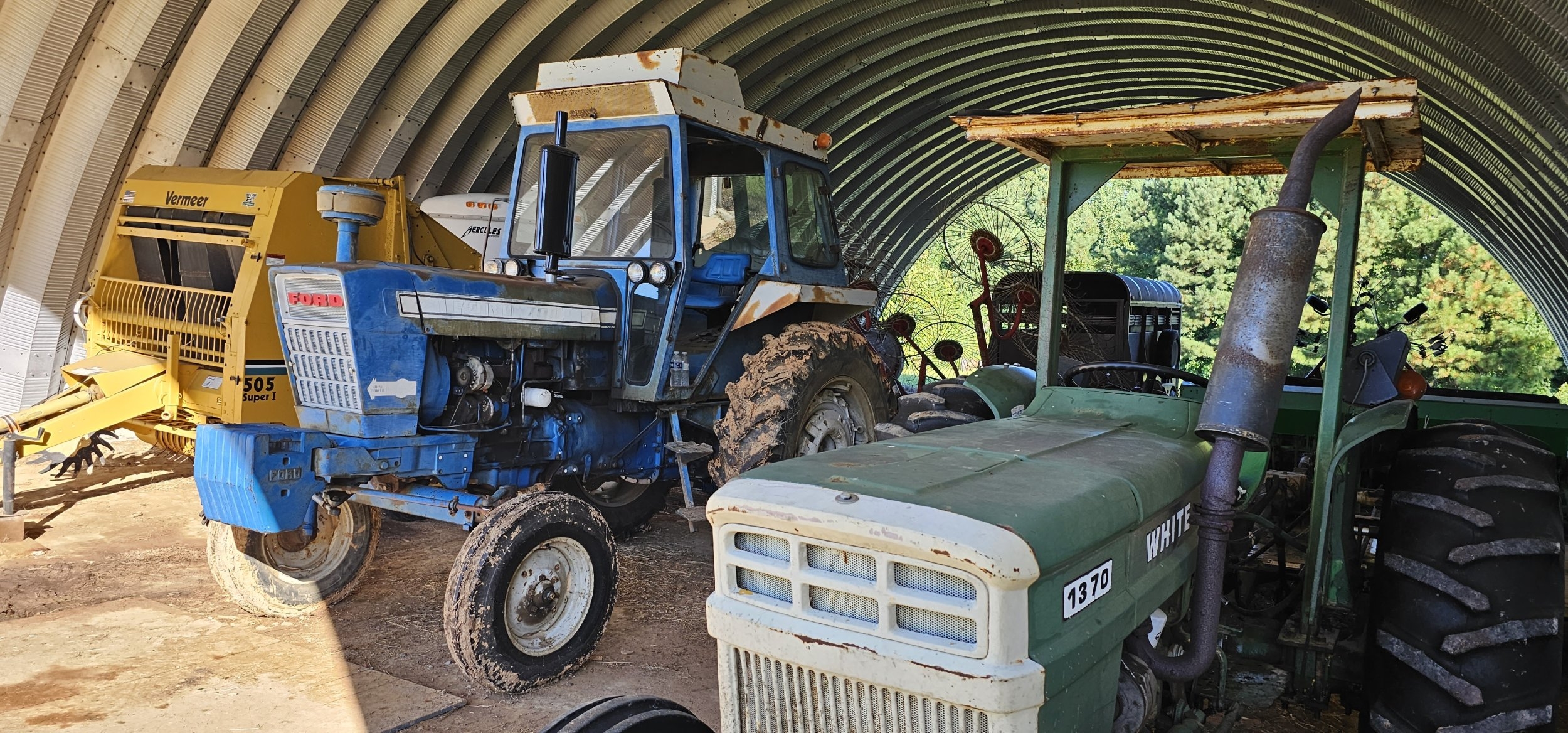

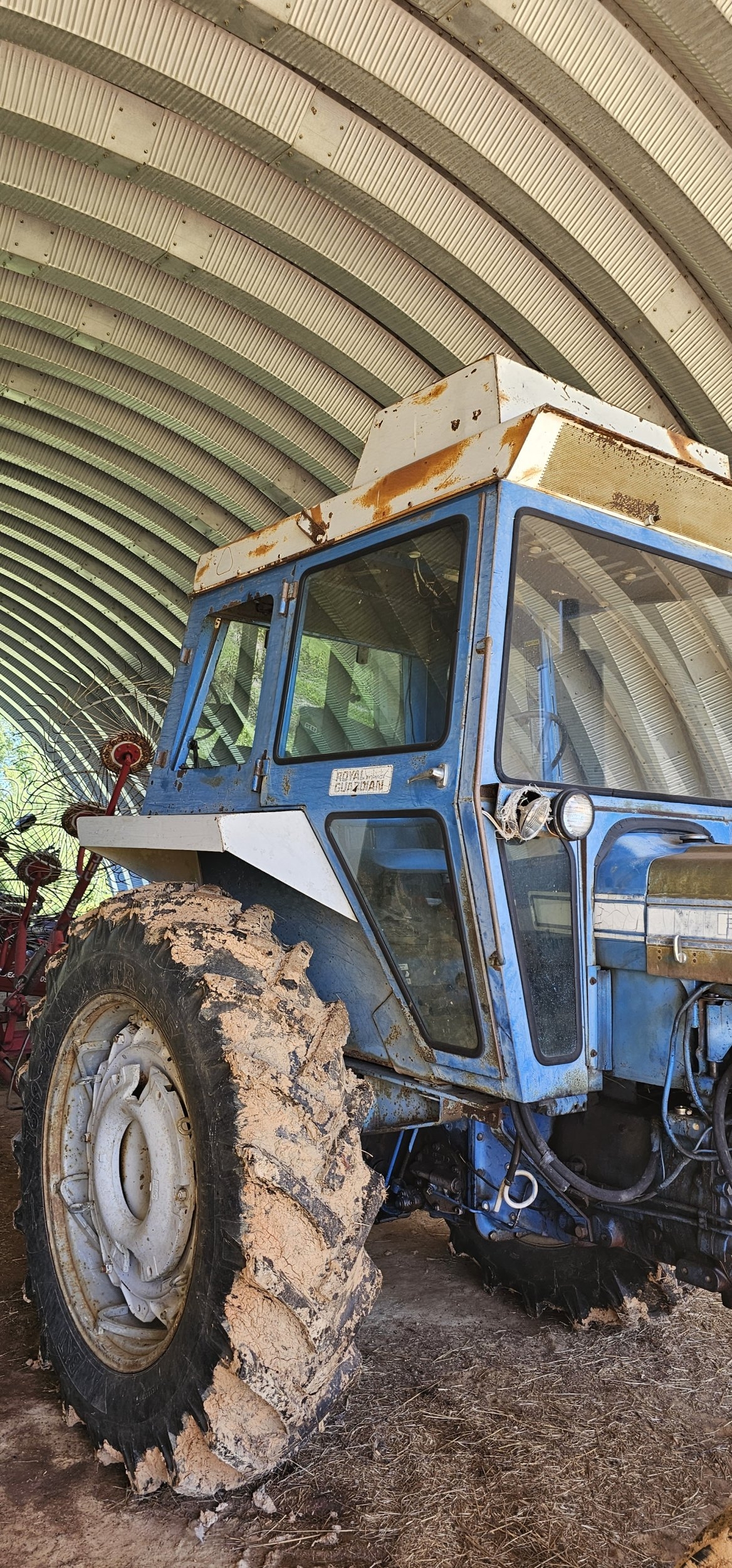

Thank you for the info! Hopefully we'll get her back up and working out there soon...
   / Ford 7000 Head Gasket Repair #5
No problem. Nice 7000! Simms cab?
