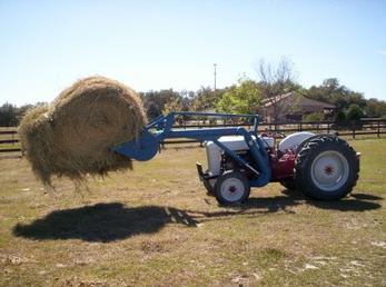

all of mine that are installed work.. I have a 1955 ford 850 I routinely use to move 800-1000# round hay bales with. here's a pic with a 1000# tifton bale strapped intot he bucket after it fell off the side of the hay trailer as i was going thru the pasture and almost split apart.
soundguy

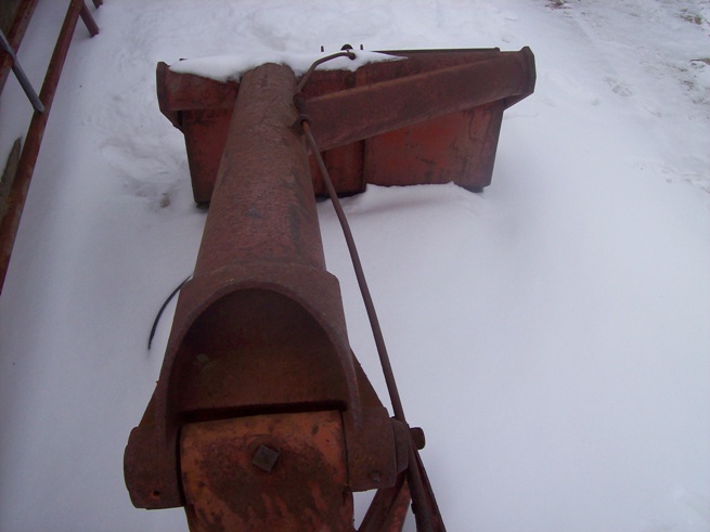

Thank you SoundGuy for the info on the 711. This one looks like a 4 cylinder version with a rod, Just guessing it is a earlier version, from the way the pin in the pivit point is being held in.
   / Ford 711 one arm loader #6
would have to see lower to tell for sure. looks like a good project. metal all looks intact.
