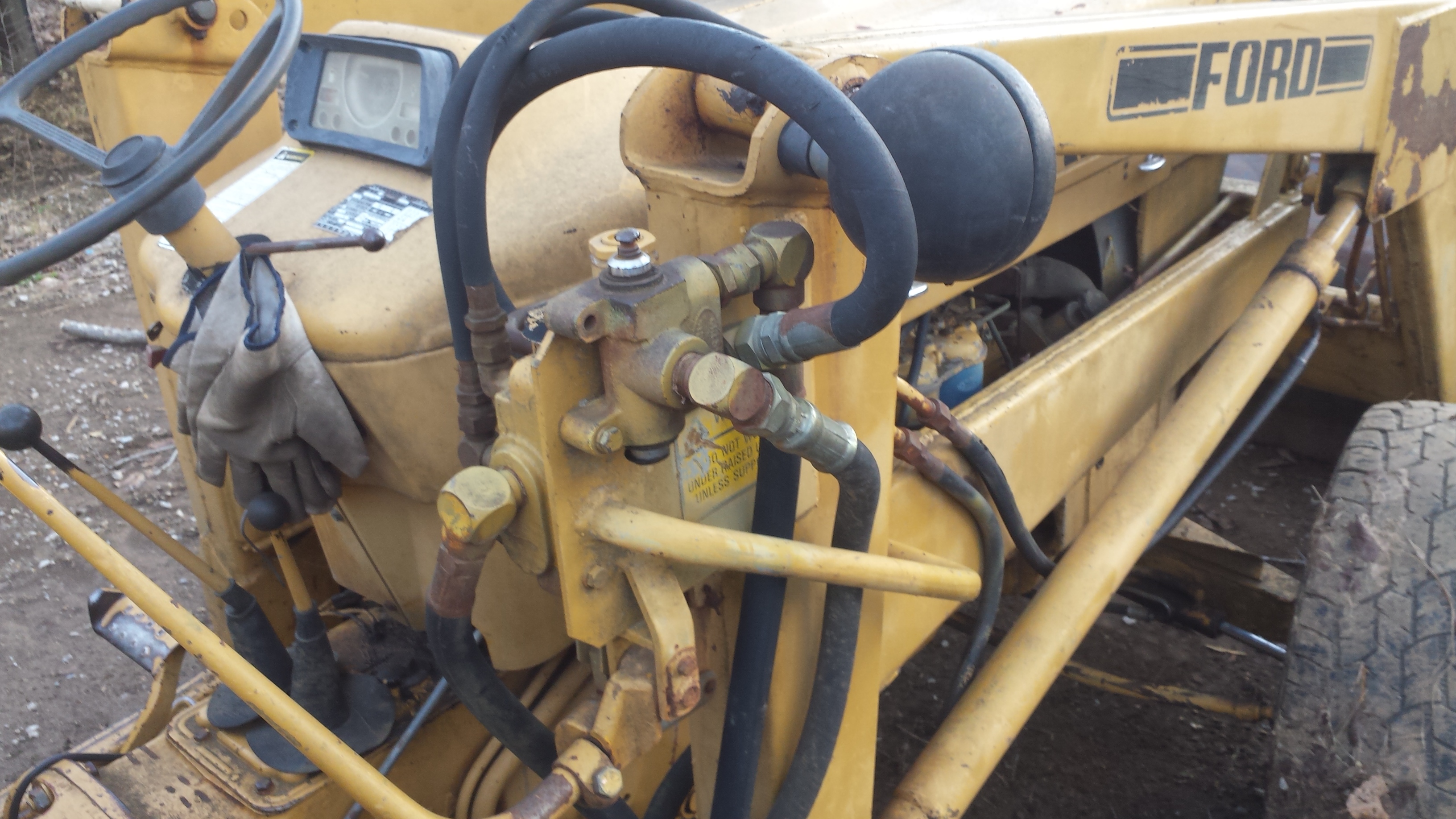

I want to replace the control valve on my loader and have picked out a new Joystick controller.
The question I have is what is the pipe that goosenecks up and through the steel plate?
Is it a Power Beyond, or unloader? It appears to go into the arm of the loader and has a nipple on the inside of the arm.
This is the Joystick: 2 SPOOL 14 GPM PRINCE LVR JOYSTICK LOADER VALVE | Directional Control Valves | Hydraulic Valves | Hydraulics | www.surpluscenter.com
This is a pic of the pipe I am talking about:
Thanks for your help.

That pipe is the loader fluid return to tank. The hydraulic reservoir is the loader frame.

What's the gpm of the pump.
14 may be too small.
What tractor is this on?
Is it using tractor hydraulics? Or the add-on front pump?
Is it feeding anything after the loader valve? 3ph or backhoe)

The pump is a front pump. 13 gpm
No backhoe or additional equipment.
The Tractor is a Ford 5000

Mine is pretty similar the loader arms are the fluid resorvoir and the metal pipe from the valve to the arm should be the fluid return

have same loader 21 gal min front pump.what joystick valve are you planning to use.
