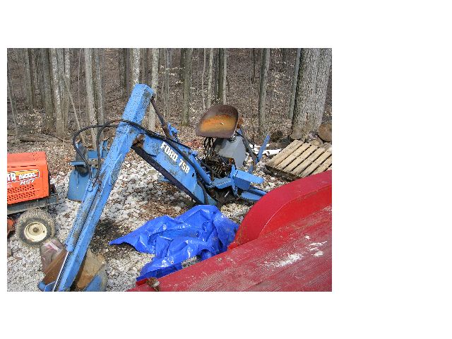

I recently bought a used Ford 758 BH. She was worked hard and put up wet. I plan to work on it and get it back to good condition.
I don't know very much about BHs. I saw it a few months ago for $1200. It was mounted on a Ford 600? tractor. I did see it operate. The issue is the stabilizers go down but, not enough to lift the rear of the tractor. The attempt at diggng was hampered by the fact it wanted to drag the tractor.
The valves that operates the stablizers has been replaced with a remote set. In addition, they had to install a on/off valve that made the sablizers work or the bucket control. But not both. OK, this is not great but, turning the valve to operate the stablizers is not so bad......if it worked.

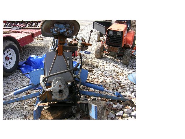

It has a new Prince pump that mounts on the PTO shaft. Can't determine the size, name plate is destroyed for Model number area??????IAC, only SS number 293239. It's about 7" wide 10" tall.
First attachment is the Ford BH 758 BH from a distance.

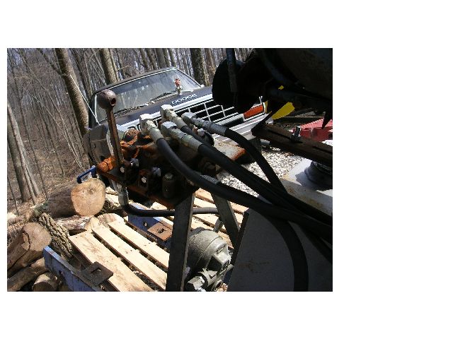

Here is a photo of the control valves for the bucket control. Notice on the left where the lines head back.

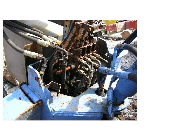

Here is where they go..to the remote set that controls the stablizers

OK last view. Back view with the new tank and Prince Pump.

The aux valve for the stablizers is on one of the two 'outs' on the Prince pump. The shut off for the stablizer is on this line going to the aux valve. Then the 4 lines that would have gone to the original set of valves come off the top of this aux valve. The return from the aux valve "T"s in to the return from the main set. It could be bleeding off through the main set. I think this might be the case because; When the aux valve shut off is closed, main set works fine. but when the valve/shut off is open the mian set moves but very little. I could likely have an additional shut off on the Aux return and completely isolate that circut. But two shut offs would be quite a pain in arse!
