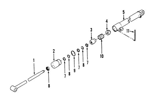

Went to messicks.com and Parts Diagrams > New Holland Agriculture and typed 770A in the search area.
My bucket cylinders did not match the posted diagram, they match the messick diagram for the "Double Acting Bucket Cylinder".
The diagram in the post looks like the lift cylinder when comparing to the messicks diagrams.
My bucket cylinders had grooves machined in the head for the various o-rings and seals, the only "v-pack" per-say was on the piston end.
The head will come off with the shaft and piston when pulled out, so not sure what they meant by their warning.
Once it's out, the nut and piston are easily removed and the head should slide right off.
Maybe they just don't want you to remove the nut entirely and leave the guts of the piston end in the cylinder (only way I can think of that the shaft could come out by itself).

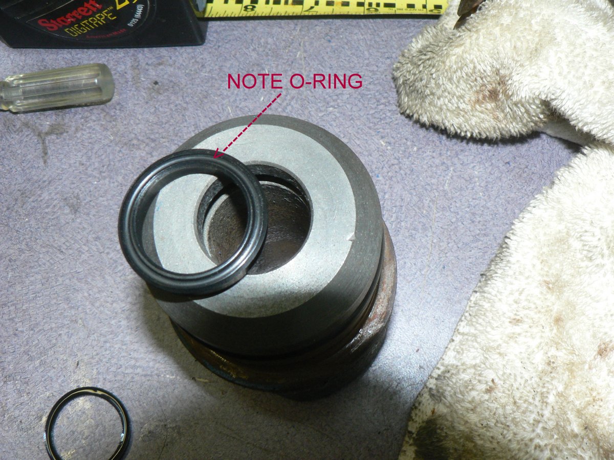

Thanks for the reference to Messicks as I've never used them. I have found the same in that mine (tilt cylinder) doesn't match the diagram posted for certain aspects, and does match the diagram you referenced and I've attached.
I'm having a hard time with items #7/#8 and have attached a photo. Mine is a seal, not a 'leather washer' and 'O-ring' as the Messicks diagram calls out. I'm talking about the #7, #8 adjacent to the cap #2. It goes inside the cap at about the location that the o-ring goes on the outside of the cap. Note that mine is actually two parts- the seal and a thin o-ring which keeps the seal expanded.
Did your kit come with an O-ring and a washer for these parts, or a seal as shown in the photo? I'd much rather install the O-ring/washer. If yours has the seal like I show in the photo, got any advice on how to insert it into the interior groove? If it's bent too much, the o-ring wants to come out of the seal. It seems to match the rotten one that I removed, and appears to be why mine was leaking. Thanks for your time, Dean
Edit: When I say it matches the previous seal, not exactly. It seems larger than the previous seal, but similar in design. I'm regretting not buying the Ford kit for this. I'll try and find o-ring and washer similar to the others shown in the diagram on the right.
Sorry, I don't recall. I took a look in the (messy) garage for the old 0-rings and seals and didn't find them.
The local hydraulic shop pieced the kits together. They had a large peg-board covered with zip-lock bags of parts and they just walked along and grabbed what they needed (got the impression they could have found them with their eyes closed). With the first cylinder, the guy just installed them all for me and stacked up the v-pack in the proper order and zip-tied it for me. Second one I was on my own and actually ended up having to go back because I messed one up (maybe the one you are questioning).
