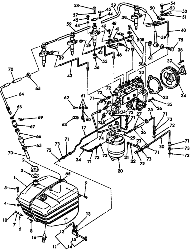

hi I have a ford 7710 where diesel fuel is getting into the oil. Does anyone know all the places that diesel can leak into the oil.

Injector pump, injectors.

lift pump can leak but not into the motor just into the pump if it has a inline pump on it. but your best bet is the injection pump are the injectors. does it smoke bad if not its not the injectors its the injector pump and if u aren't sure its diesel the powersteering pump front seal could be out letting more oil go into the motor block

The lift pump can and will leak fuel into the crankcase, by way of the injection pump cambox and pump camshaft seal. Another possibility is a leaking Thermostart unit. Injectoprs can leak as well, but less commonly than either the lift pump or Thermostart.

The last couple of years made, the 7710 had a pressure lubed cam box. On those units, a leaky lift pump could leak diesel into the crankcase.

In '85, part # 74 lube oil line, replaced the overflow tube. The shaft seal was removed to let the oil drain back to the pan. Ford/Simms made the change because people neglected the the fuel pump oil and pumps were failing.
