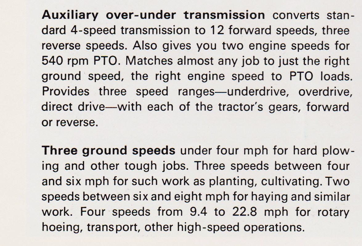

I don't know if this helps but for 1968 3000's there was an over under 12 -speed listed that appears to be based on the 4 speed with direct , over and under drive- Ford 3000 trans options 001.jpg

The above tranny is what I have in my 2000. It made a big difference, but yet not exactly down to a granny speed like I'd have wished for, like to use a 3 pt. tiller. But the OD is awesome for on the road..!!

the problem with pre trannies on a 4spd is that they slow down the pto as well.
the true 8spd twin stick is a decent tiller trans.

Well, slowing the PTO won't do. I think this idea is a bust, at least using the "8 Speed" from that era. I might have to focus on "newer" transmissions, possibly from 1980 and on. That "Dual-Power" was made in 1990 for a 4630 standard....with 16 forward gears, I'm sure that the first 5 gears are under 5mph...but I'll have to do some research at the local New Holland dealer (use to be Ford).
Unless someone can tell me about the newer transmissions.....

Oops- I had to re read your first post and it didn't click that was the same set up.
I tried the SOS for my tiller. - but with the tiller being 85" it was to much for the pto to handle without some slippage so I run it on the other tractor which is geared a little fast for tilling ground but so far it is working.
