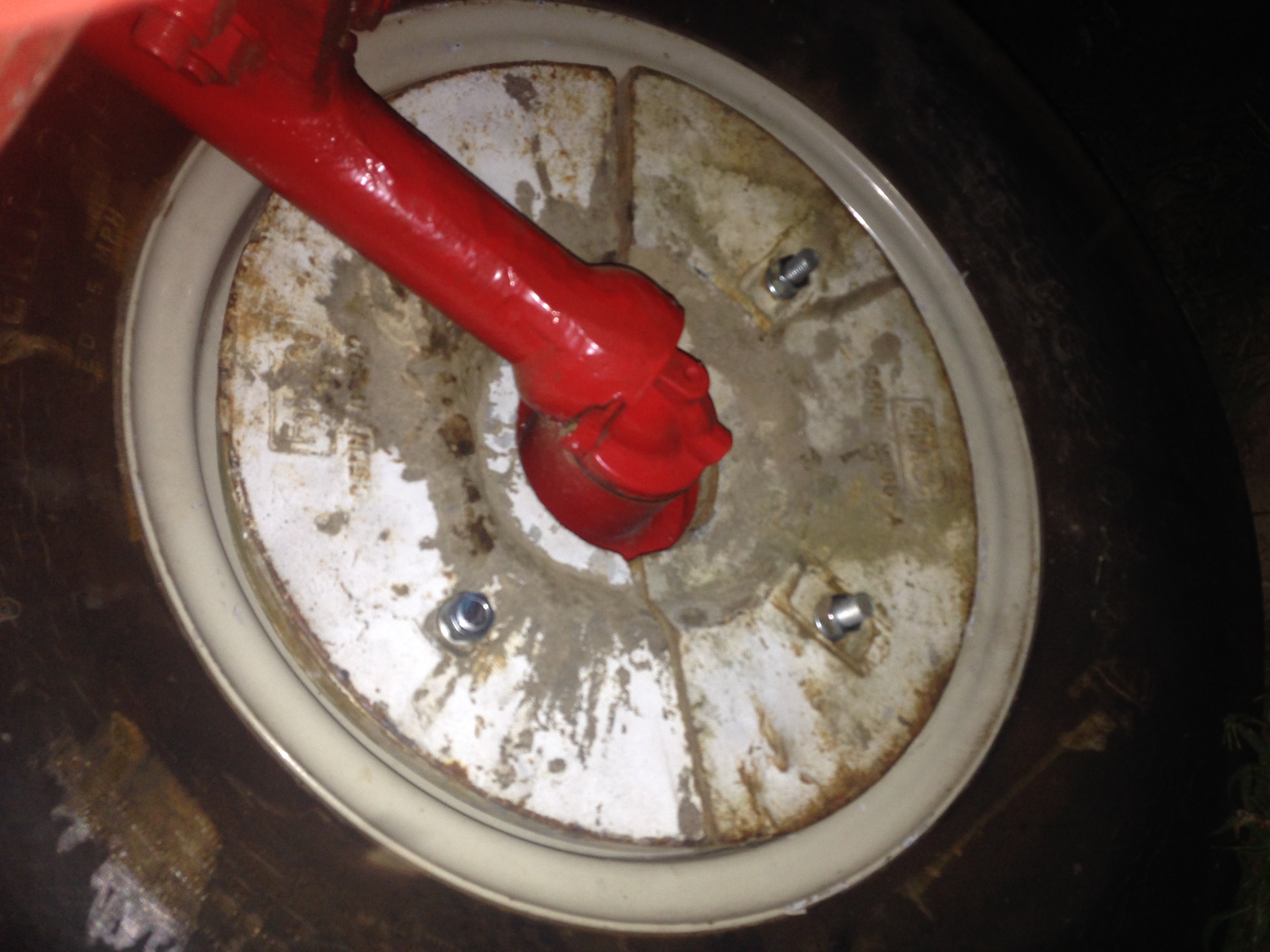

Does anyone on here know where I can find wheel weights for the front of my Ford 801? I am having a hard time trying to find them. Also, would filling the front tires with fluid really add any decent weight if I went that route? Any suggestions or ideas?

I have checked with one older dealer I thought would have them and they did not. I also contacted some local folks with these older tractors and no luck there. I have found aftermarket ones on the internet but they are wanting $190 a piece. My tire man down the road might be my best bet. I do not need a ton of weight so I might just get them filled for now. He said it would be around $125 to do both tires. I am also thinking about making a different grill/bracket to bolt on the front down the road when I get the time. I need to talk with my welder buddy.

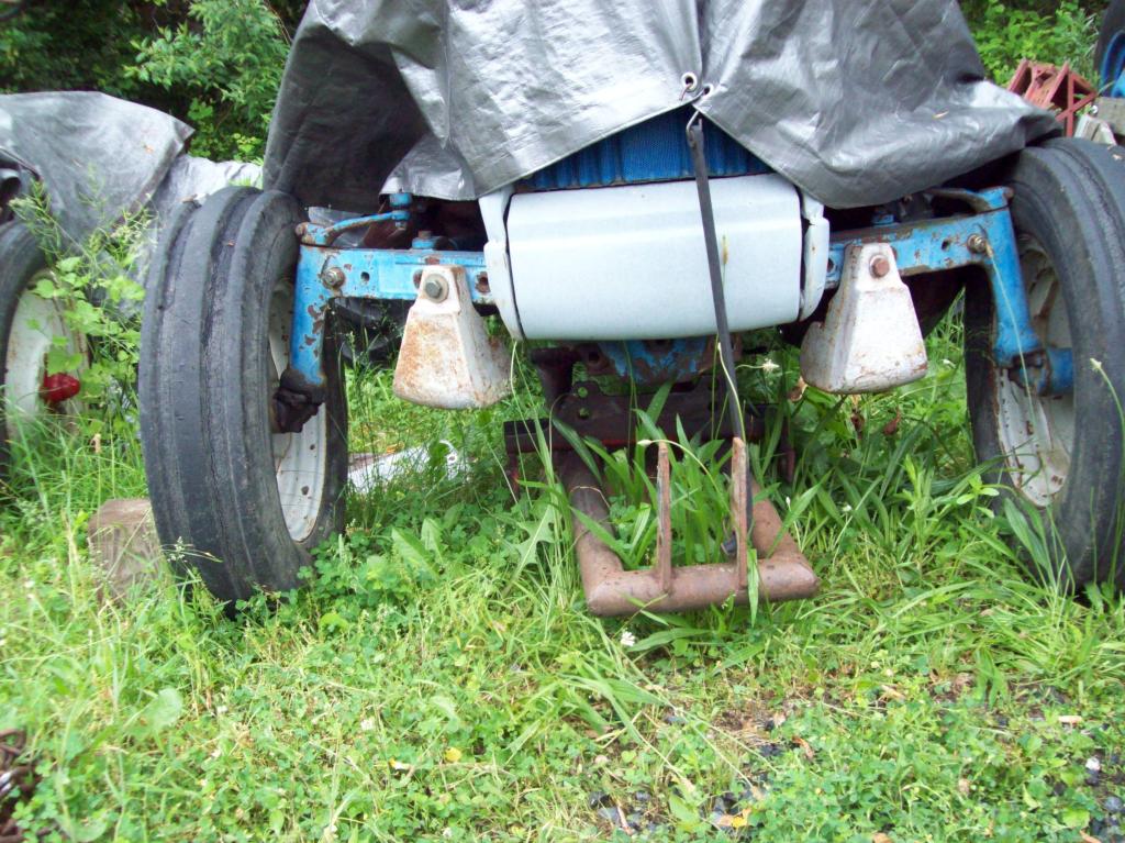

Another option is to hang a couple/few pie weights off the axle. When you have your welder buddy made you up a bumper you might want to consider a bracket from the top of the bumper to the back side of the axle much like the one on my 631. Without it you will have more uneven wear on your axle pin/bushing and axle hole.

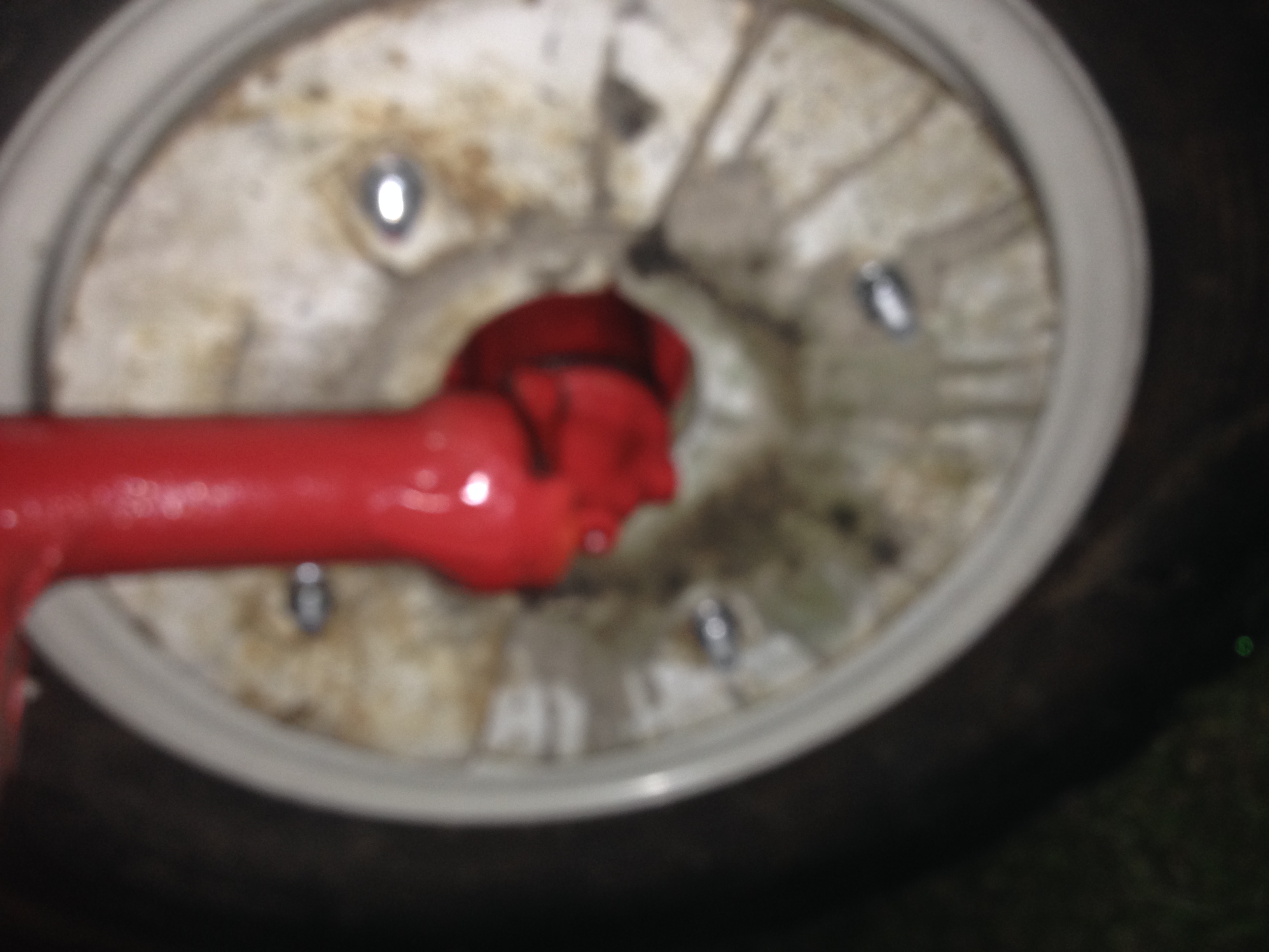

Good News,
I found the half moon weights. I had to drive an hour and a half today to go get them but I got them!!!! Whoo Hoo!!!
I called every friend and friends of friends and every little tractor place I could find. I finally found a New Holland dealership that had a set. He had them sitting out back on a pallet of weeds. I am glad he remembered he had them. Said they had been there for a couple of years. I paid $175 for all of them. Not sure if that was to much money but who knows how long if ever I would find someone with a set that was willing to part with them.
Determination and persistence pays off.
I just got them put on before it got too dark. Tomorrow I am going to finish cutting the ends of the bolts off. I also had the tires filled last week so now I have good front traction to the ground. Thanks for the responses and ideas. I was about to take off two of the rear pie weights and put one on each side of the front of the tractor like KirkNJ had done. That was a really good idea.
