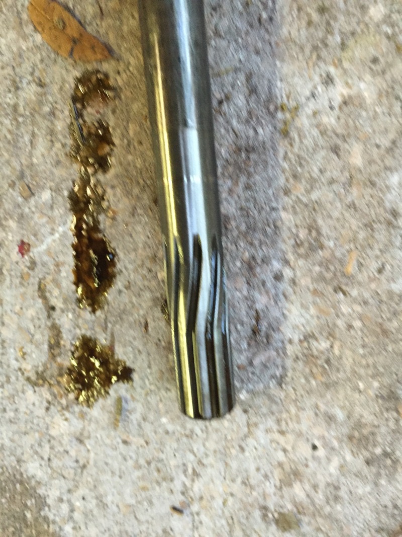

Here's what a twist shaft looks like. Pretty easy to drain fluids and pull your shaft to see if this is your problem.

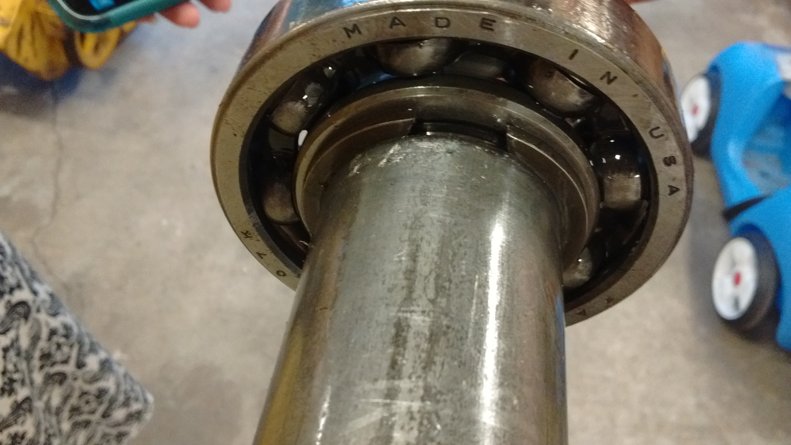

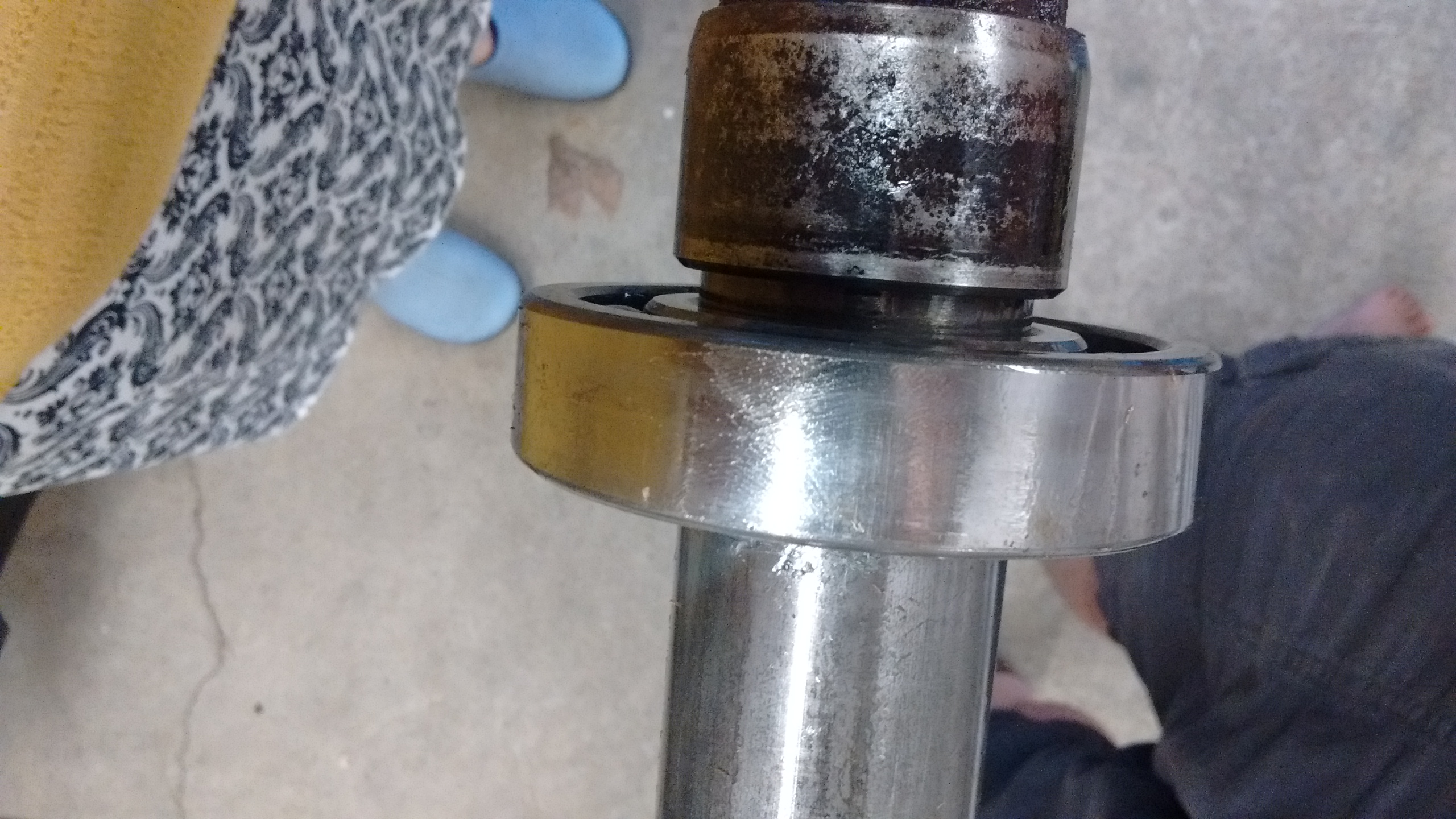

Finally got a bit of time to play with the tractor this evening.
Drained fluids & pulled shaft. It doesn't appear to be visibly twisted, but it seems like it may be missing two snap rings.

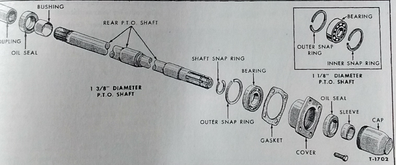

The image here shows starting from the inside of the tractor, a shaft snap ring, and an outer snap ring, then the bearing. The inset image shows another snap ring, on the other side of the bearing.
On mine, from the inside of the tractor I think I just see one snap ring, on the tractor side of the bearing.
Shaft/snap ring/Bearing from the tractor side:
Shaft/no snap ring/bearing from the implement side:
Am I just missing a snap ring on the implement side? Is there a supposed to be a third snap ring 'shaft snap ring' too?
   / Ford 860, PTO Flail Mower disengages pto under load #10
you have the snap ring on the tractor side of the bearing.
ont he other side of the bearing you have the wear ring.. you look to have about 1/4" of thrust play.. sot hat wear ring has moved.. which is common.
the other snap ring is past the seal int he bearing carrier housing.
the inset shows an outter snap ring, which iis also shown in the lower picture.
the big snap rings are int he bearing carrier housing.
