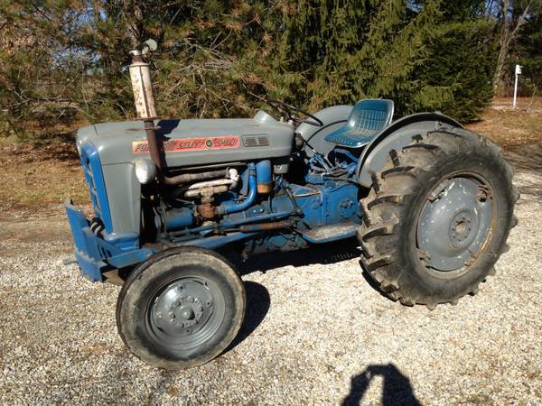

I recently replaced the fuel shutoff valve on my Ford 881. Tractor was running good before, but I noticed the valve was leaking so I replaced it and the leak is stopped.
However, after running ok for a couple days after that, my tractor is starting up fine, but abruptly dies anywhere for 5 seconds to 30 seconds after start-up. I've checked my fuel line for rust, and I have good flow of fuel all the way down to the sediment bowl for sure. I did add an inline fuel filter a couple years ago but again, I've got good flow all the way from the tank to the sediment bowl, so that makes me think it's not a fuel issue.
If that's true, then the other culprits would have to be either air or spark, right? Could it be time for new spark plugs?

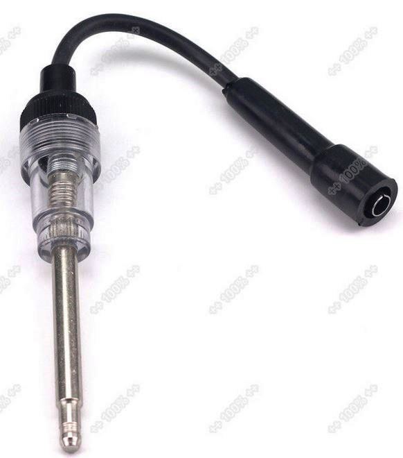

Thanks. I'll have to get an assistant to help because it doesn't run long enough for me to jump off and get to the spark plug wire. So if we have spark, does that point then to the condenser?
You could use a spark tester to verify spark from the operator position.
If you are loosing spark, the condenser is your prime suspect. If you have an analog VOM, you can test the condenser as follows:
1. Discharge the condenser by disconnecting the lead and shorting it to the condenser case.
2. Using an analog Volt Ohm Meter; select X1 on the ohm scale.
3. Connect one VOM lead to condenser wire and touch other VOM lead to condenser body.
4. If the condenser is good, the meter should swing from 0 ohms to infinity as the VOM charges the condenser.
