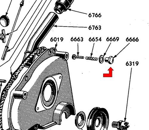

I got a Ford 8n few months back with a supposedly rebuilt engine within a year before I got it. I didn’t notice it had no oil pressure at the gauge until I had already brought it home. I did the ole “crack the line and see if oil comes out at the gauge” test. Oil came shooting out of the end and so I assumed it was the gauge. Bought a new gauge for it and finally installed it today. Still no oil pressure showing. So I looked it up. Supposedly air in the lines will cause it to show no pressure. So bled it until oil came out and then tightened the bolt and took it up to full throttle and still have no visible oil pressure… so what next?

The Ford 8N is know (well know) for what we today think of as low oil pressure, fact is the old engines will run for YEARS with as little as 5 lbs. of pressure. As long as you show some pressure on the gauge at high idle you'll be fine. You can put 10W40 in it to make it show a bit more pressure if it makes you feel better.

I’m sure you solved this sue by now, but the 8N has a pressure relief valve in the front of the engine above the crankshaft pulley. If the engine sits, sometimes the oil pump looses its prime and you have no oil pressure.
Take out the bolt and you will find a spring loaded rod. Attach a tube to a quart of oil, insert it in the hole and inject 5-6 oz. Replace the bolt, valve and spring. Start her up and see if that works as it should prime the pump.
