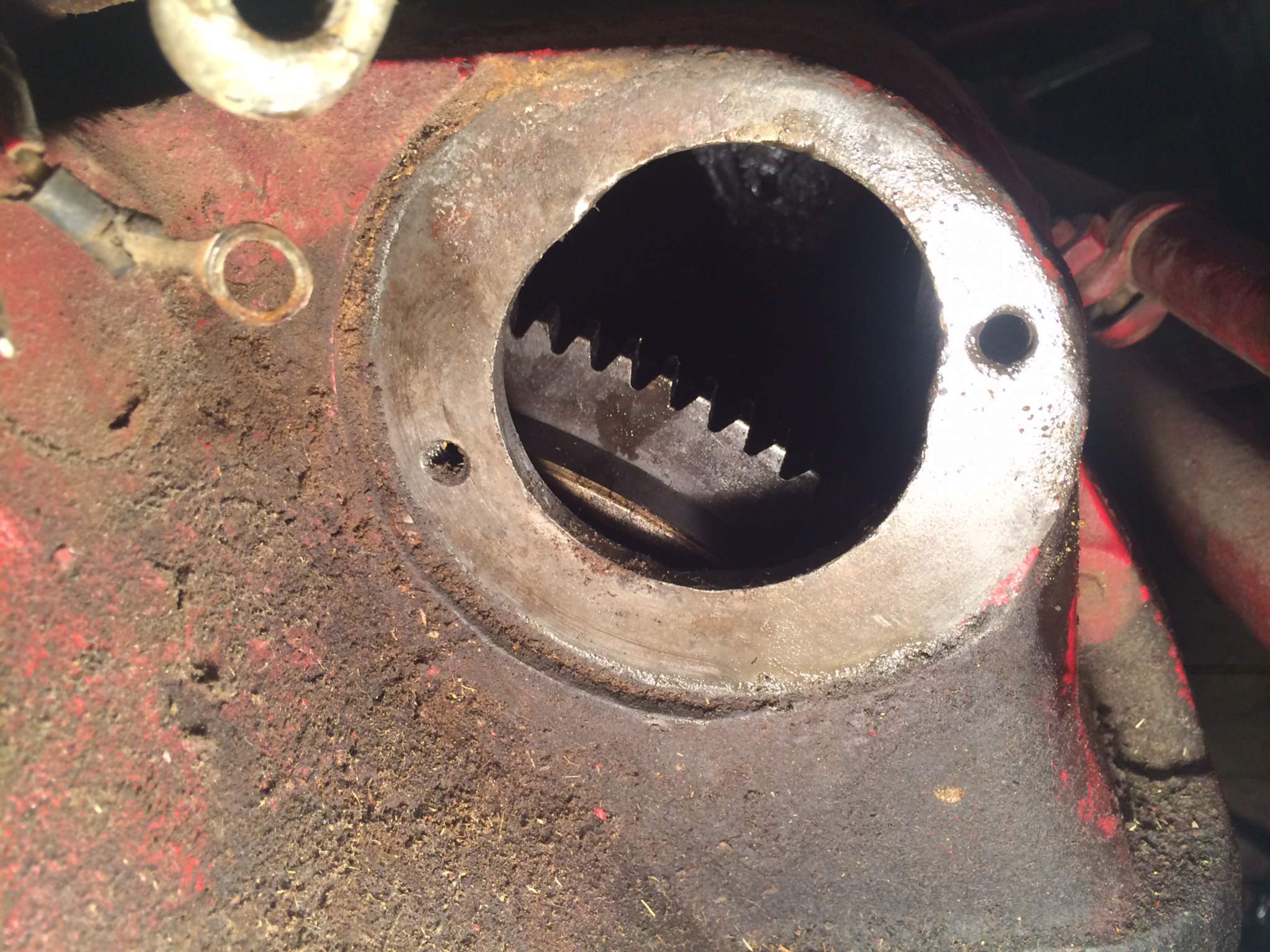

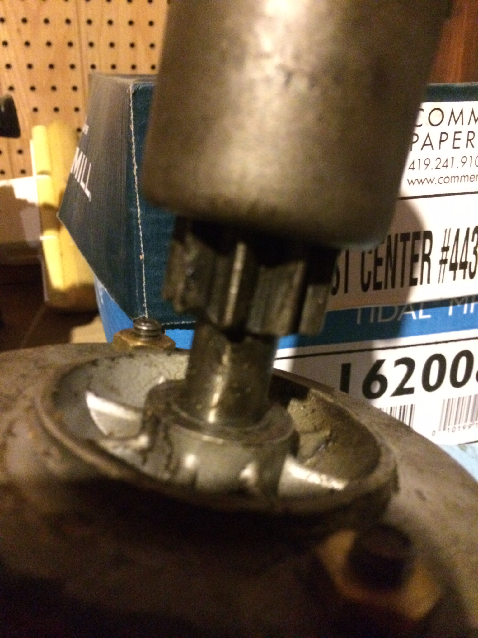

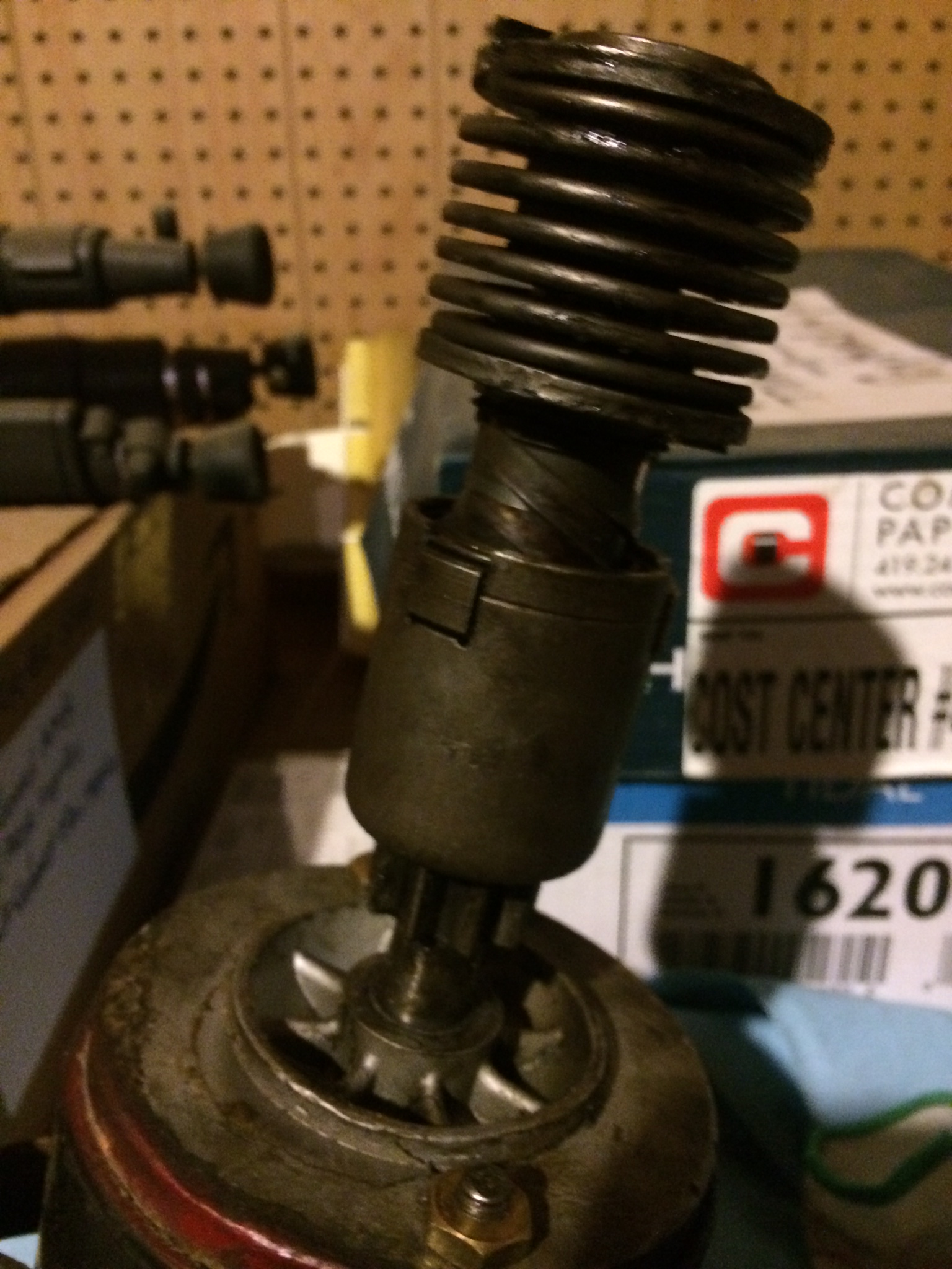

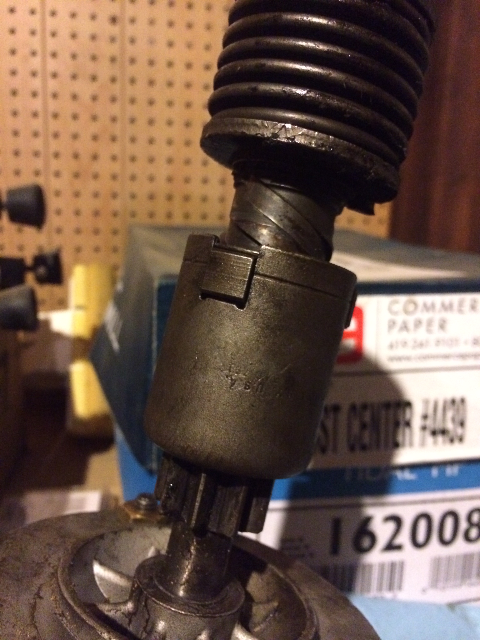

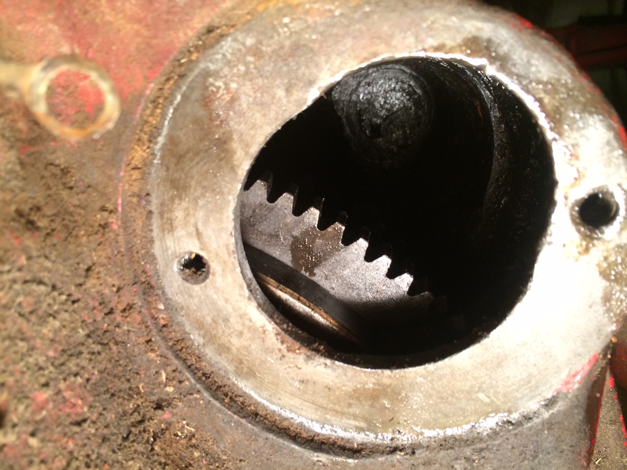

I was able to successfully remove the starter. Had to remove the oil filter canister in the process, but it came out. I have not had time to clean it or to test it, but here are some pictures of the starter, the drive gear assembly and the ring gear. Do there appear to be any problems?

well.. it's partially engages right now. if not hitting hte good teeth.. then it's sticking. depressing the washer on the spring at the end lets you drift out a pin and slide the drive gear off.
PS.. for those that are not familiar, this ford uses a start relay. not a flip out eloenoid... I saw it asked... this should clear it up.
   / Ford 8N Starter motor not working-High pitched wine, engine won't turn over. #10
When you look at the ring gear through the starter hole, you a are looking at the unused side of the ring gear. The starter actually engages from the back side. To check for wear, you can carefully feel the back of the teeth(watch for steel shards and sharp edges) or just use a mirror and light. Rotate the engine with a screwdriver or small pry bar to see the whole gear. Use a piece of chalk to mark the flywheel so you know when you've gone all the way around.
