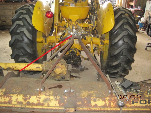

Pretty old piece of equipment obtained at consignment auction years back. Used to mow down garden stubble/corn stalks and then mow down tall grass on flat 4-5 acre spot. Years back Russian Olive scrub started and hard to keep shots down and mower with heavy tines does well.
Since I am an amateur, pto shaft given to me was in horrible shape and wobbled badly to the point cracked the gear box mounting a few times. When universal joints were destroyed I had one fabricated by the shaft pros (Fleet Pride) and it cut vibration down to zero.

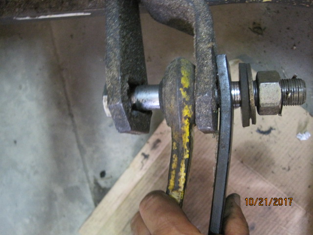

Now the current problem is that the sway bars are bending like pretzels. Should the bars attaching to the pin under the axels be snug or can there be a bit of wobble? (I will provide pictures) Where they attach to the 3 point lift arms should they be tight with no wobble also.
Or am I causing the problem by mowing when making a sweeping turn? Ssisnce the grass and groth is so thick I am cutting as high as I can.
What am I doing wrong?

My lower lift arms have the check chains like you have. Have three flails and have never ran the flat bars on the outside that you are using. Lower link has balls on both ends so what is behind you will move in a turn. Not sure why you are using the flat pieces. If you think the pto shaft is going to come apart-it is to short. Mow with the back roller on the ground and attack high and heavy with a slower ground speed. By looking at your pictures - Your drive shaft is crooked. Your mower is designed to be off set. Gear box and tractor PTO should be in line. Change The mounts on the mower after you line the tractor up with the gear box, you have it mounted wrong. It looks as if the top link brackets both front and rear bars have been changed.
/ Ford 918 H Flaier/Mower Problem #3
I have a 918h also. Mine is mounted closer to "centered" behind my machine, though there are additional mounting holes to offset if desired. My PTO and gearbox are not directly in line with the PTO output shaft on my tractor, and i never get any wobble, unless i raise the 3pt all the way up AND pull in my top link all the way (i have a hydraulic top link). So... I don't think that having the gearbox offset is your problem.
I also don't have or use those flat bars... But my tractor has positional stabilizer bars instead of chains, so i can dial my in.
If you're getting wobble while the unit is at ground level, it will likely be either: A) the mowers PTO shaft is bent. B) the tractors PTO output shaft is bent. C) the gearboxes PTO input shaft is bent. D) the gearbox bearings are bad.

The original three point hitch was apparently damaged, discarded and replaced by the one on the flail mower now and they did not pay attention to mounting it correctly after the first three point hitch was damaged and discarded.
A flail mower does not need stay bars to work properly, an old corn planter or in row cultivator does.

I'll 2nd or 3rd that. Definately looks like they patched something together for the auction.
Those sway bars are a joke. They have no strength in compression. If you swapped them out for chains with a turnbuckle to tighten them, they would work a lot better pulling against each other in tension through the implement. Actually, if you just put turnbuckles on that bar & tightened them it would put it in tension & actually keep things reasonably tight. I tend to keep my sway links a bit tighter so things aren't flopping around in back. You can run things relatively fine without any sway links at all, pulling intrinsically will try & center anything on a 3pt. I don't like things flopping around to much though.
My old beat to **** Ford 917 flail has the gear box mounted in the center, along with every other old Ford I can recall seeing. So it being mounted off to the side is very strange. Not the end of the world as the 3pt lifts/lowers changing the angle of the PTO shaft all the time. But the more angle you run on a PTO shaft, the shorter the lifespan (it's also exponentially shorter, not a linear falloff).
I paid $100 a few years ago for my old beat to **** 7' 971. I've got around $600 into it total now & it's getting close to being retired. Good mower, just really old & beatup. When I got it it had a bent hood (torched out parts that were getting hit by knives & patched those), missing PTO shaft. Put a new PTO, belts & set of knives on it. Gearbox seals started leaking pretty good so I put grease in it instead of $80 of new seals. $80ish for new rotor bearings that blew last summer. It's still running good, but the ancient crack through half the hood is noisy & annoying, rotor has more dings in it than you can flail a pile of rocks at. It doesn't vibrate bad though. I'd think about refurbing it again, but at some point you are just putting good money after bad. At this point I'm likely to just run it until it dies if I don't replace it first, at which point i'll keep it as a spare.
If you have the PTO issues sorted out & it isn't vibrating to bad, I'd probably run it until it died. But I wouldn't put much money into it. Just make sure that there is plenty of float for the toplink when mowing (you could even just disconnect the toplink when mowing to let it float properly).

Not familiar with that flail mower and this is just a thought. It almost looks like the a-frame that is just next to the gear box should be mounted to the frame bracket farther left (viewing from behind). That looks like it would center the gear box as Fallon pointed out.

I never even noticed the offset. I can't believe it runs vibration free.

Shouldn't the check chains from the center of the tractor to the lower links be snug? The steel straps that are bending look like a kludge.

Normally, there are floating links on the mower. As someone mentioned, this is a kludge. So, since the top link is firmly attached, if a bump or contour pushes up on the rear trailing roller, the two arms will be forced down!
Back in the 80s, I had my first 917 and could not figure out why it scalped the top of a burm going up and down! Intuitively, it would seem that when the tractor front wheels go down, the mower would go up. I built a small model with all the correct pivot points and wheels. I was surprised to find, that on account of the extra pivot point of the 917 attachment arms, the opposite was in fact true. As I came over the burm and the tractor wheels when down onto even ground, the mower would go down and scalp. Same thing descending the grade.
Either re-establish those floating arms, or make some sort of folding 3rd link that the mower can't push against.

Flatbar stabilizers were used on Ford tractors for years. It is impossible to bend them if properly attached. To compress one side the other side must stretch. If, when they are attached to an implement, both are tight, no compression is allowed.
I don't think you can get that scenario on an implement with flexible attaching points such as this Flail. So you will rely on the chains to control sway. I run my 917 rigid behind the tractor with no side to side movement.
As to the offset. Is it possible the 3pt tower is bolted to the mower in the wrong place for your application? Are there a set of tabs not being used that would move the gearbox to a more centered location of your tractor?
My 917 mows offset to the tractor, protruding out to the right side. But the gearbox is centered in regards to the tractor.

After looking at the pics again I would also add, the stabilizer should ALWAYS be pinned next to the 3pt arm. By having them pinned on outside the flail tabs you create a lot of distance between the 3pt links and the stabilizer. This is how you are getting the "slop" to allow compression.

Is your flail centered behind your tractor? It looks like it, but it shouldn't be. Just look at mine behind my old L3200 (complete with bits torched out while patching. Not anywhere near centered. Most flails stick out a lot more on the right side so you can get close to obstacles on that side.
You can also barely see the lift links on the 3pt mount on the mower. The lift arms can move up & down 6" or more to let the mower follow the ground as you go.IMG_20150613_203410.jpgIMG_20150506_175257.jpg
/ Ford 918 H Flaier/Mower Problem #15
That's why I mentioned the tower. I think it's been moved to center the mower behind the tractor
