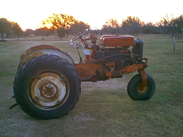

Update...
have been fixing leaks and neating up wireing and replacing broken fasteners.. etc. had to drill out a broken bolt inthe front pedistal, and replace a few small parts.. belts.. etc.
found some tinwork on ebay ( machine used to be LPG, but was converted to gas.. thus old tinwork was discarded. ). Might have to fudge the tin as it came from a 900 not a 901.. alldepends on if my gas tank is from a 900 or a 901.
I need to weld up a new steering arm, and then I'm ready to chase a few more leaks.. past that.. I'll be ready to prime the chassie soon. Probably get to the steering arm tomorrow.
Unit came with a ford 711 1-arm trip loader ( basket case ). i can't wait to stat playing with that... will be my 3rd 1-arm loader..
soundguy

Soundguy, Nice picture looks like a fun project. I'd be afraid to run that around my property it's pretty hilly. I do like the old iron.

Good progress. You work a lot faster than I do.
I'm anxious to hear your comments on the ride you get out of a tricycle tractor like yours. I'm looking at a tricycle Allis Chalmers WD and can't decide whether to make an offer. Don't particularly like the tricycle arrangement (possibly tippy). Prefer wide fronts.
   / ford 951, my next victom
I have a JD-B already.. narrow front ( 2 wheels ).. this ford 951 drove about the same with it's single front wheel. It's higher up.. but don't feel tippy.. even when I trailered it..
soundguy
   / ford 951, my next victom #8
I have an A-C WD-45. I take that all thru the woods, hillsides, wherever. Just keep the speed reasonable and watch for big rocks under the uphill reat tire and you'll be fine. I prefer a tricycle in the woods, I can go about anywhere an ATV can go.
   / ford 951, my next victom #9
I really like the trikes in the woods also. They are easier to manuver with steering brakes (can do a 360 in place) and the forward visibility (stumps, etc) is a lot better. I don't think they can legally be made any more for liability reasons concerning stability, although there is a fella on this site who swears they are more stable than wide front tractors. I think he is dead wrong for the following reason: If a hollowed out ground-hog home collapses under one of your rears, there is nothing to stop the trike from flipping over. If this happened on a wide front tractor, the front would drop down, but the rear would hold the tractor up. This makes trikes a particularly bad choice for work in hayfields or pastures where these furry creatures live. I still think the trikes have thier place, for cultivating and woods work, but they are definitely not for inexperienced operators. The Allis WD is a heck of a tractor, I own its little brother trike, the C, and have often ran my uncles WD. That 951 probably has some serious value due to its rarity, but I would keep it out of the pasture.
