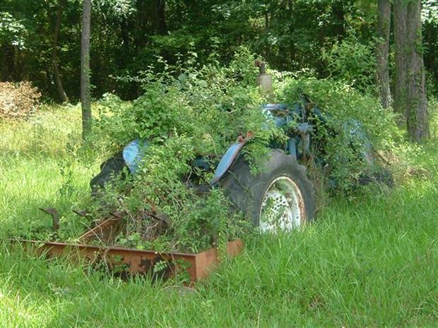

I have been looking at this tractor for over two years. I have talked to neighbors, left messages taped to mailbox and cruised the strip trying to catch someone home. No success.
Does anyone recognize the year, model?? And I know that the pictures are poor (telephoto lens through a 6' cyclone fence) but it is as close as I can get without being shot at.
I realize it's very neglected but I wouldn't mind restoring it to it's original condition. Any help greatly appreciated.
Regards, Mark

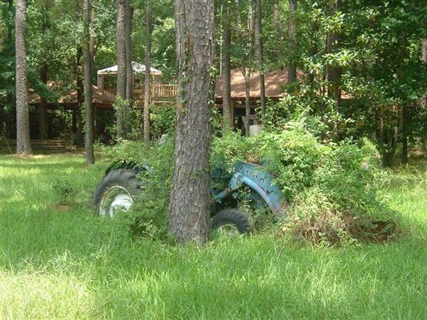

Another angle but not much better.

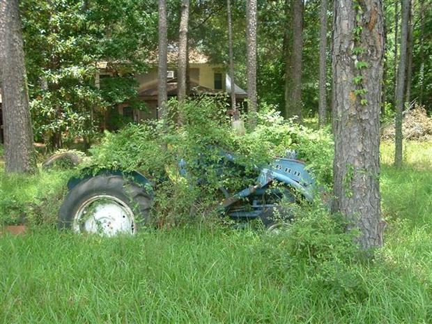

Last one....probably no help at all. Thanks for any advice...or best guesses.
Mark

That tractor has blue rear fenders, plus it has old style pan fenders. The tractor has white wheels. It appears that the hood is blue. The loader appears to be an OEM style loader, and as it is not an old style tube steel loader that helps too. I'd suggest the tractor is something like a 2000 or 4000 series tractor, probably from the late 1960's through the mid 1970s based on what I can see. Early and mid 1960's had white rear fenders. Later production tractors didn't have the simple pan fenders. The loader helps date at date it to at least that time period also. The problem is to really make a positive ID we'd need ot see more!
   / FORD Help..maybe #5
I agree with Bob. A 2000 or 3000; probably 65 to 68 vintage. The muffler in the third photo and the starter on the right side of the block visible in the second photo are the tipoffs. Never saw blue fenders on that vintage, but paint is cheap. Not familiar with that loader, but there is a lot of stuff out there I don't know about.
   / FORD Help..maybe #6
Rick, good catch on the starter, I missed that completely.
I discount the vertical stack muffler for dating the tractor, it looks like an automotive muffler and I've seen a lot of retrofits where horizontal mufflers were converted to vertical (even did that because I like the look).
