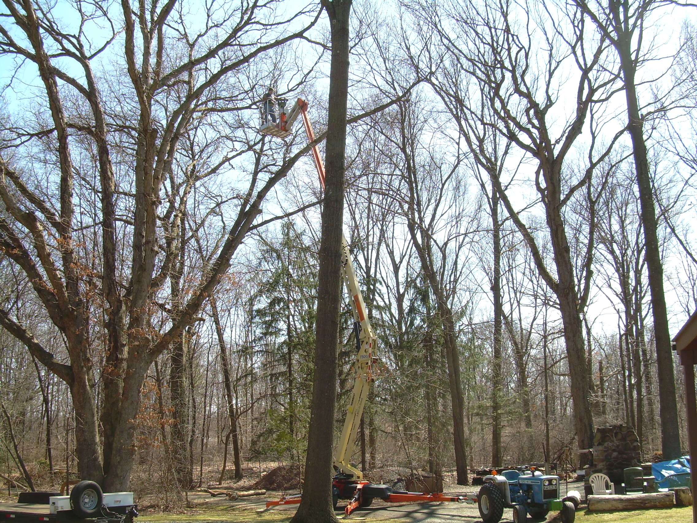

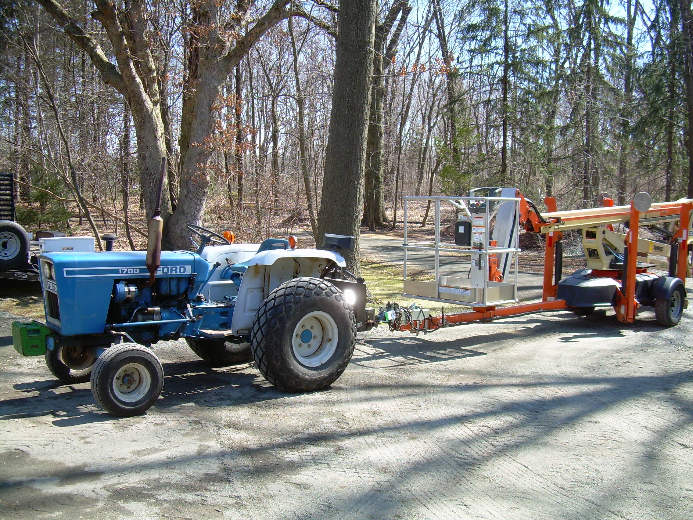

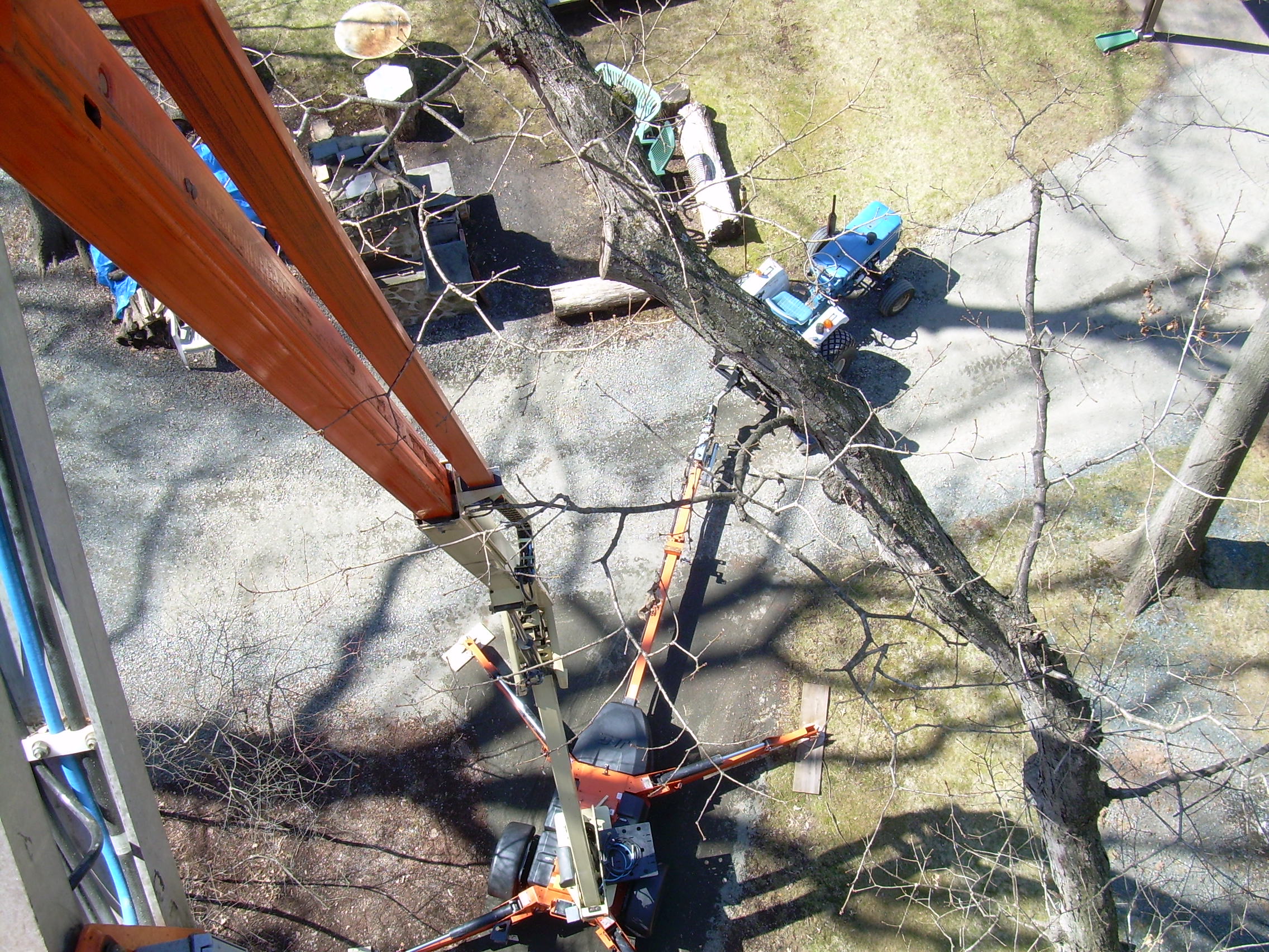

Thanks again JC, that "Testing my patience" thread looks like it would be very helpful if I ever stop procrastinating and change that seal and make necessary adjustments.
1700 came in handy yesterday pulling tow behind boom lift, the thing weighs over 6000 lbs. It tows fine on the road but is very long so it would be difficult to move around the yard with a truck. the added benefit was when coupled to truck you must unhitch it to raise and level it with the outriggers, with the free floating 3pt no need to unhitch it, makes it much more portable :)

Wow John,
it's way up there in the middle picture. I'm glad you got good outriggers there. I bet you it's shaky up there. I'm glad your putting your 1700 to good use all the time. Great pics.
