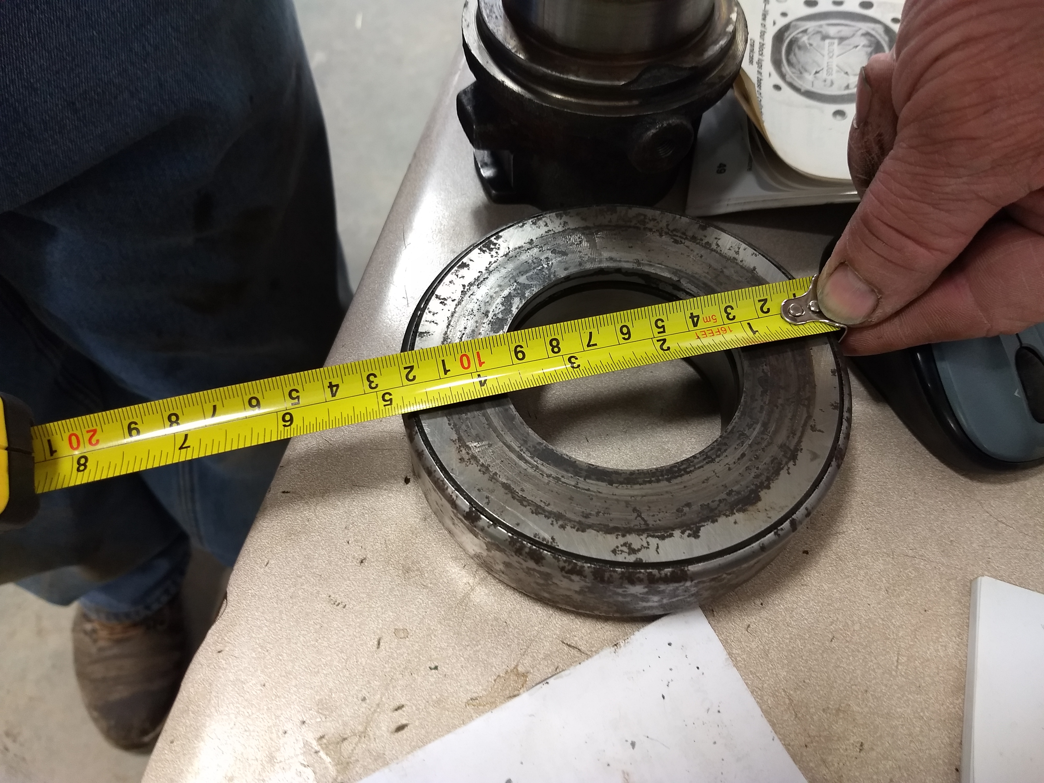

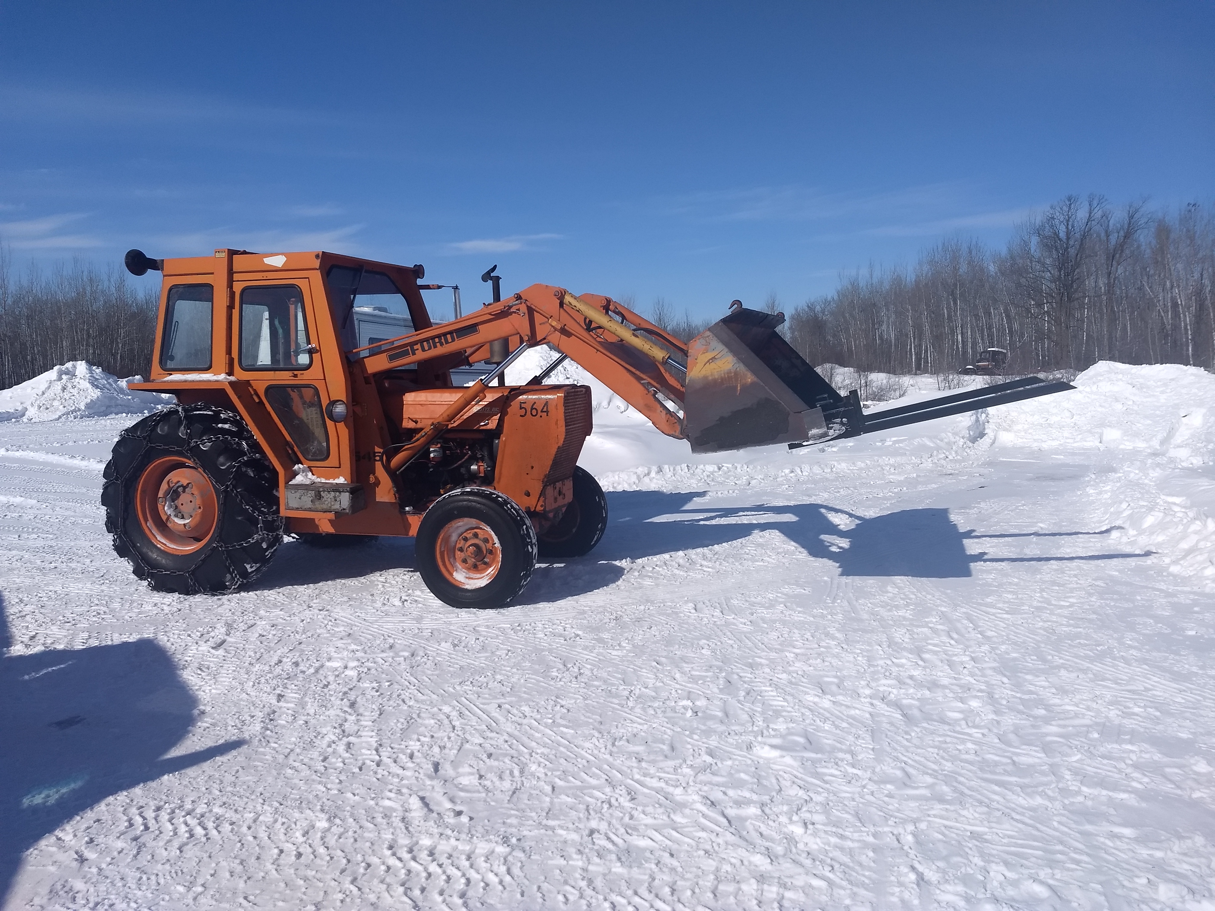

Hello fellas, I have a dilemma. I recently acquired a Ford 545 Industrial Tractor. And of course the previous owner failed to tell me the clutch was out of it or going out of it.
It is in the shop now being repaired the clutch and everything's put back together however we are having a problem finding the throw out bearing or clutch release bearing. Everywhere we search or have a part shipped to us there's a wrong one.

Probably a 26794670, BALL BEARING,65mm ID x 120mm OD x 23mm W
EDIT: When I search that actual part number it seems to come up as an open type axle bearing of some sort. Try calling Alma Tractor at 866-441-8193 and see if the parts guys there can sort it out for you.
