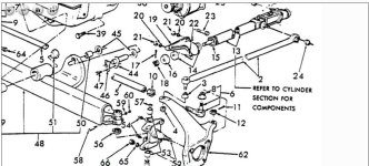

Hi, I have a 75 Ford 420 industrial with very sloppy steering. The Tie rod ends are both worn, but I have found replacement parts for these for a reasonable price.
The joint that is the most worn is #2 is this diagram. It is probably ready to pop apart its so worn. To replace you have to replace the whole connecting link which is near $500!!
I was thinking I could just cut the joint off the end and thread the rod for a universal tie rod end or weld a universal tie rod end into this link. I dont know if the link is hollow or solid.
Has anyone else come up with a solution for this problem? I think I read a thread on here that referenced it, but I cannot find it.
Thanks in advance
-Dana

Cut and weld works for me and my customers . They are very happy with the savings !
   / Ford Industrial Steering Arm Ball joint
Is that link hollow inside? Seems like it would be nice to get one with male threads that could insert snugly inside the link and maybe I could do a couple plug welds and seam weld the outside.
What kind of ball joint are you using to weld to the shaft?
   / Ford Industrial Steering Arm Ball joint #4
Iam talking in general . You will have to match the tapper and then it will be a cut to get the right lenth and then welding MIG welding
I have a really nice 220 miller mig, I'll just measure up the taper and order one up! Thanks! $500 for a tie rod end is something I couldn't swallow.
