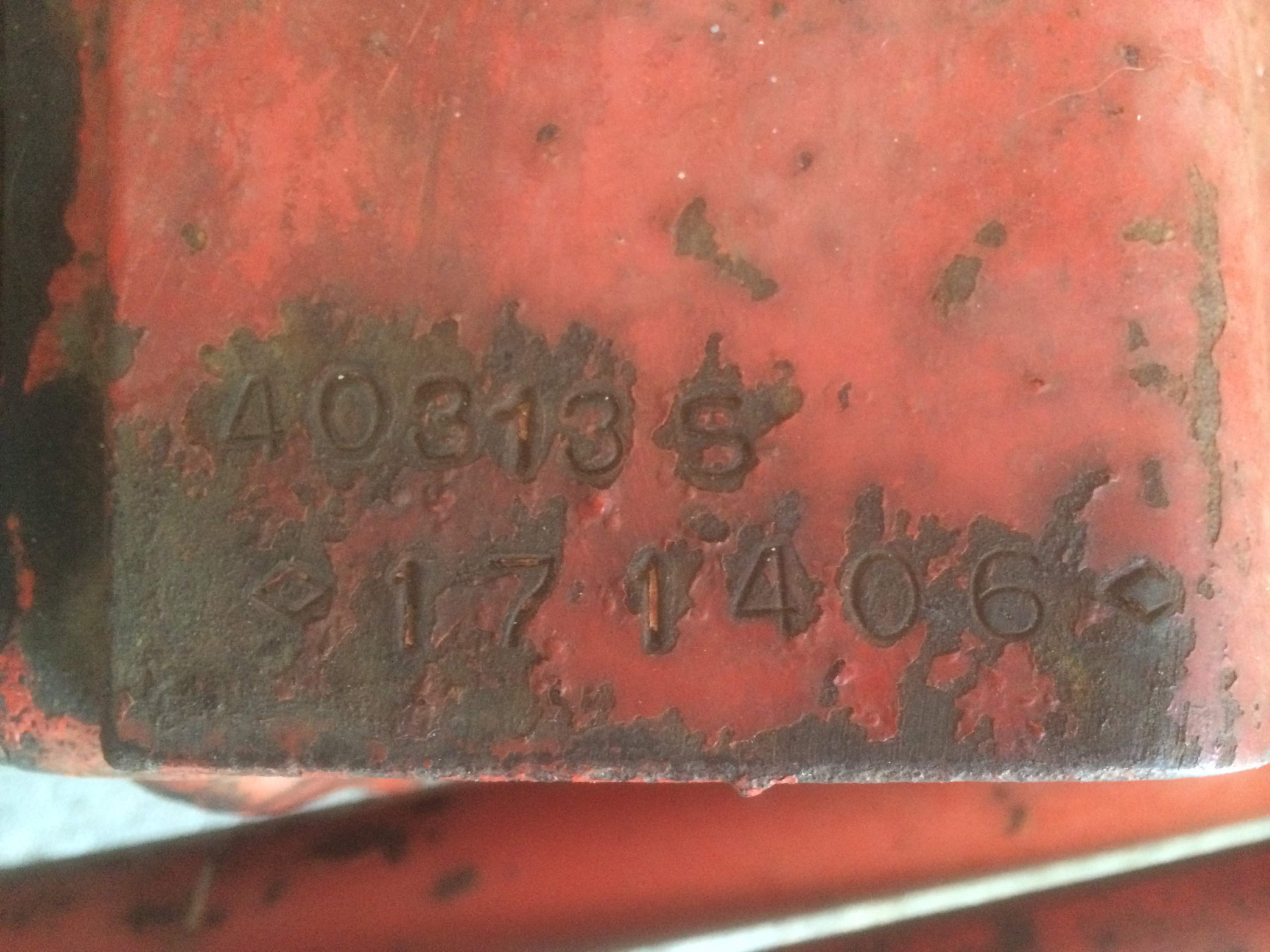

Hi, I've been working on cleaning up the old Ford. trying to figure out what it is.
Model # 403136 4= 172ci gas / 0 = industrial 31= LCG 36 = ??? Not sure? The
tranny is 3 speed with high / low?
Also I'm not sure of the year serial# <> 174406 <> 1963??

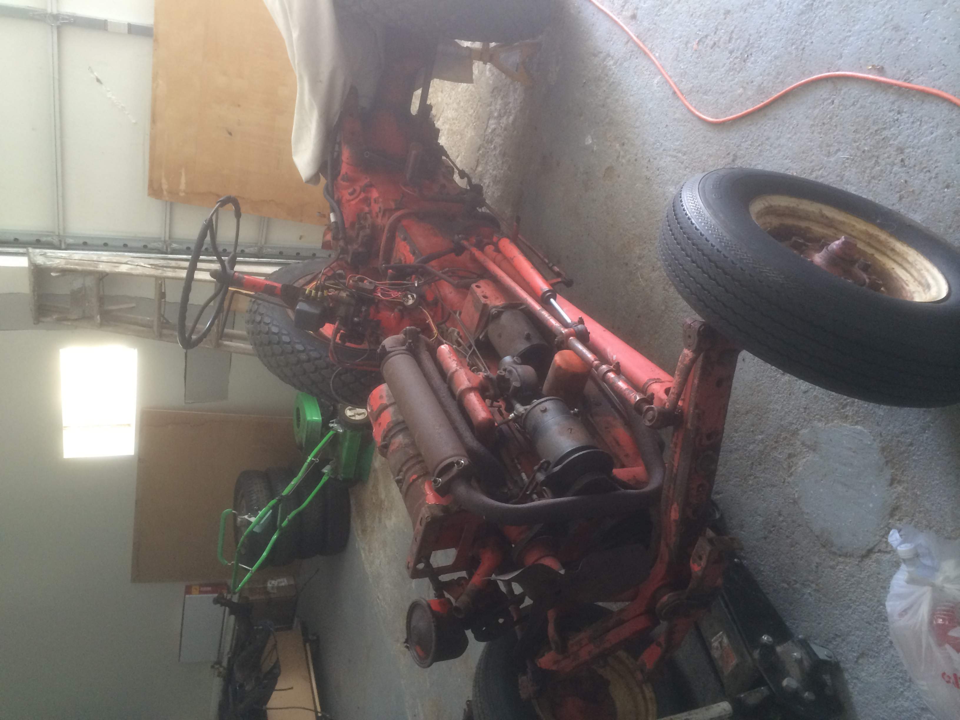

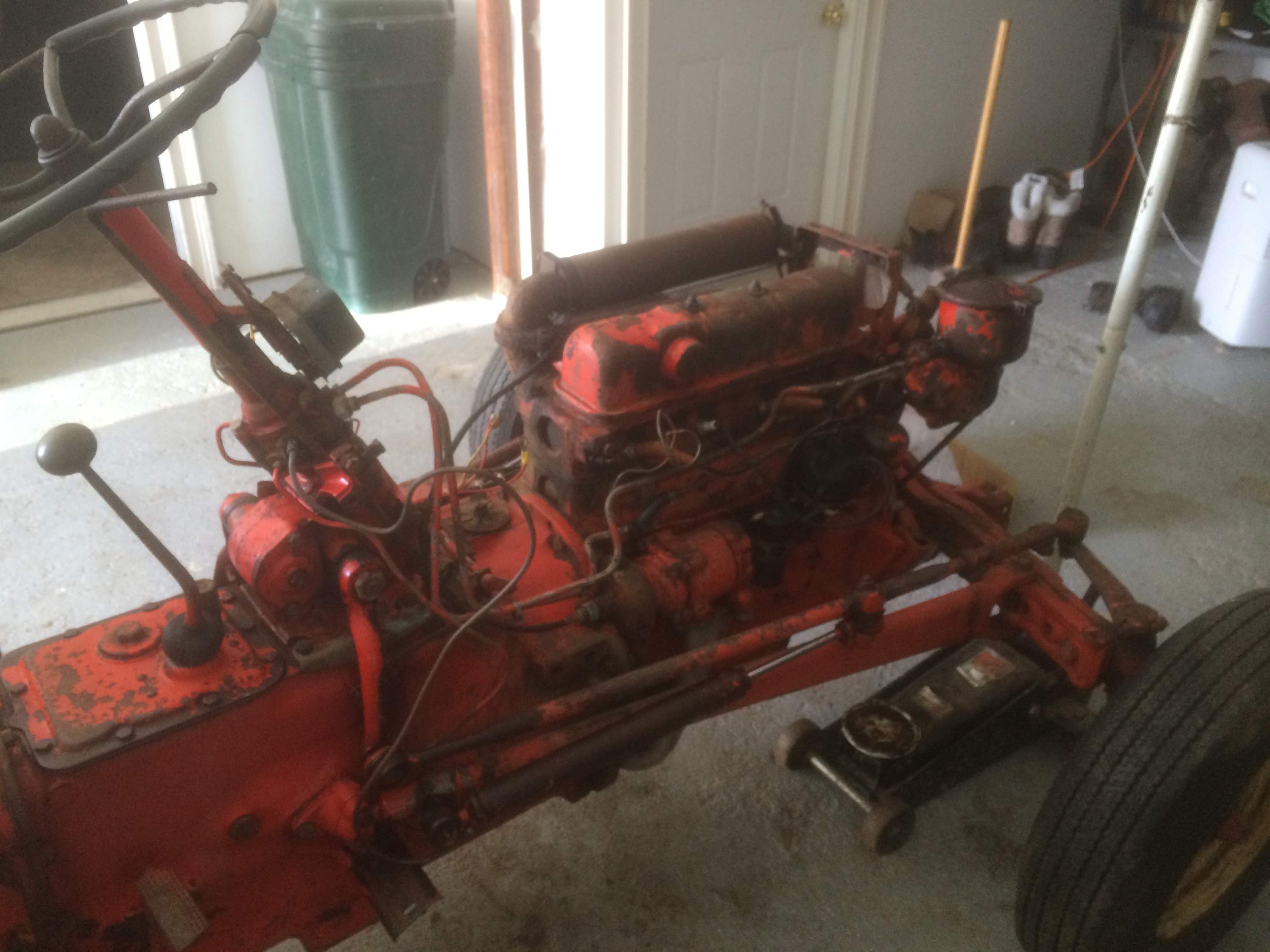

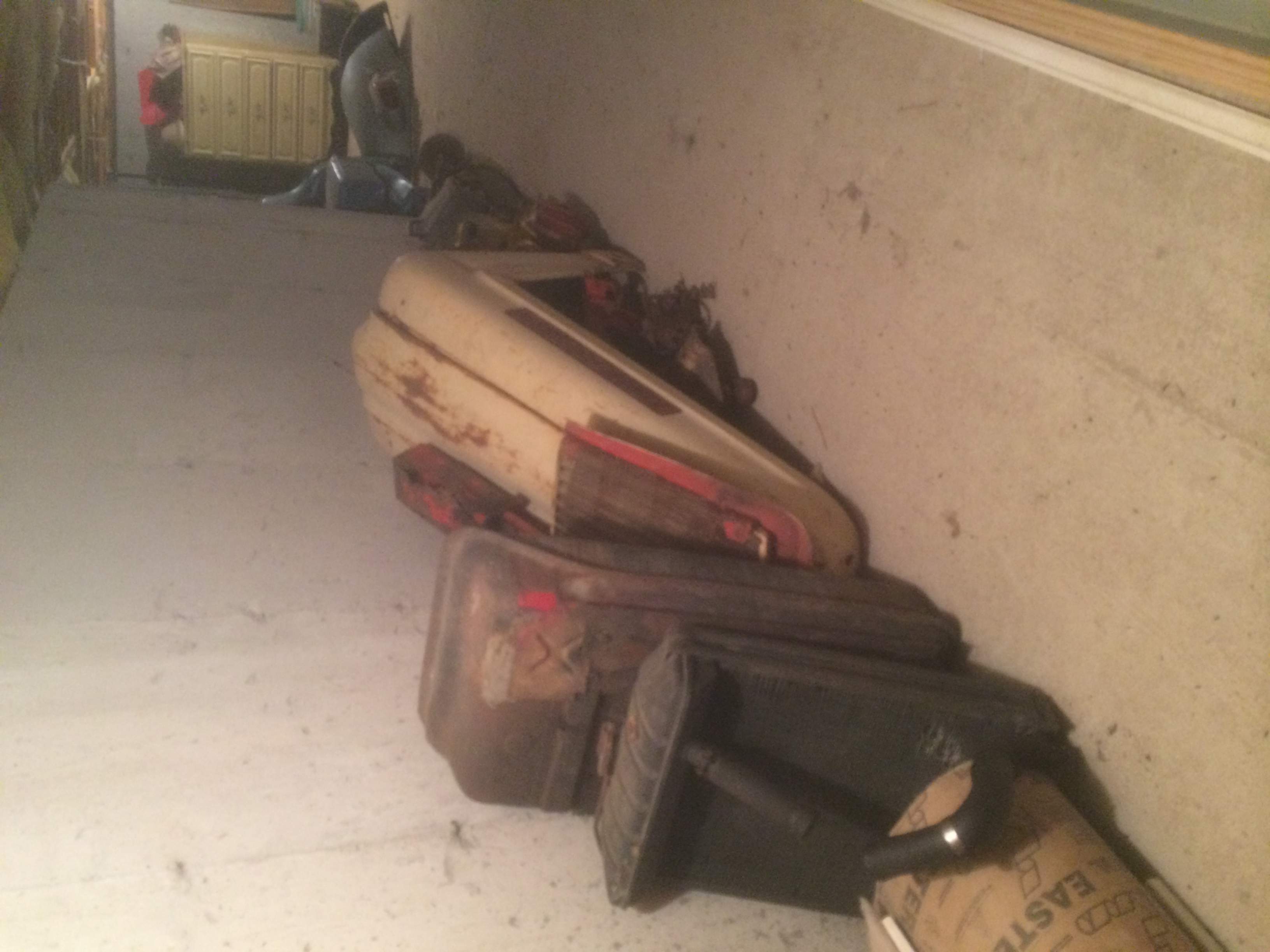

Hi, I only have a few pictures off my phone. Don't know if you can see much. It also has power steering.
I have the snow plow and flail mower also. Not sure if the pictures will show up? I'll try again later when I have
time.

Interesting tractor. Hopefully someone more knowledgeable than me can figure out what you have. But it is possible that you have a tractor that has parts from more than 1 different model. It wasnt uncommon back then and alot of parts were interchangeable from different models.
Any chance you can post a picture of the model number and serial number so we can verify?
I am gonna guess it is a 1962 model industrial tractor. They where the first tractors of the thousand series (2000,4000). And The color is correct if thats what it is. They were red and yellow. But a few things that throw me, The last 36 on the model number. Not sure what the 6 means, I cannot find any reference to it anywhere, but the 3 indicates 4-speed trans w/hydraulics and PTO. Yet you say it is only a 3 speed trans.
I could be wrong, but I thought the 9n/2n were the last to have a 3-speed. Everything after that was 4-speed or 5-speed or SOS. So either I am wrong, or you are wrong about the 3-speed, or (if possible) someone put a 9n/2n trans in there.
The last thing that throws me is the adjustable front axle. I thought all the industrial tractors had a fixed width front. So either I am wrong again, or the axle is from a different model.
Like I said, The tractors from the 50's and 60's had alot of parts in common among different models

clearly not a 9n/2n trans as they incorporate the steering box. the 3 cyl thousand series also had a 3spd box, but was a twin stick with high low, making it 6spds.
the 3spd issue is why i asked him to post a pic. hard to id a tractor for somebody when they don't know how many gears it has and guess wrong. ;)

i would go with a 62 as year as well
and that is deffinately a 4spd tranny, not 3.
also, that last 6, is it really a 6 or a letter. there are suffix that are different options.

Sorry, I think you guys are right and its a 4 speed with the high / low lever. This was my Great Uncles machine. It was
from a country club where he used to work. The 4 cylinder kinda threw me. I have a picture of the #'s Thanks for all the help
I disasembled this for paint then the house burnt down and now I'm back to it agian. I read somewhere the first 2000 were red and yellow.
I want to find the correct yellow I think the red paint should be EZ emough to find? Thanks again Tony

Sorry, I have to learn to read. The lable on the side of the hood reads 4000 LCG guess I'm getting old??? can't remember nothing.
