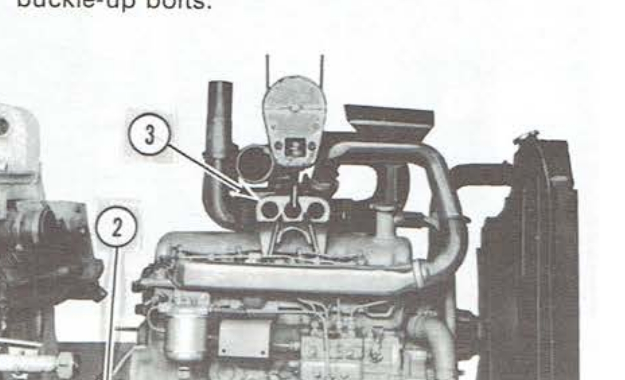

Anyone have any information on the Ford Lifting Fixture Tool No. 6011 (aka, Churchill tool RE 140)? A picture maybe?
The service manual for my backhoe calls for using this for engine removal. The pictures in the manual are not very clear on what it looks like. I can't find any information on it.
Preety sure I won't be able to find the tool but would be nice to know kinda what it looked like.
   / Ford Lifting Fixture Tool No. 6011 #2
I probably found the same difficult to find picture that you have, looks like a three position lifting plate that mounts to two head bolts. (#3 in the pic.)
If you could find one, it would probably be more expensive and not work as well as this HF load leveler, they are the real deal when it comes to slinging engines around.
