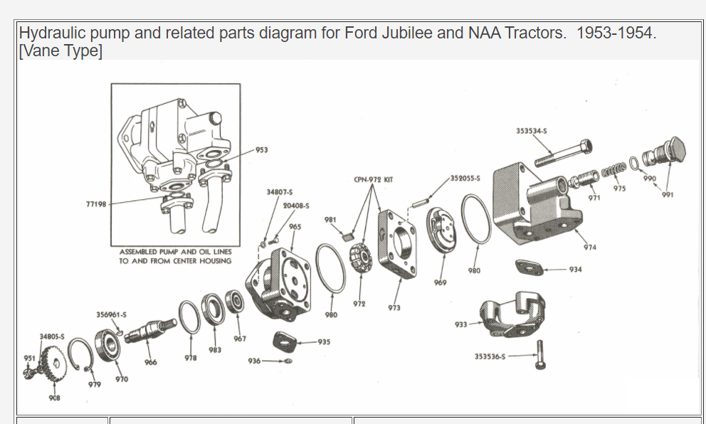

My NAA is leaking between the hydraulic pump and the flange at the bottom that holds the pressure and return lines. Before I remove the 3 bolts that hold that flange on, I would like to know what is in there. It appears to be one or two O rings.
Has anyone ever replaced those O rings? ARe they standard or must I get them from a Ford dealer?

I read your question and out of curiosity I did a little research. Here is what I found. The link is below followed by the diagram.
Good Luck
