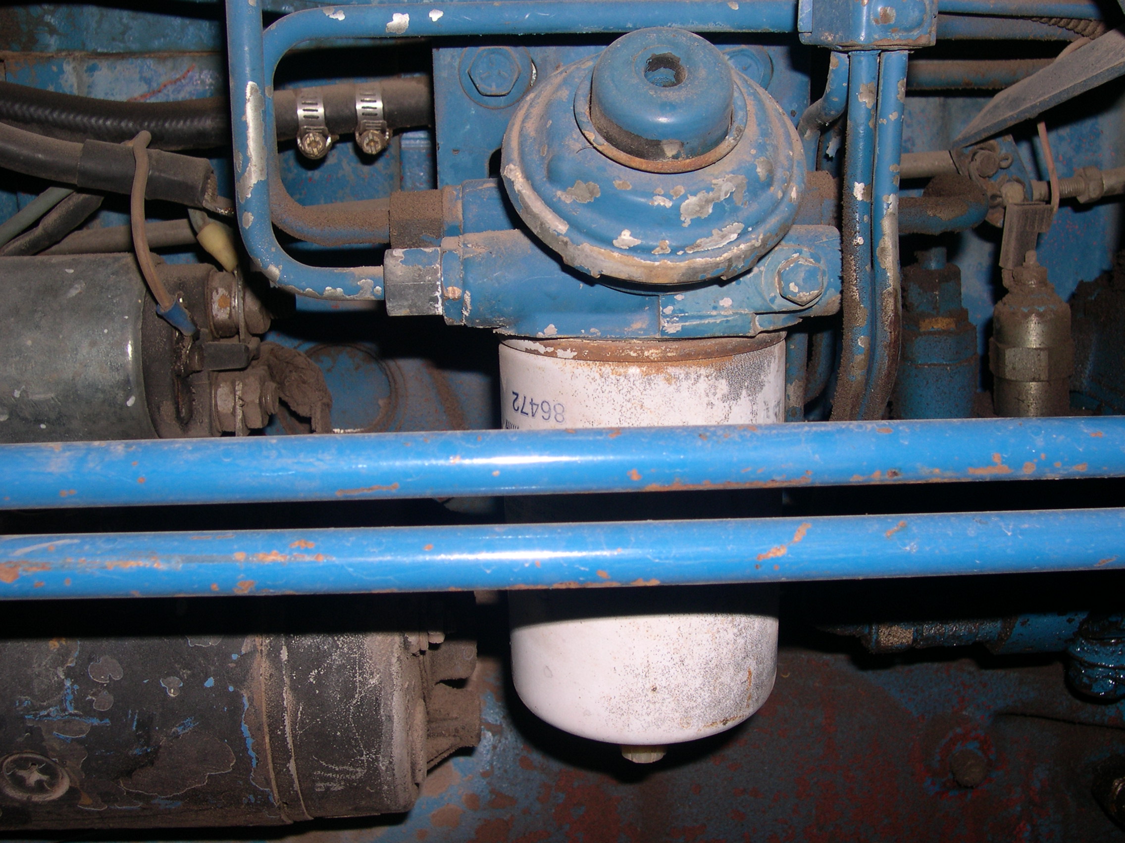

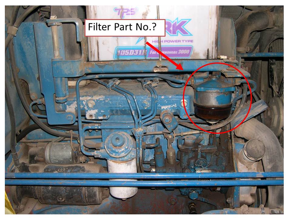

I am looking for diesel filter for Ford Newholland 6610S Egnine no.NA 462033, Tractor No. ZX350634 but I don't know part no. for these filter (Spin on + Fuel Filter)
If you know the correct part no. please advise? This engine is 5.0 L or not?
   / Ford Newholladn 6610S Diesel Filter Part No. #2
The water separator (circled in photo) has no replaceable element, just individual o-rings and seals exactly like those that come with the common CAV fuel filter New Holland 83937061. Disassemble, clean then reassemble. The spin on fuel filter below the manual primer pump is New Holland 86555246.
