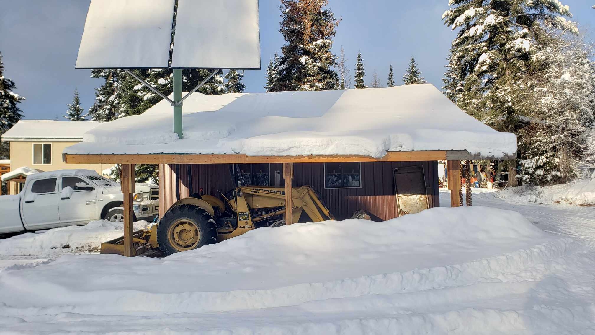

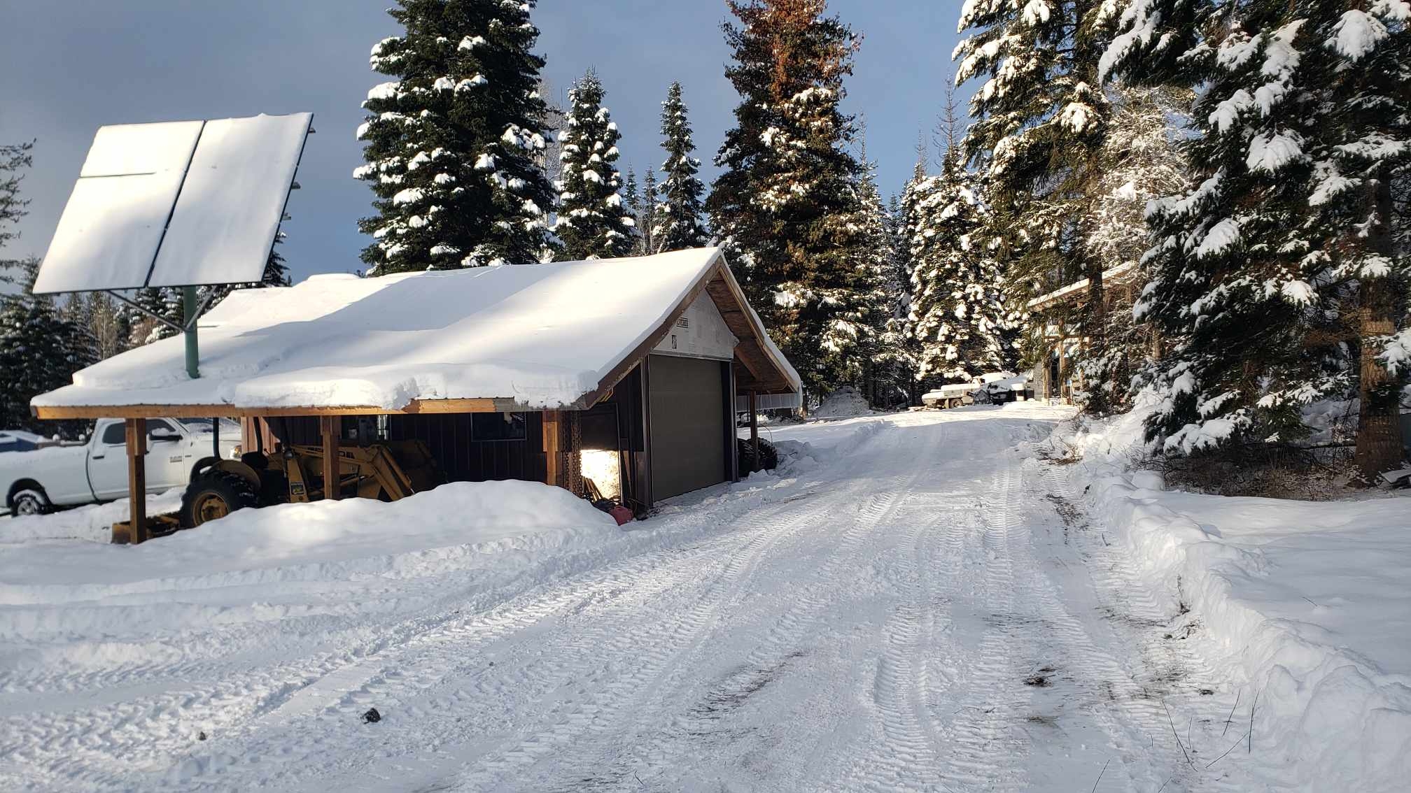

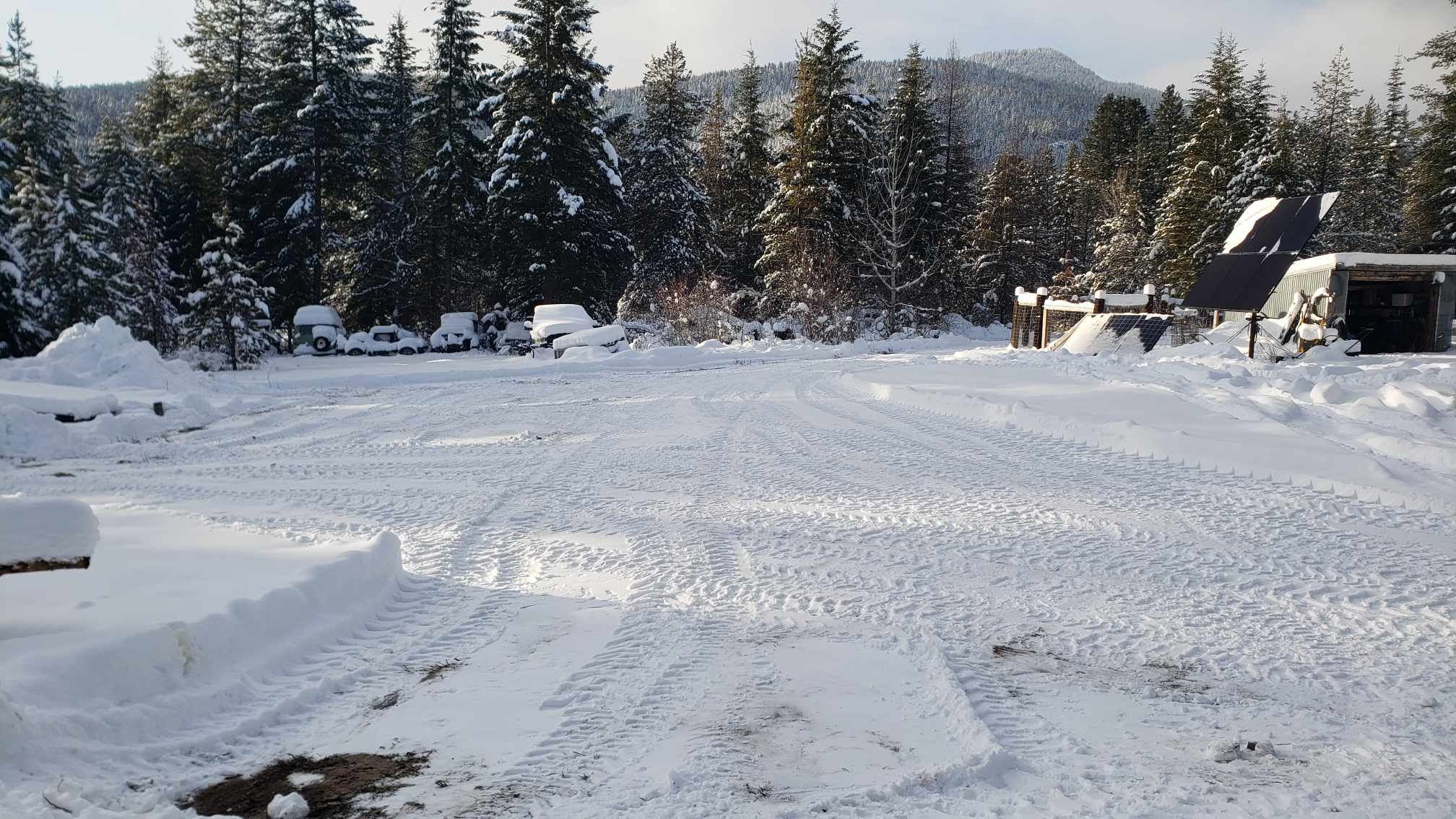

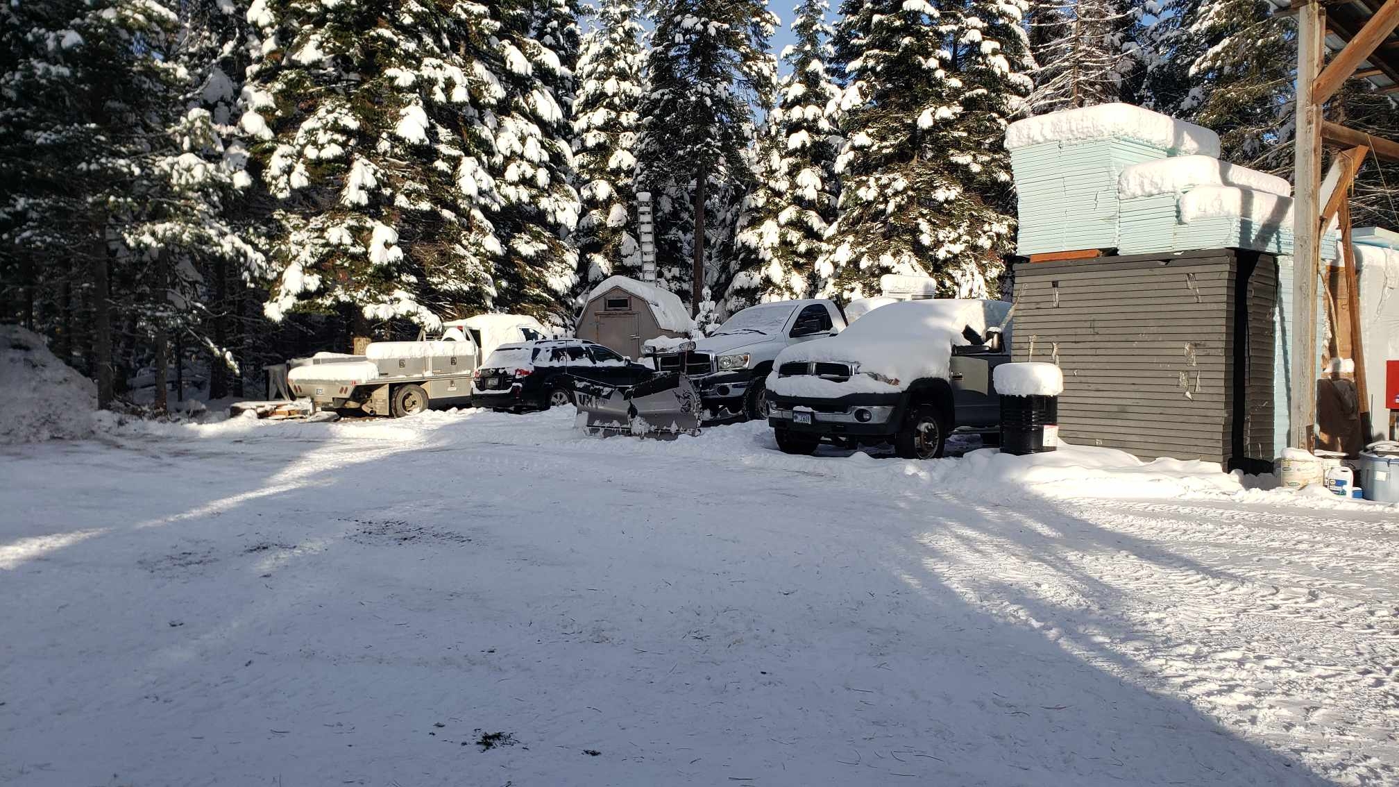

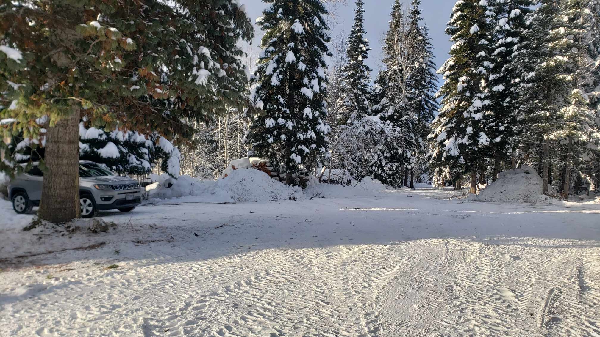

Here are a few pics of my place after I used the tractor to plow today.
