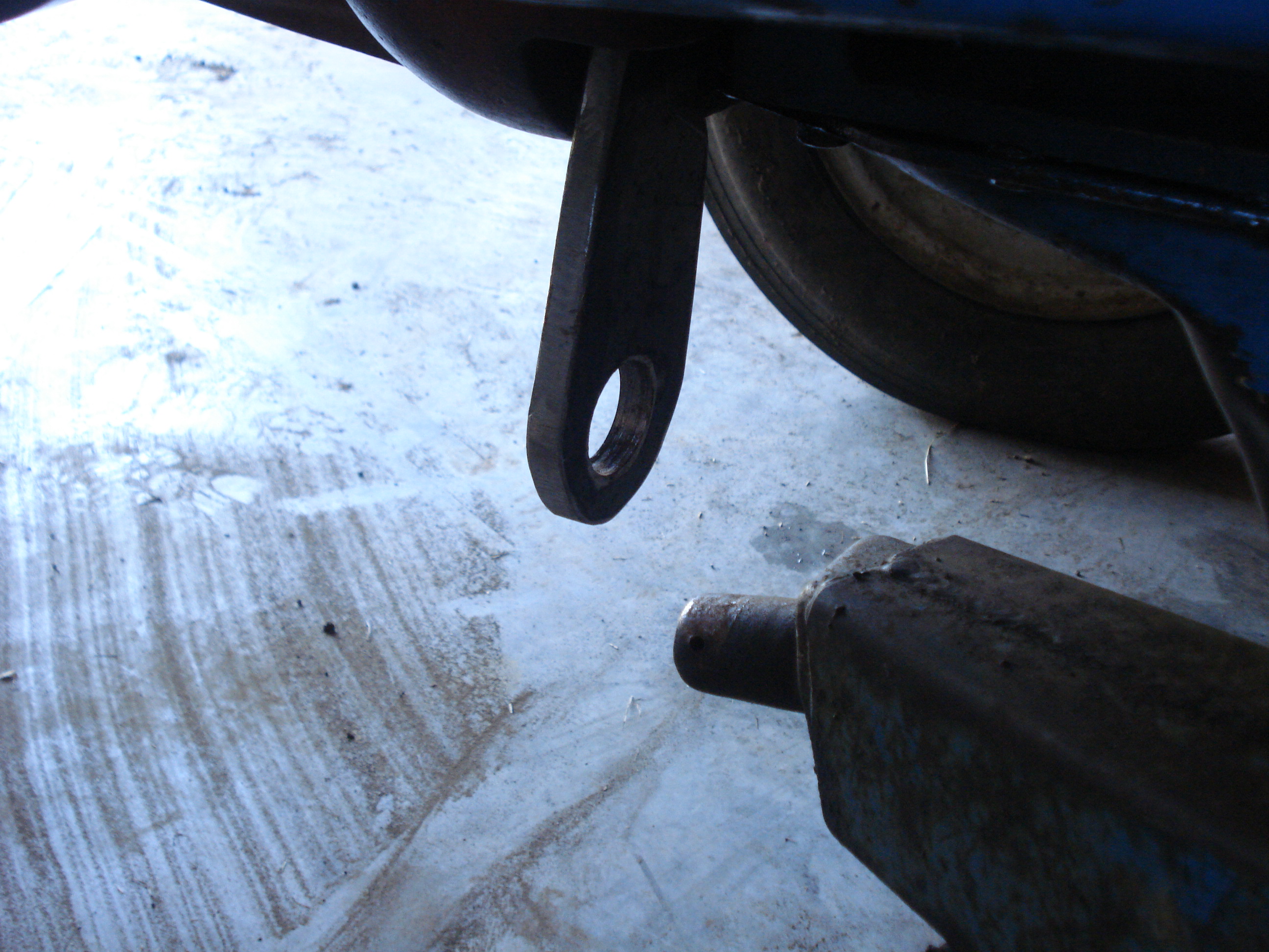

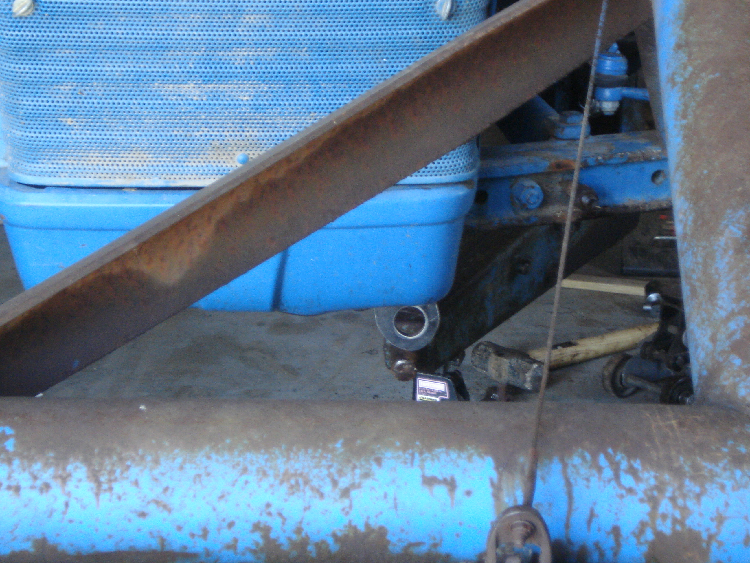

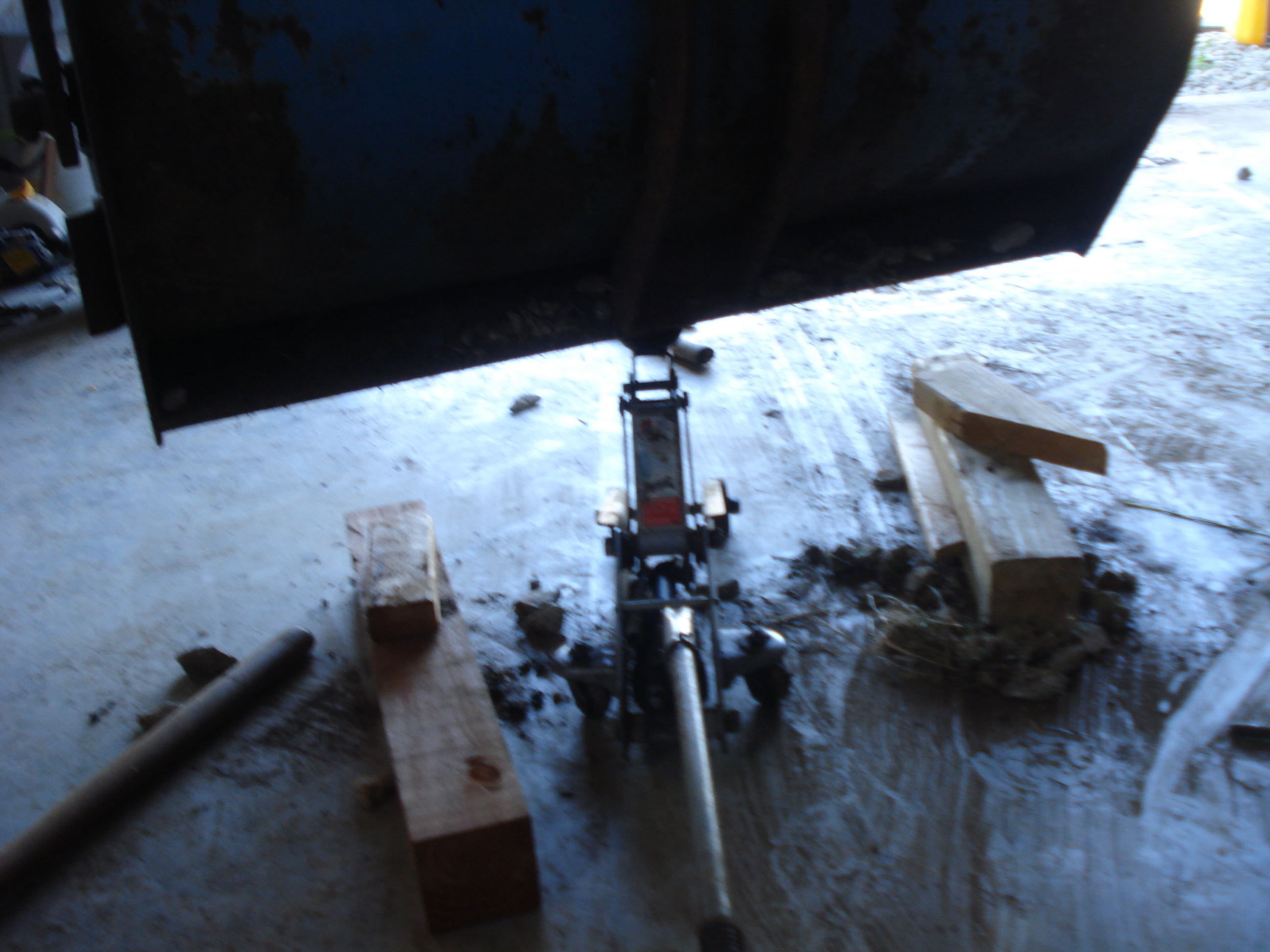

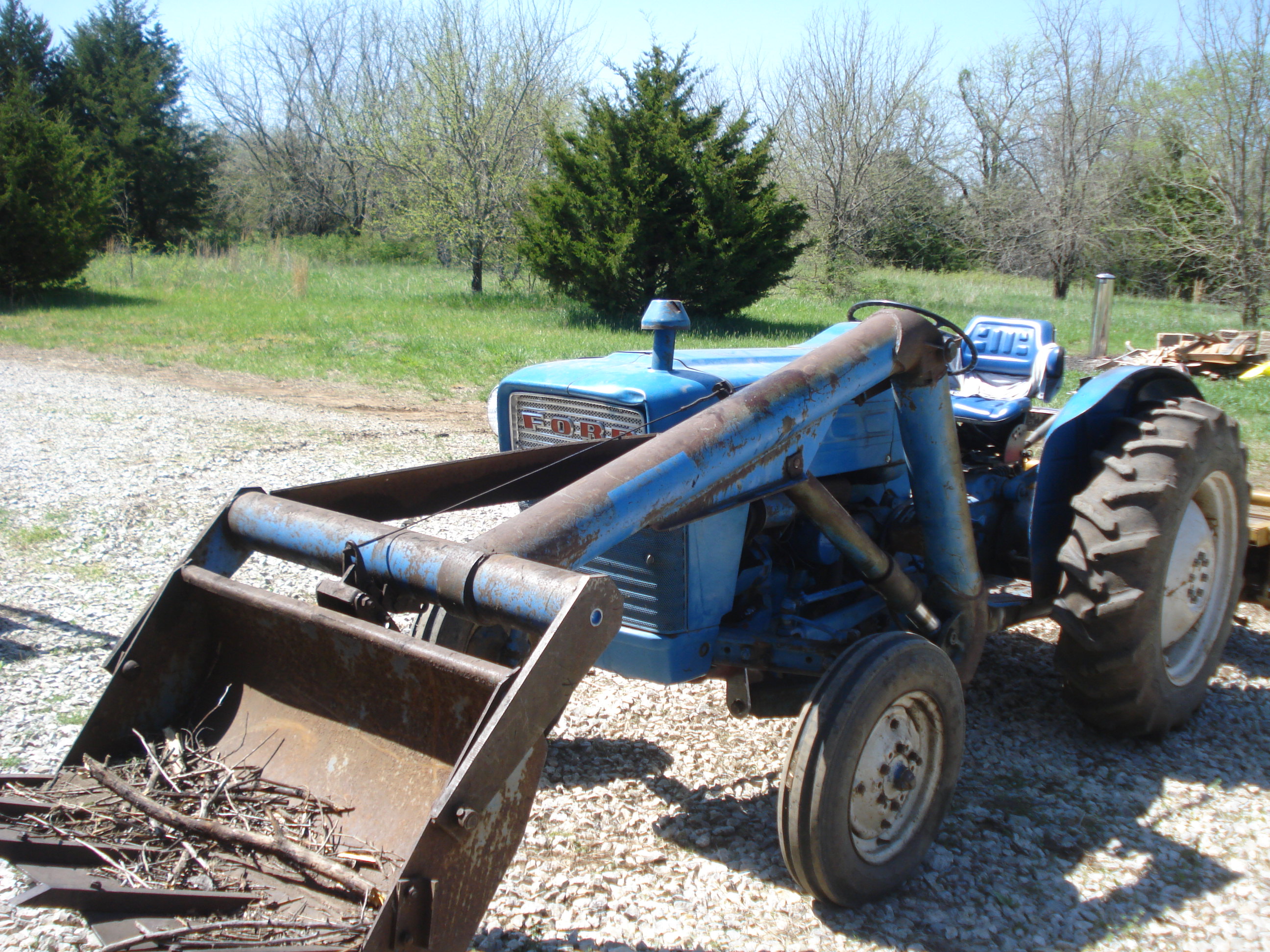

Here are some photos. I had a bit of a problem getting it on the tractor, didn't think it was going to fit. The hole in the front bracket, which I made, probably should have been 1 3/4 instead of 11/2 so that it would have had more room to angle into place. I had to lift the front loader with a floor jack after getting the hip bracket mounted and then that raised the front piece and by loosening the front bracket bolts I was able to get it together. I just could not get the front bracket done first. More floor jacks or some little dollies from Harbor Freight. Here's some photos showing the progression.
loader front bracket low.jpglow and short bracket.jpgraised bucket for fit.jpgloader on tractor.jpg
