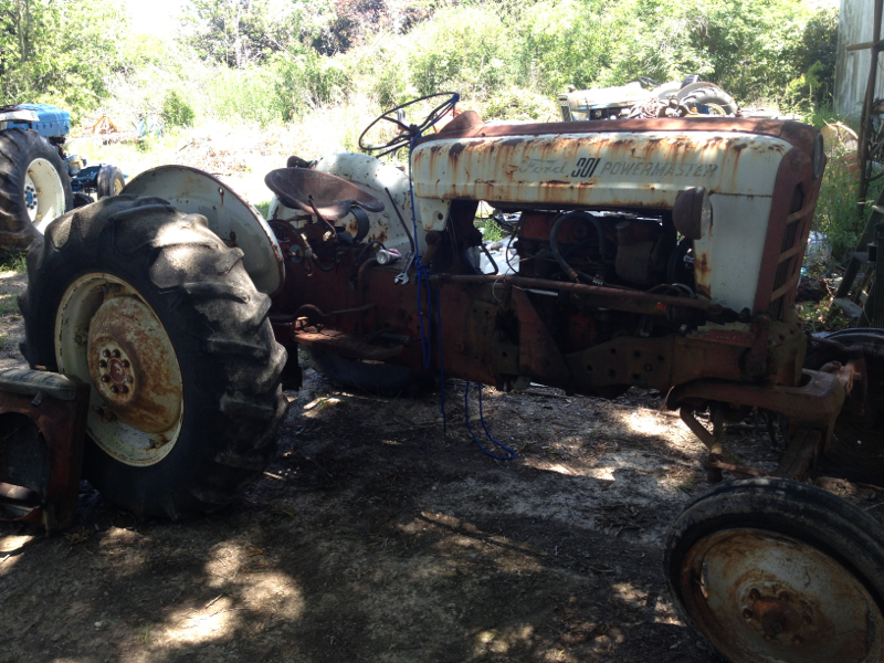

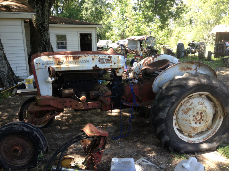

Went to one of my buddy's yesterday to pickup a few parts and in his driveway he has a wide frontend row crop. He doesn't know the motor condition or the condition of the rest of the tractor, he says it has the Sherman step up/step down trans in it. So what's the thing worth?
   / Ford row crop #2
well, lets see.. it's a 941 with a sherman combo probbaly.. and it's still on a genny.
I see a ps pump and cyl. I also see a missing manifold and carb, ad air cleaner and battery box.
tires are rough.
at this point.. I'd say it's a 500$ machine.
at a minimum you will be dumping 500$ into it just to get the hard parts minus tires to even make it crank and run.
rears might be serviceable if aired...woops .. scratch that. right rear is ok.. left rear has popped a bead. that's a dead tire.
down here in fl.. 2 fronts and a rear is gonna set you back 600$ them front rims look rouch.. may not be salvagable. new fronts will set you back 150$ used.. a lil less..
it has no headlamps.. just dinged shells... if power steering is bad. .. just pull it.. will cost you mor e than it's worth to fix.
so far on retally.. IF her engine runs as is... and you just put tires and them parts on her.. you will have 1100-1300$ in her. no guess onthe power steering.. though you could jus strip it off nd the wheels will still turn with a home made draglink.
that's getting close tot 'totaling' her value wise :)
I've bought rowcrops inthe 1500$ range and had them running for 2000$ etc.
if it's a tinker project and he has plenty of the spare parts and used tires laying around and he didn't pay much for the carcas and she does run. you might get a buck or 2 profit out of her .
If you restored her to show room quality I can see sinking 4000$ into her easilly... and she woon't be worth that.
on the plus side. for scrapping her out.
you have a 400$ trans.
you have a 200-700$ sherman...
you have a 150-250$ rear end.
you have a 100-150$ single sector rowcrop steering box
you got maybee 350$ of tins
you got 150$ of rear rims and center... if they were oe power adjust.. a lil more...
block? depends..
front setting bolster and pedistal.. maybee 150-250$.. depends.
hyds section and pump 250$.. has a valve on it.. might be ok.. looks rusty..
depending on the 3pt hitch parts inthe rear.. might have 100-250$ worth of sought after rowcrop 3pt stuff.. hangers and such..
   / Ford row crop
I forgot to mention its a diesel and he has all the parts that's not on there, intake manifold, exhaust manifold, air intake pipe and battery box. He started stripping her to part out, yes the left rear is shot and so is the fronts. I think I'm gunna pay what he is asking for it, he also has a running 851 diesel for 1200

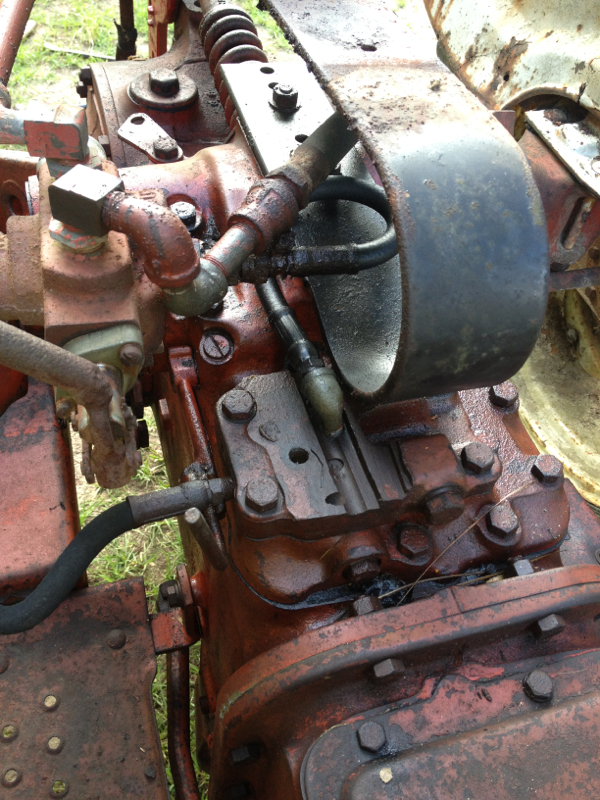

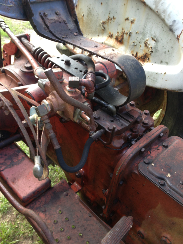

This tractor has external remotes but looks as if someone machined down the block and and tapped and added another valve?
   / Ford row crop #8
wow... instad of a PB plate and putting under the blank cover.. they boogered it up good. :)
